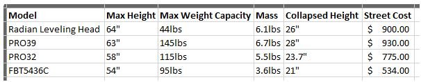

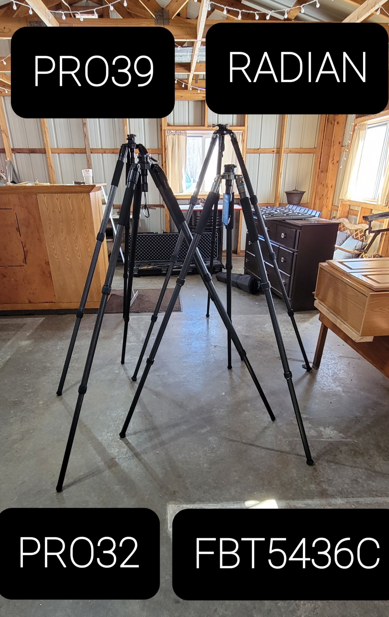

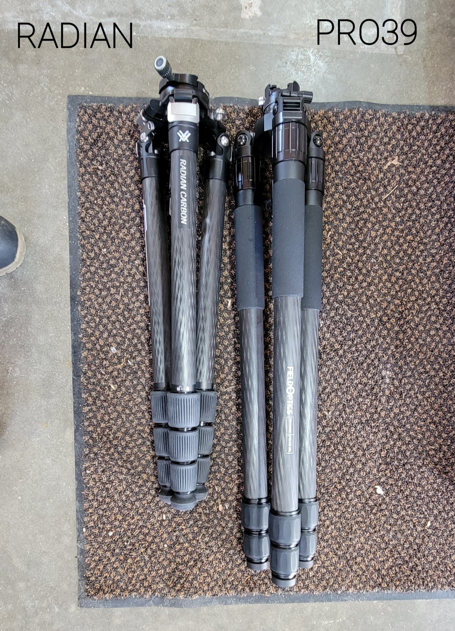

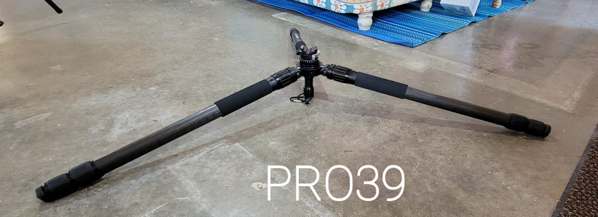

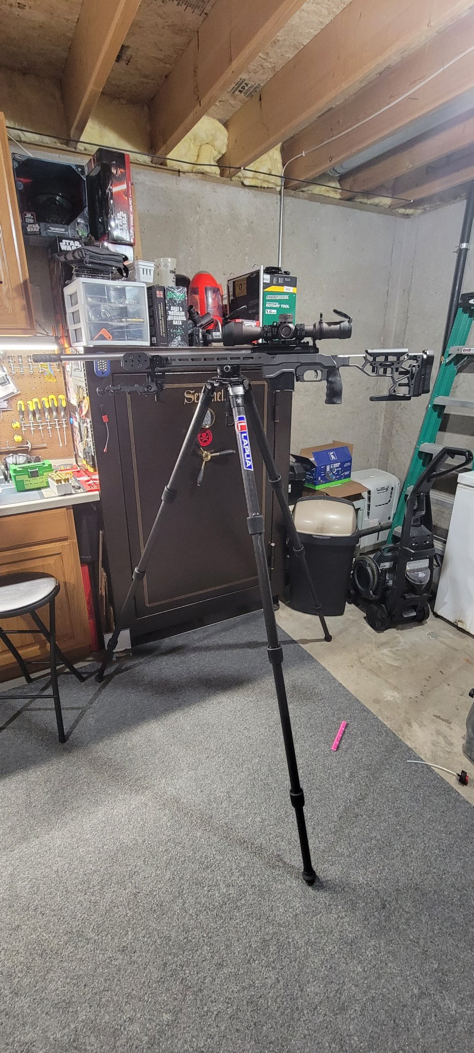

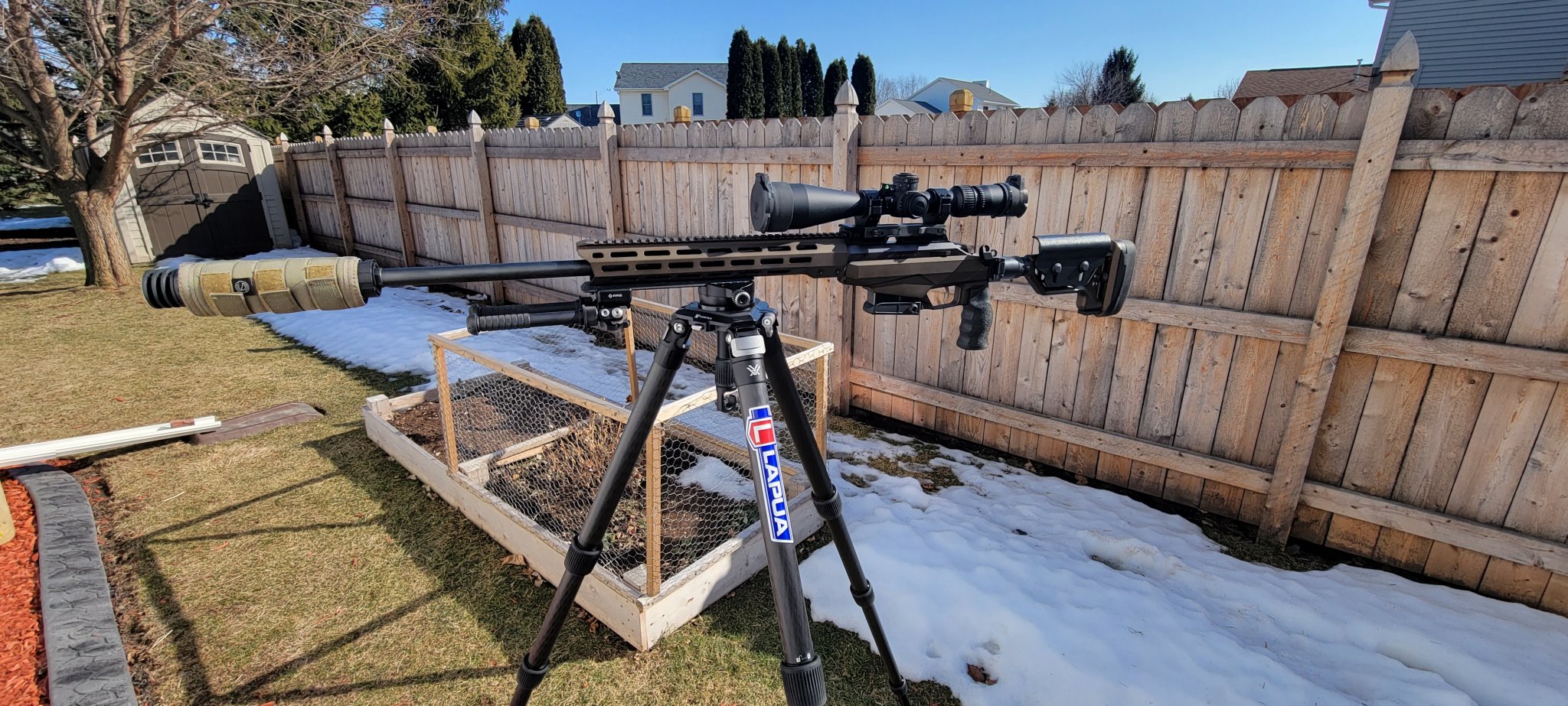

I don’t have a comparison with RRS (because I can't afford one anyways) but I can compare to 3 of Field Optics Research tripods. I am 6 weeks into using my Radian tripod with leveling head and also had the chance to play with 3 of Field Optics Research tripods for a day. I don’t want to ramble but just some quick observations of all 4.
Radian’s tensioner handle length is to long where it doesn’t allow the tripod’s legs to be at its widest and lowest angle (this only applies to the Radian with leveling head). Radian’s bowl is smooth but not as smooth as the Field Optic’s bowl. Radian’s bowl has no lubricant while the Field Optic’s tripods’ bowls have a clear lubricant applied. The Radian is also the tallest of the 4.
PRO39: This tripod is a beast. She’s easily the most sturdy of the 4 but she’s heavy and long when collapsed.
PRO32: Perfect compromise between all 4 I tested. Based on street value pricing this is the tripod I should of bought.
FBT5436C: Very compact and lightweight. Perfect for backpacking trips. The least sturdy of the 4 tripods so I am VERY surprised of its 95lbs weight rating (Vortex is 44lbs).
Cons of all Field Optics: The tensioner handle is short and its aluminum body is small so there’s less room to grab and twist. The Radian’s tensioner is much easier to grab and twist by far. The picatinny clamp on the Field Optics leveling heads may not work on all setups because the picatinny clamp is below the ARCA clamp and the ARCA’s jaws may interfere with wider handguards or chassis. To make it work I would need a spacer on my rifles’ picatinny rails. Hope this helps. Any questions please let me know.
