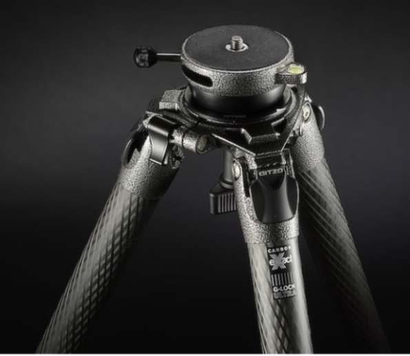

Ohh yes your right I did not think about the leveling factor. But I guess that's why they have these: https://www.gitzo.com/global/leveling-base-systematic-gslvls/
