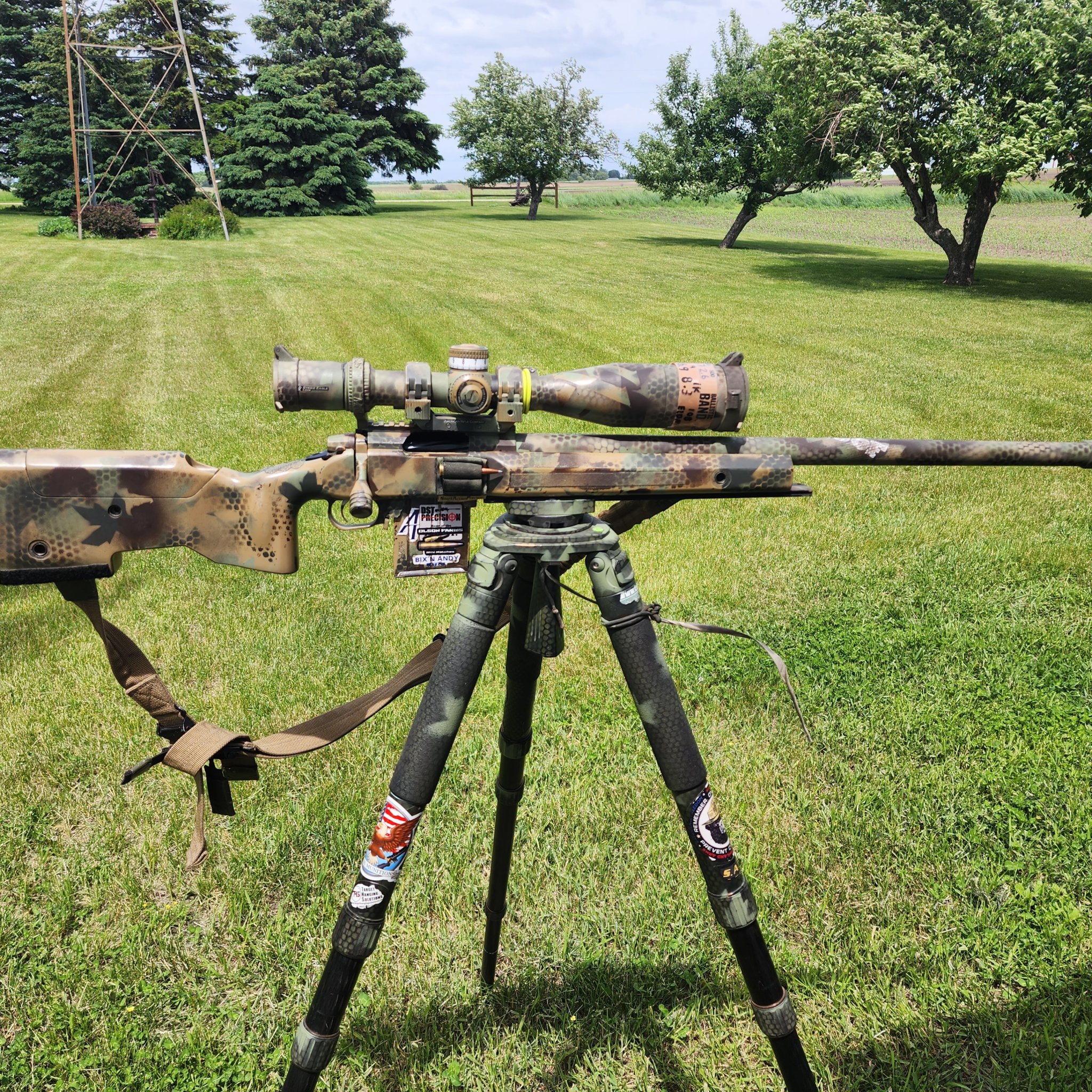

This is the innorel rt90 set up. I bought it second hand off a buddy that used it for 2+ years. I've used it for 2+ years. Swap out the bowl with something that has an arca clamp and you can put little arca plates on the bottom of your guns. I've shot off it out past 1k. Works just fine. No issues.
Yeah I wish I had zco and rrs money. But I shoot more and this works fine.

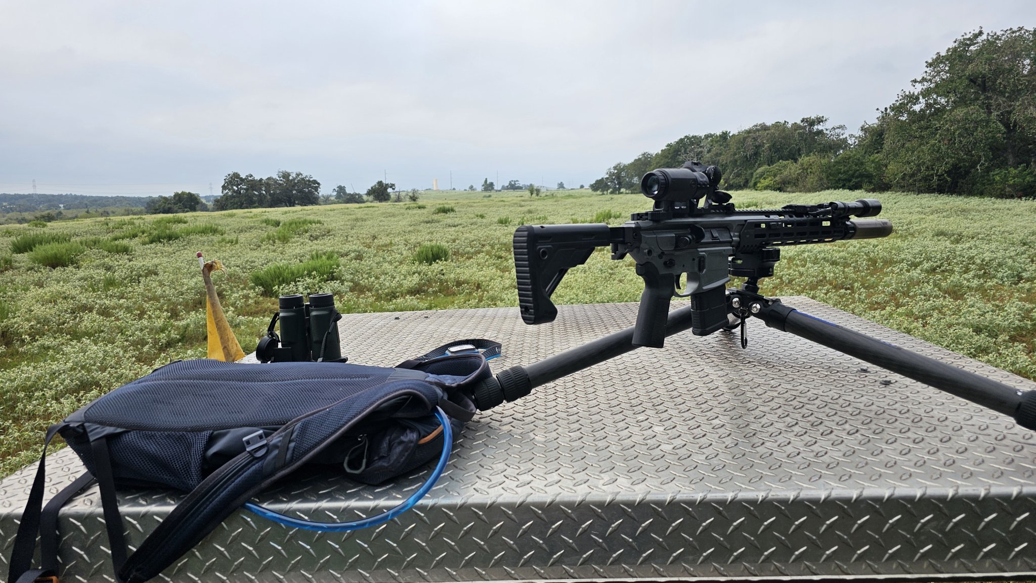

Just returned from the Competition Dynamics Steel Team Safari. Carried Mystery Ranch pack, JP .224 Valk, and the Innorel 90 with a RRS Anvil 30. Weight was not an issue. Waked about 3 miles+- each day for each course. Anvil 30 is ARCA. I like ARCA. My partner used similar but used Bog Pod clamp. Both setups performed better than the shooter. ZERO stability issues with either when shooting from the tripod. Are there lighter, higher quality tripods out there? Abosofreakinlutely! Does the Innorel with the RRS do the job? Absofreakinlutely! If you can add ARCA to your rig, I would highly advise it. Easier to clip in rifle, binos, spotting scope,etc. if you want a clamp, the Innorel will still perform. It’s a beast of a tripod. Little weighty, but rock solid. If you use it like I do, one or two matches a year, it’s money. If you are going to trek in the back country to hunt, or shoot more than a cpl matches a year, go high $$$ and invest in a Two Vets or a RRS.

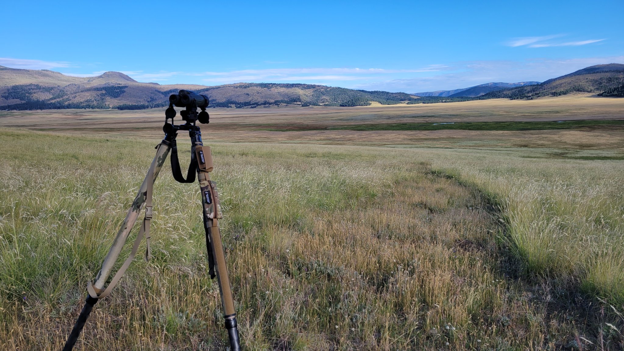

Those 2-piece invert, like RRS .. or the 2-Vets QDT V2 LS inverted .. I never really understood till last week when I actually put my hands on one with the rifle mounted just how rigid things get . I though the RT90c was really GTG, and I used Innorel carbon for long time out shooting dogs at night . The 2-Vets QDT V2 LS invert 2-piece was like a ROCK, and when you really concentrate the x-hairs out past 200 yrd. the superiority really stands out strong for upping your precision of shot placement.

Ya.. It really surprised me when I put hands on one out in field . I grabbing the Big tube invert 2-piece tripod, with physically trying to twist and flex when opened up to length. It's a Night/Day difference with rigidity-stability with rifle . I did not check-out the RRS one, this was the 2-vets model, but expect both to be similar rigid top quality . Innorel's served me well, but I 'will' be moving up and into a 2-piece leg invert's.
