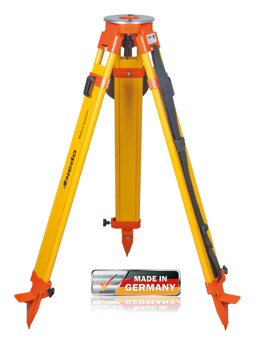

    I just worked through something similar. I am just beginning to learn to shoot from a tripod. I have 3 surveying tripods that I use professionally, so I figured I would try and make one of those work until I can afford a dedicated shooting tripod.
    I needed two things in order to mount a RRS Anvil 30 to my NEDO tripod. The first is a SECO part number 5182-002, which is an antenna adapter plate. It is a 3.5" disk that covers up the large opening in the tripod. It's actual use is to mount a GPS radio antenna to a tripod, but it works just fine for this as well. I had one of these already for my GPS equipment, but I wanted to see if I could find a fender washer that would fill the same role for cheaper, and was not able to locate one.
    The second is NEDO part number 061837, which converts from 5/8x11 to 3/8x16.
    I put the plate on top of the tripod, the thread converter on top of the plate, and my Anvil 30 on top of the thread converter. So far it seems to work fairly well from standing.
    For the tripod in the original post, the antenna plate likely would not be needed.
