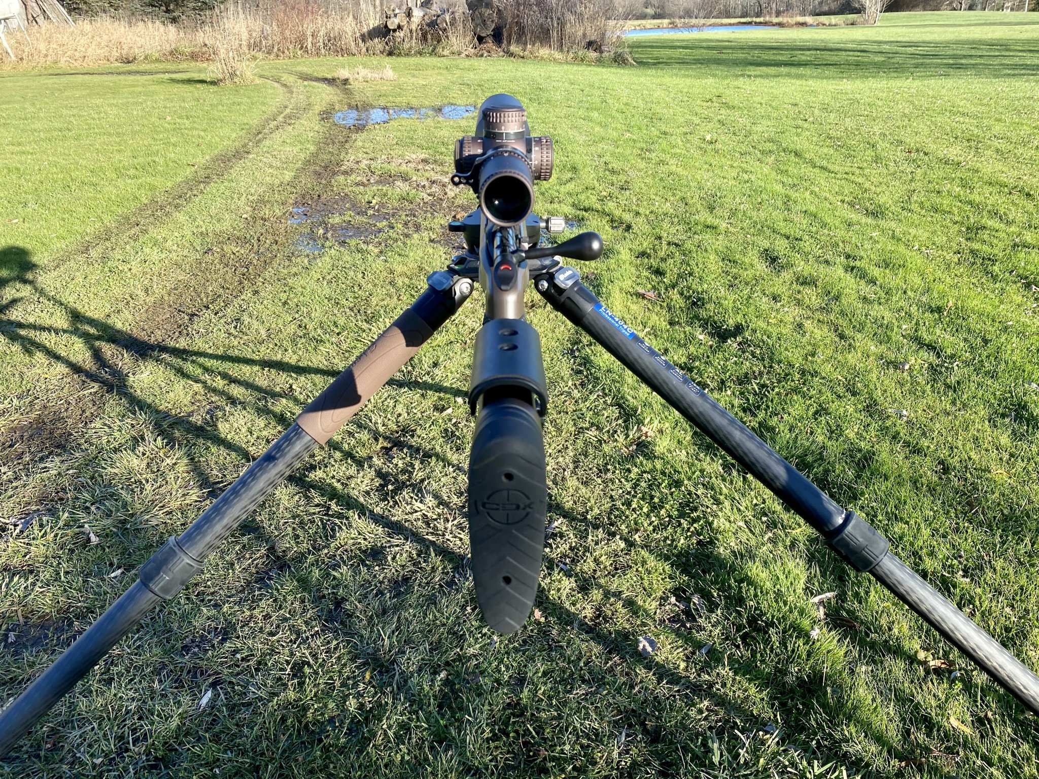

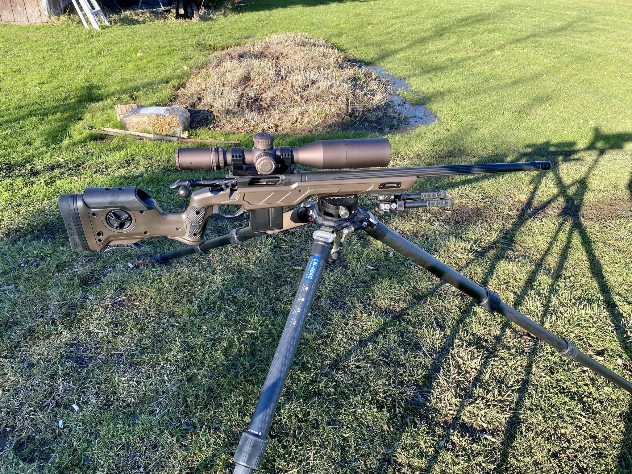

In setting up this rifle for tripod shooting, I did NOT want to use a ball head. In my opinion, this only adds cost and multiple adjustment points to the mix. From my photography experience, ball heads can also become “finicky” as they age, especially when used in an application they were never designed for (specifically, the shock load of firearm recoil). The other problem is that a ball head has only about a 2” ARCA plate clamp length for attachment. Thus, shock load is distributed tangentially to a much smaller area, increasing the amount of force on equipment. Instead, I used a leveling base with an ARCA attachment plate. The leveling base is a 100 mm “half ball” that inserts into the tripod’s bowl (see pics). The ARCA plate accepts any length of ARCA adapter, but provides approximately 5” of clamp length for the mount. This worked perfectly with a MAGPUL 4 inch ARCA plate M-LOK adapter mounted on the rifle, distributing the shock load much lower and even with the mounting base of the tripod.

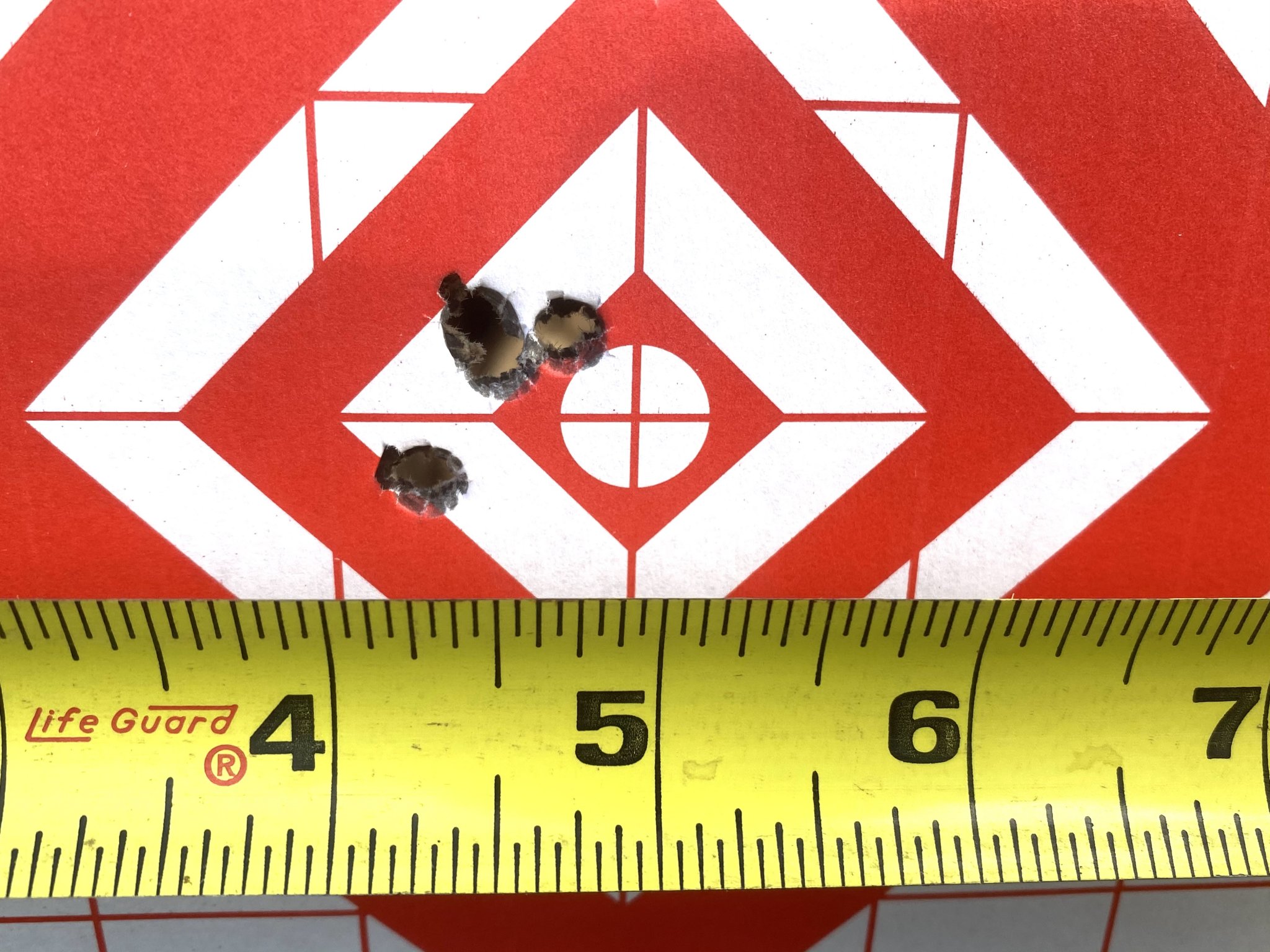

So, why did I need to do this? Answer: shooting from a tripod introduces “shake” (I’ve seen this in other people’s videos). I tried shooting from a variety of non-braced positions, but I could never eliminate reticle movement (I haven’t tried a hanging weight on the tripod yet, as some have suggested). The method I used DID eliminate almost all reticle movement and with a little practice I achieved the 5 shot group you see in the target picture (50 yards, 3 through the same holes). My next step will be to move to a local 100 yard range for more learning.
