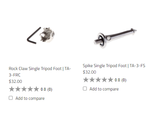

Yep these are what we have at the moment,
