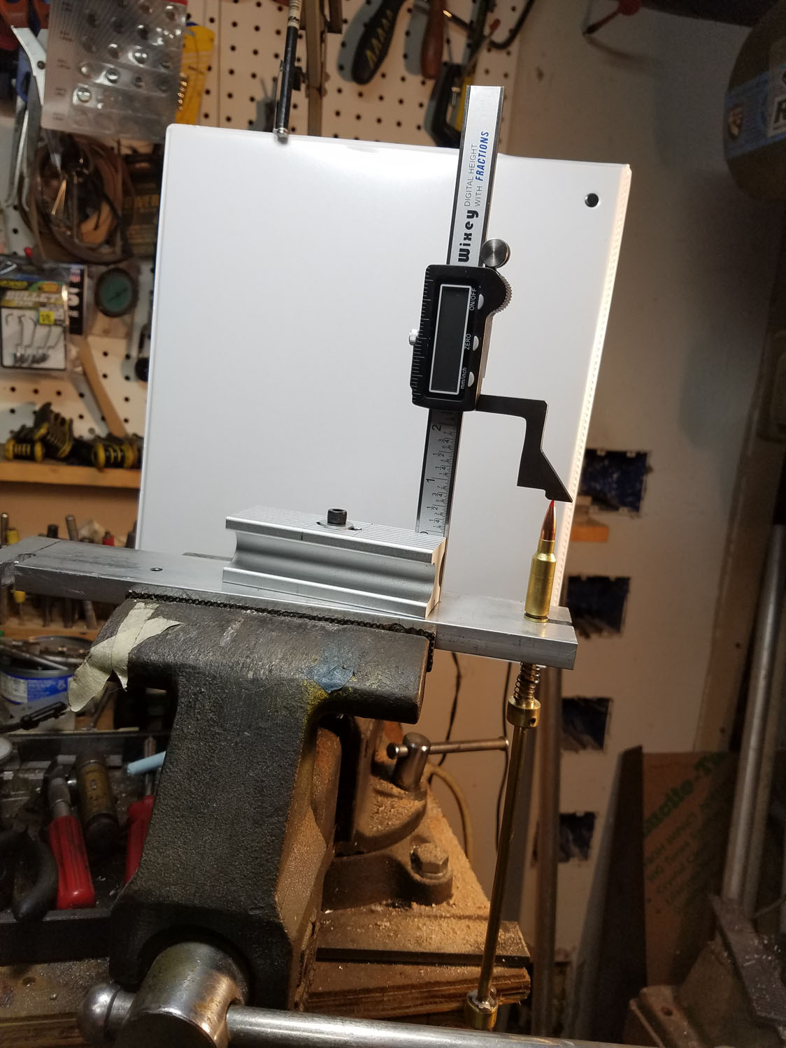

I used to use the wheeler method but it takes too long for me. Now I just diff the case base to shoulder datum measurement between the hornady modified case and a fireformed case and use that to add to the measurement. In all honestly it doesn't matter what the number is as long as you are using the same method every time. If I measure CBTO of 2.880" and do a seating depth test and find out that 2.860" is the sweet spot for the load. It does not matter if that is actually 10 thou off or 15 thou or 20 thou, as long as I use the same method to measure the distance to the lands then I can chase them accordingly.

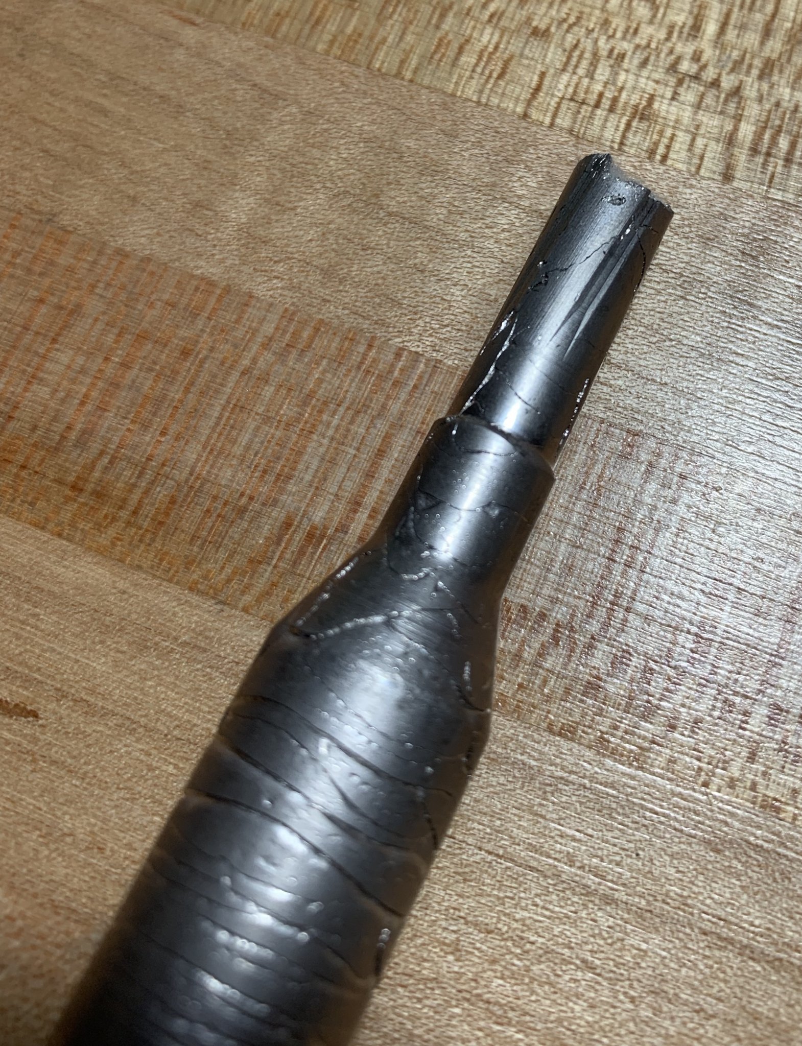

Am I the only one that actually does a casting of my chambers and uses that as my guide? Not like it really matters though: the tool or casting is well "close enough".
Ugly casting in this case (I didn't pre-heat the chamber) but dimensionally completely accurate.

Thought I’d jump in late to the game and speak to this method here. For awhile now I’ve dicked around with the Hornady tool. No longer will I punish myself with that frustration and inconsistency.
