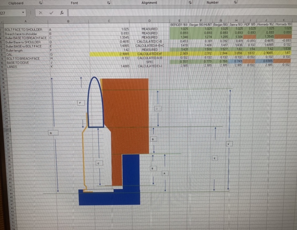

M#1. Measure back of bullet to barrel face. 1.0305
M#2. Measure barrel face to shoulder. .888
M#3. Measure Receiver face to bolt face. 1.0255 (with recoil lug in place if separate)
(M1-M2)+M3= Bolt face to back of bullet. 1.168
Use a comparator to get back of bullet to ogive. .653
Add that number and you have Bolt face to Ogive. 1.821
Or… use the 1.168 + bullet length 1.277 to get oal 2.445.
These numbers are from a barrel that’s about worn out so it’s prob a bit on the long side. You can call it the Dan method. All numbers no “feel”.

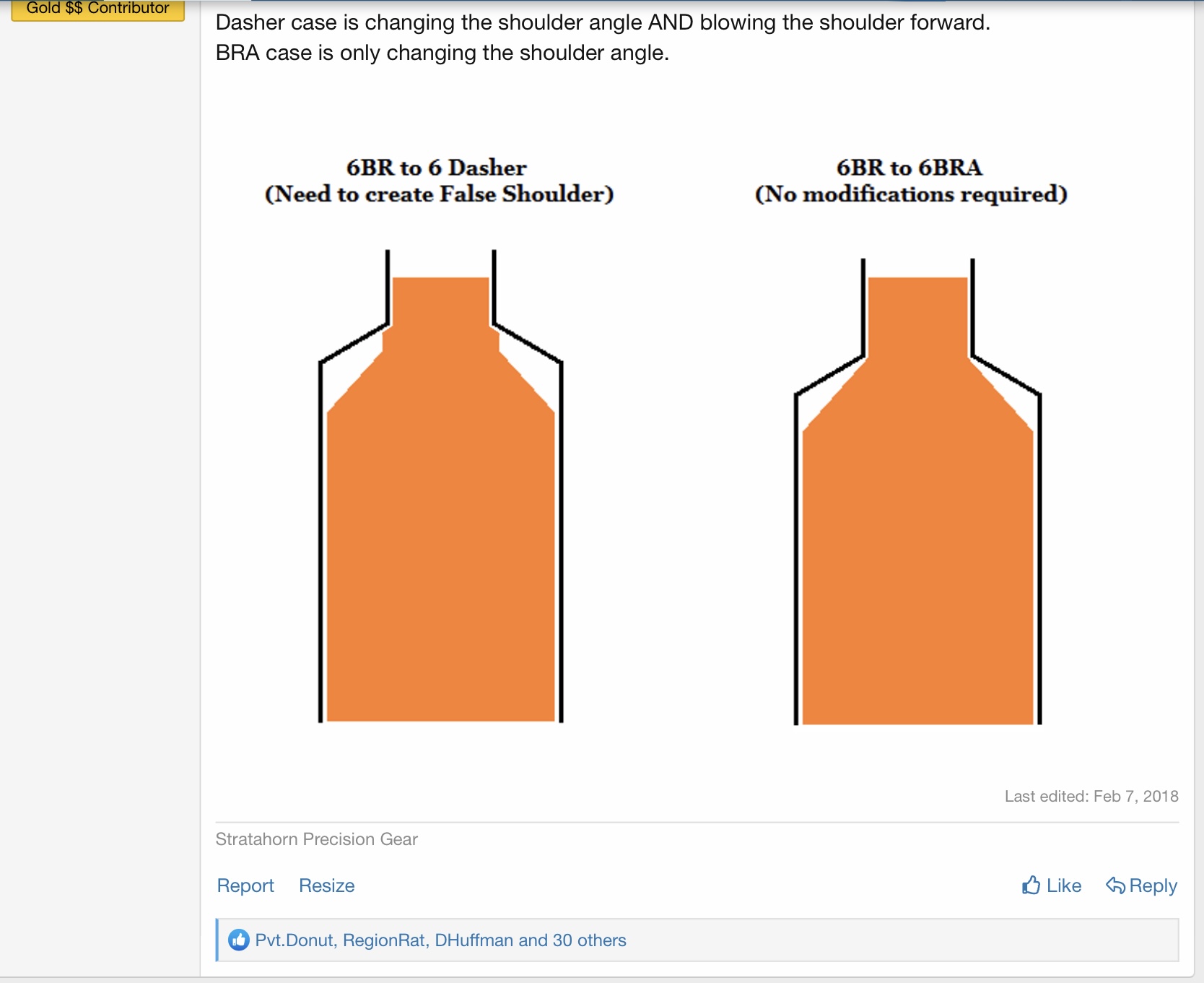

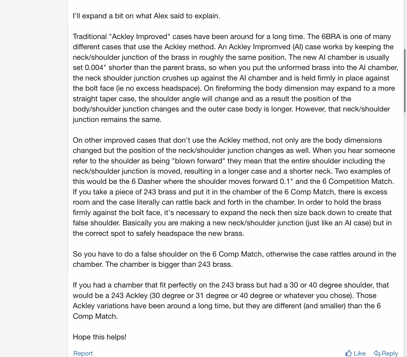

Here’s some good info and a drawing from our friends over at accurateshooter regarding the Ackely Improved process. Surely there’s a range of acceptable headspace dimension for BRA and if the previous owner/shooter was not having the same issue, it seems unlikely to be a chamber that needs to be re-cut. I’m certain of the headspace dimension in my Borden actioned BRA at it still occasionally fails to fire during fireforming with 450s.
