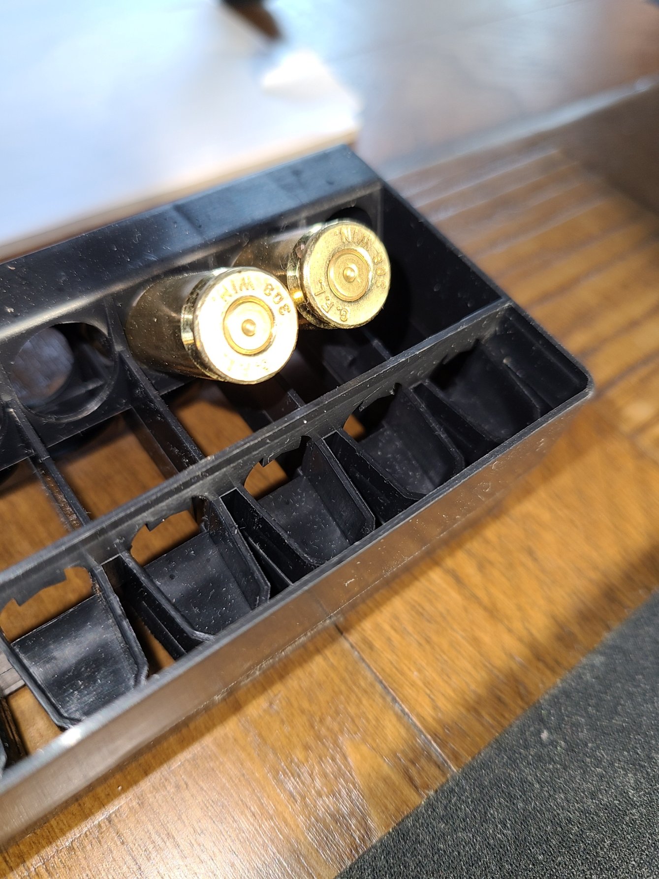

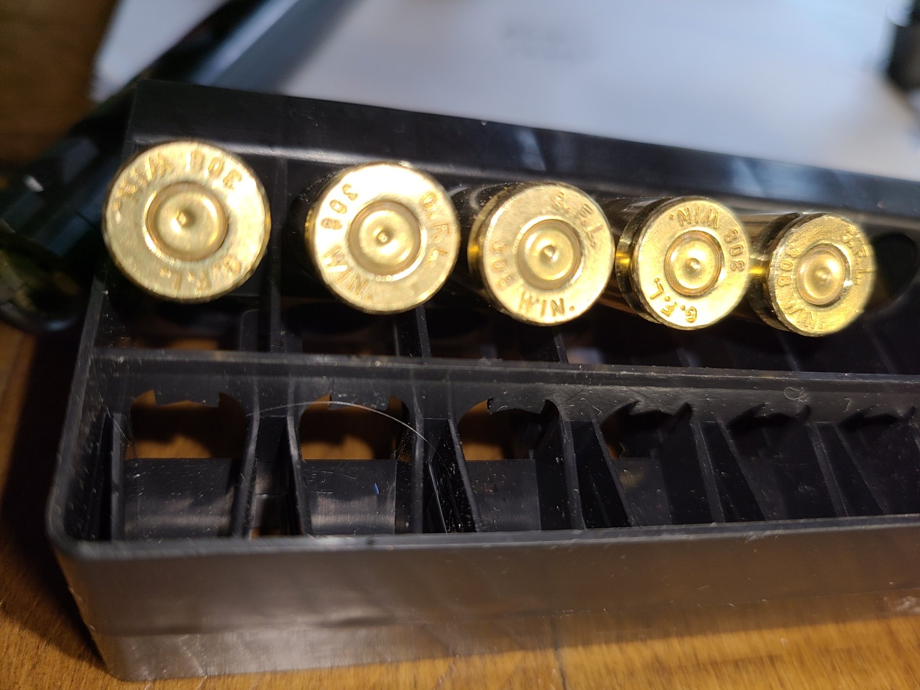

  • All FTFs show a strike, but it appears less crisp on the edges of the strike than those that do fire. Successfully spent rounds shown in picture of two casings. FTFs in picture of five rounds
  • Was able to get two of three of the last FTFs to fire on second try. Accurate as the normal rounds on target. Third that didn't fire on second try, shown in picture on the far right of five rounds, would not fire but clearly received a second strike.

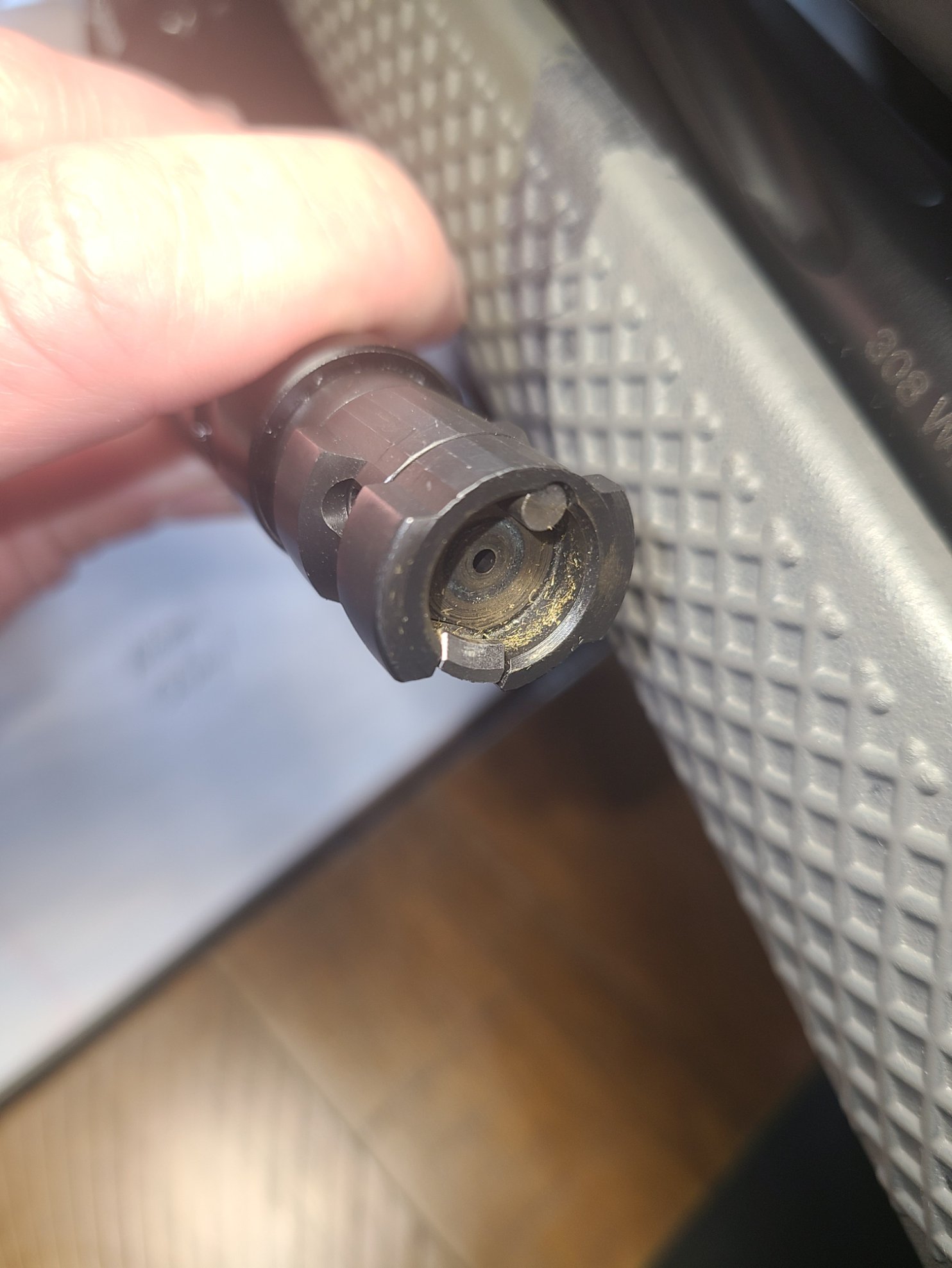

  • Bolt face shows some wear on the inside of the lip. Brass particles inside. (See pic)
  • There's also a bit of metal scrape/wear on the inside lip of the barrel where the casing sits. Don't know the name of this area and can't get a good picture.

Should've mentioned this in the original. I did disassemble the bolt and everything looks perfect. Even disassembled my .300 Seekins bolt to compare and there's nothing that stands out to me. Looks great.

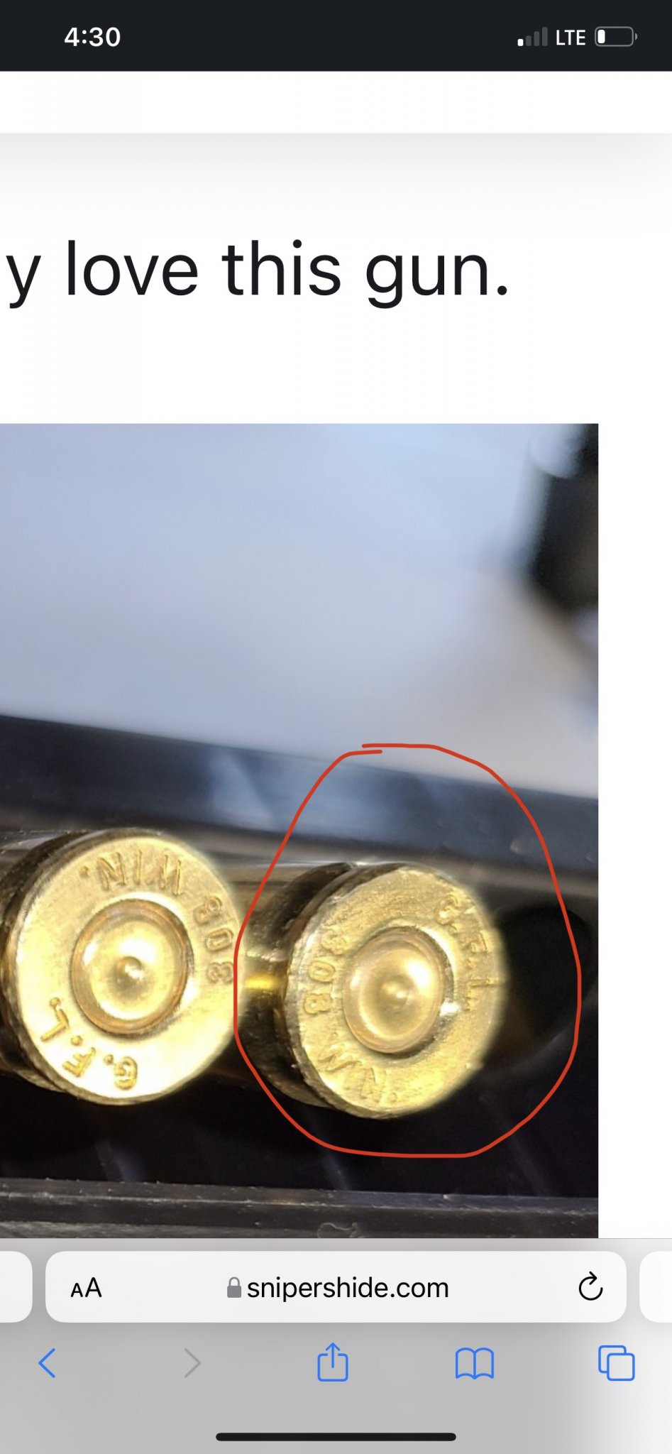

The one you've circled was fired twice. Two pin strikes, no bang.
