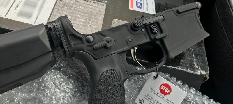

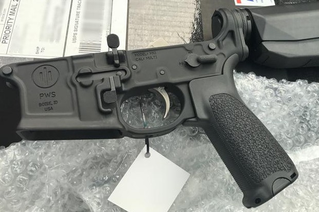

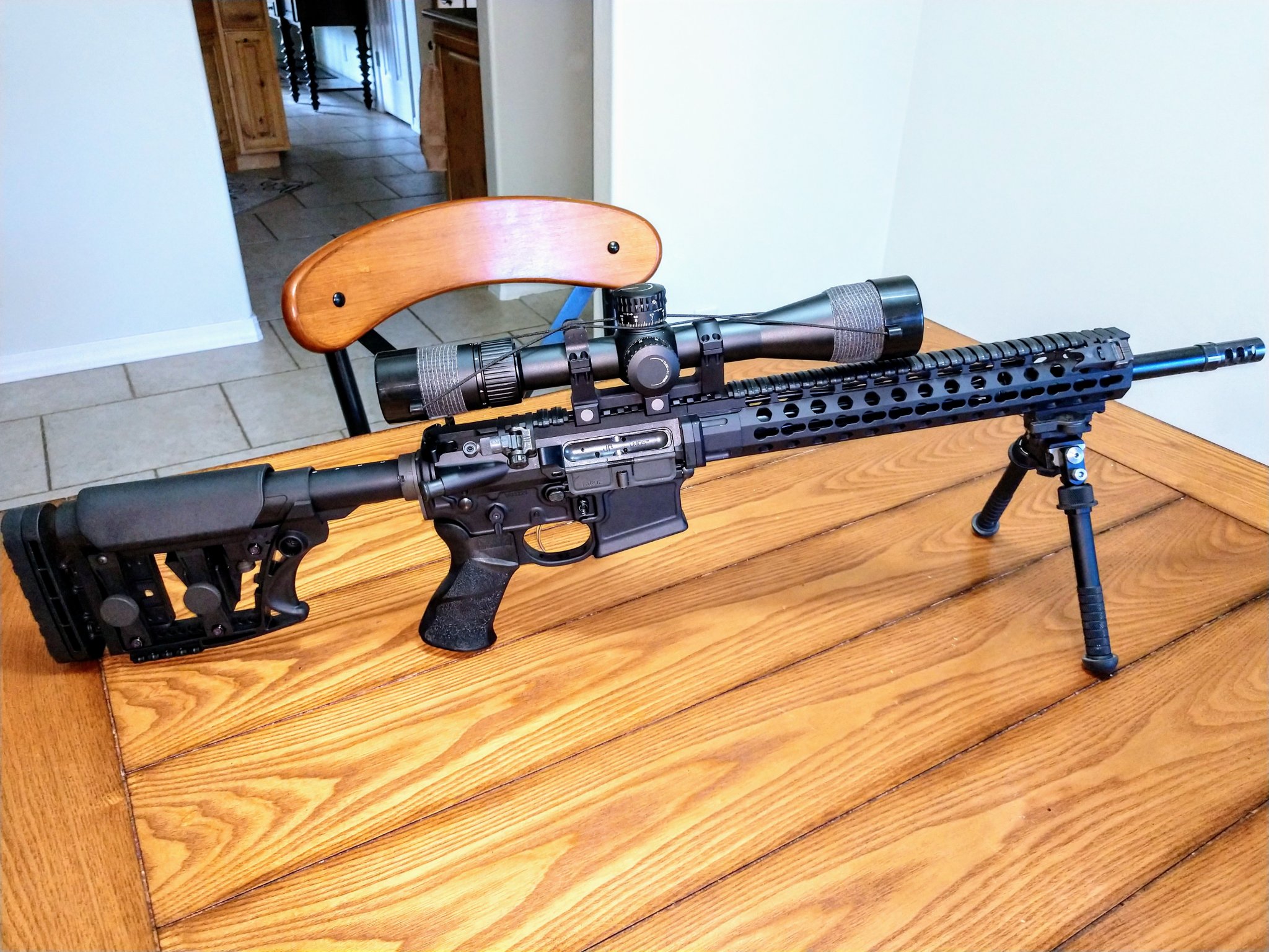

I've owned just about every true Ambi lower on the market, the KAC lowers are nice but nonetheless overrated and overpriced!!.
Pick up a PWS MK1 MOD2
The controls are identical to KAC, has tighter tolerances and a few extra features over knights. I think I paid $250 for each of my PWS stripped lowers. Here are a couple of pics that you can use for reference plus a pic of my Recce set up.

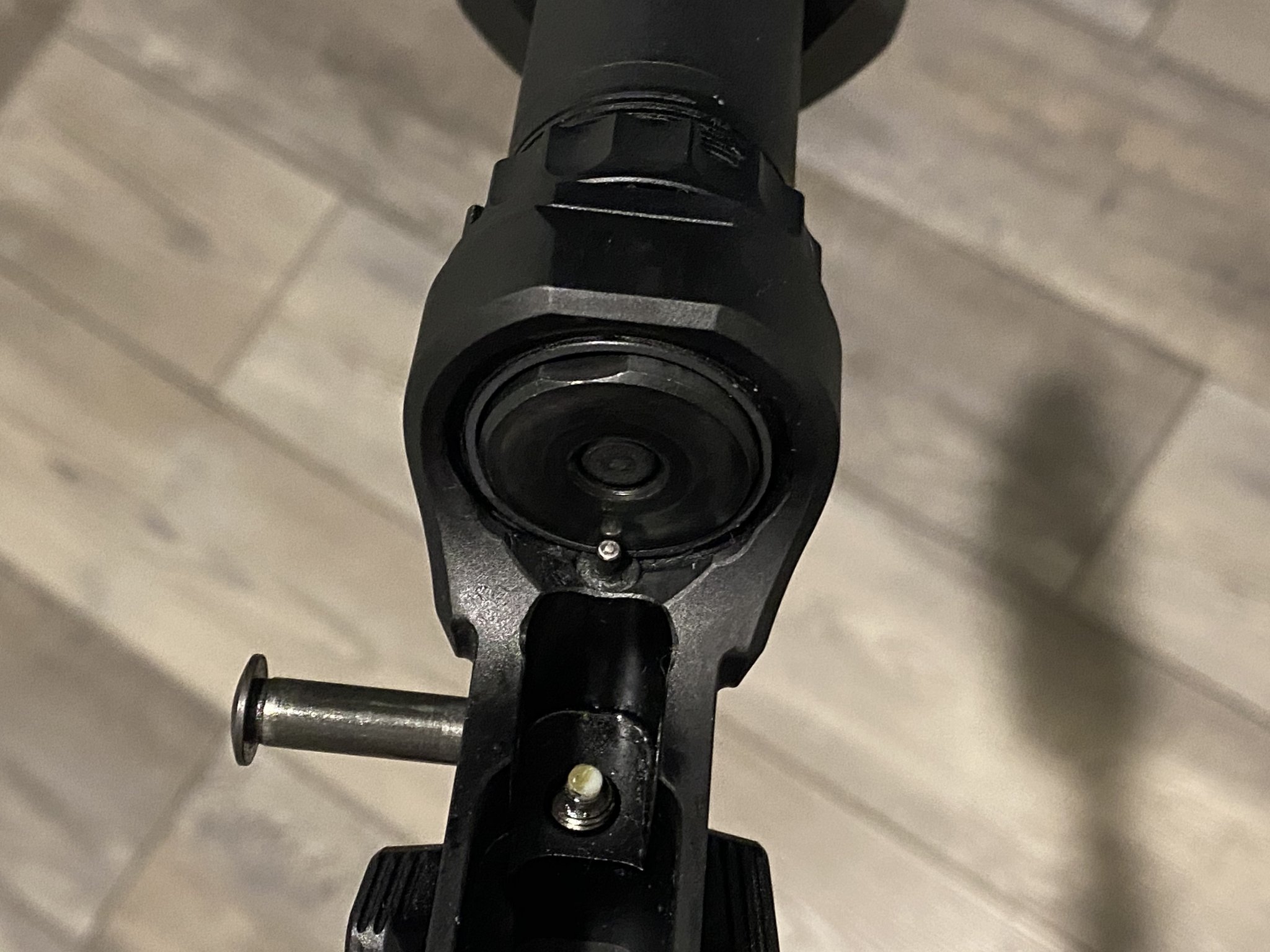

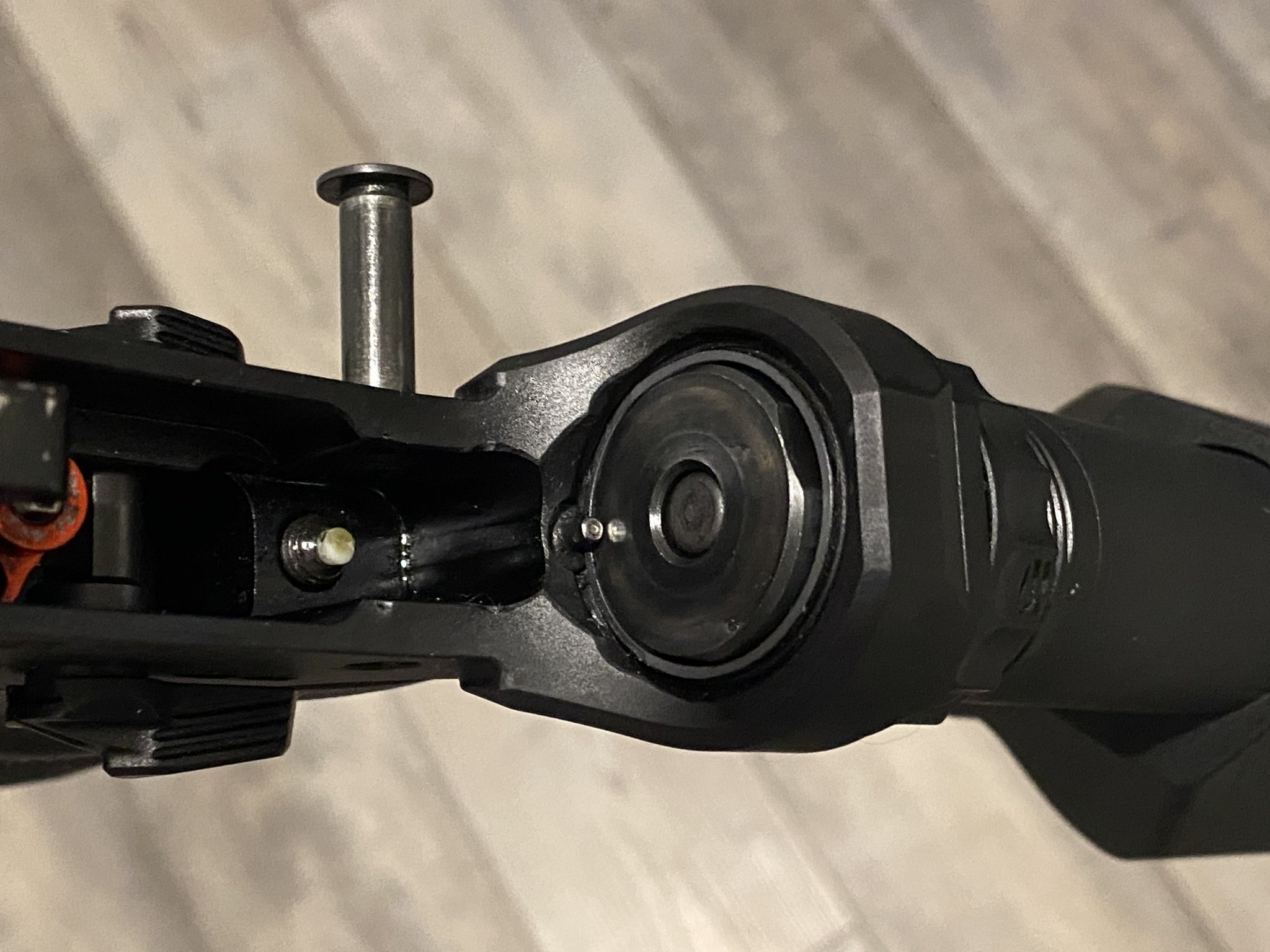

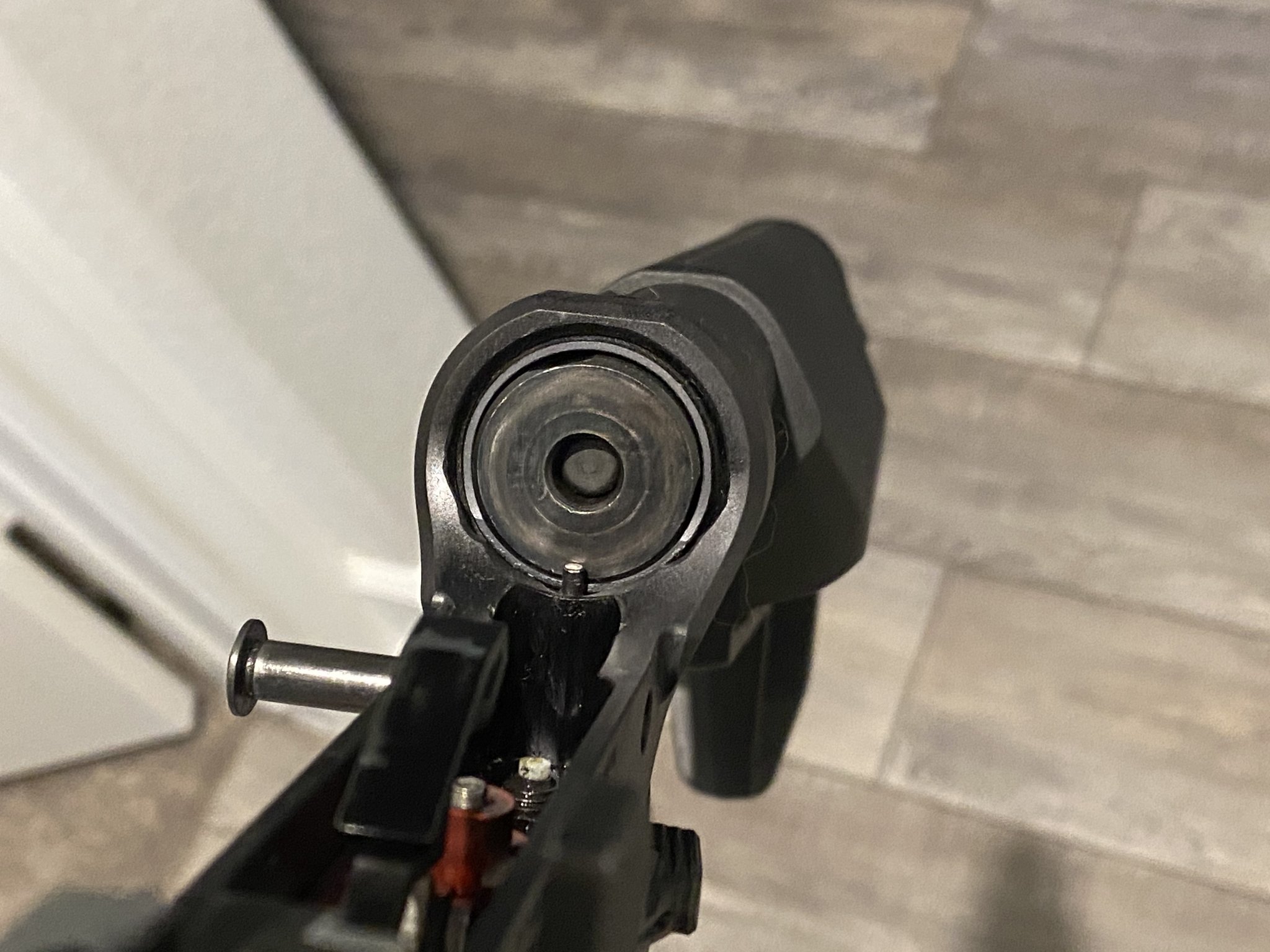

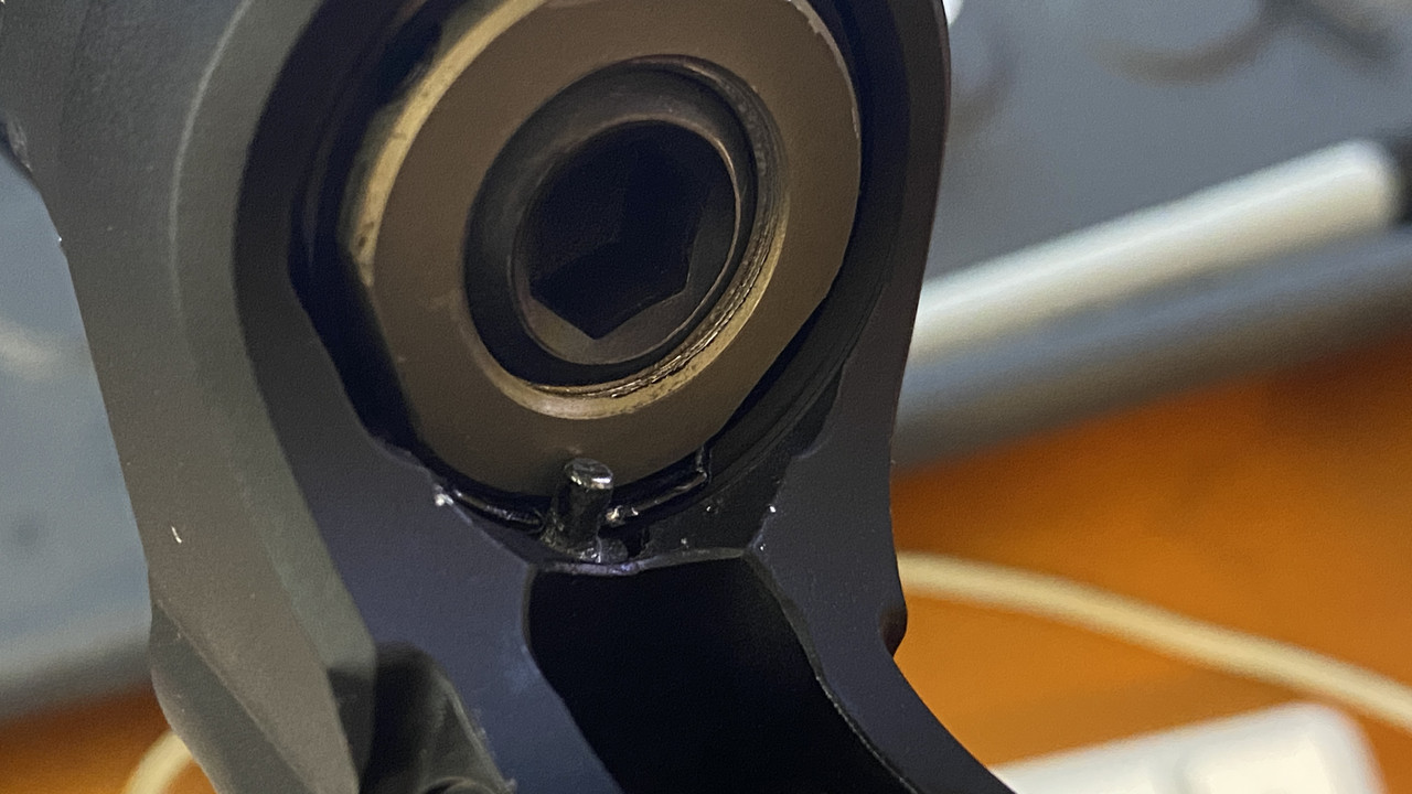

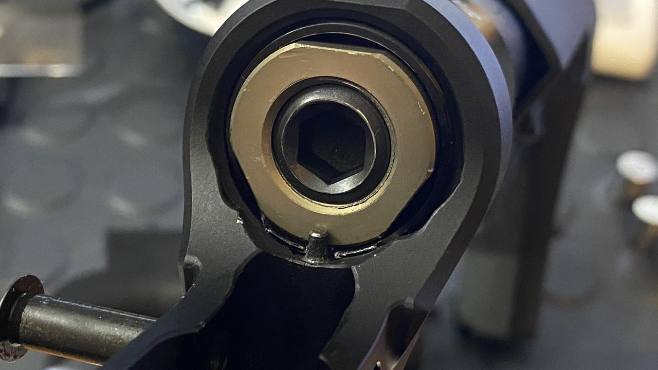

So I did a ton of research, went back and forth and just couldn't put my money down on the Radian given the weight and cost. Instead I went with ADM (American Defense Manufacturing). Well, it arrived today. Been using a run of the mill Del-Ton lower and wanted the ambidextrous controls and to move the Del-ton on to something else. It's performed flawless but hey, it's a mil-spec lower.
I excitedly assembled the ADM and then, prior to installing the grip, went to adjust the tension screw and found I could not draw the BCG back with the charge handle. I messed with it and adjusted it to the point where I could pull the charge handle back but in doing so, I could not lock the rear takedown pin in place.
Took the lower off and began to examine the machined area around the collar. Funky. It's uneven and not symmetric on both sides. I could see a very small nick where the BCG was hitting the lower. Have an email into ADM but IMO, this one never should have made it out the door.
I figure I can machine/grind it off but there goes future resale and I'll have a good chunk of exposed aluminum. WWSD?

I have three ADM lowers and counting so far, and haven't seen that yet.
Your BCG shouldn't be impacting that point at all. Something is definitely off, it should be sliding in where your buffer tube is, and that doesn't look obscured at all. Do you see a corresponding mark on the BCG? Maybe use some black sharpie on the back and see what area is impacting (you can wipe off with alcohol after).
ADM has great CS so you should have no issues with them helping out, but I'm not sure that's related to the lower. FWIW, I heavily preferred the ADM lowers over the Radians due to the bolt hold open/release being independent of the magazine release.

Just an update on my issues and full disclosure of my newbness. Turned out to be something I didn't spot with another component. I now have the ADM ambidextrous lower installed and it functions as it should. ADM got back to me first thing Monday morning bright and early and offered a few suggestions on what to check. Was caused by one of the roll pins in my damn charging handle. I seriously swapped parts between three different uppers/lowers trying to solve the issue until I spotted that little pin sticking up. What a pain.
The culprit:

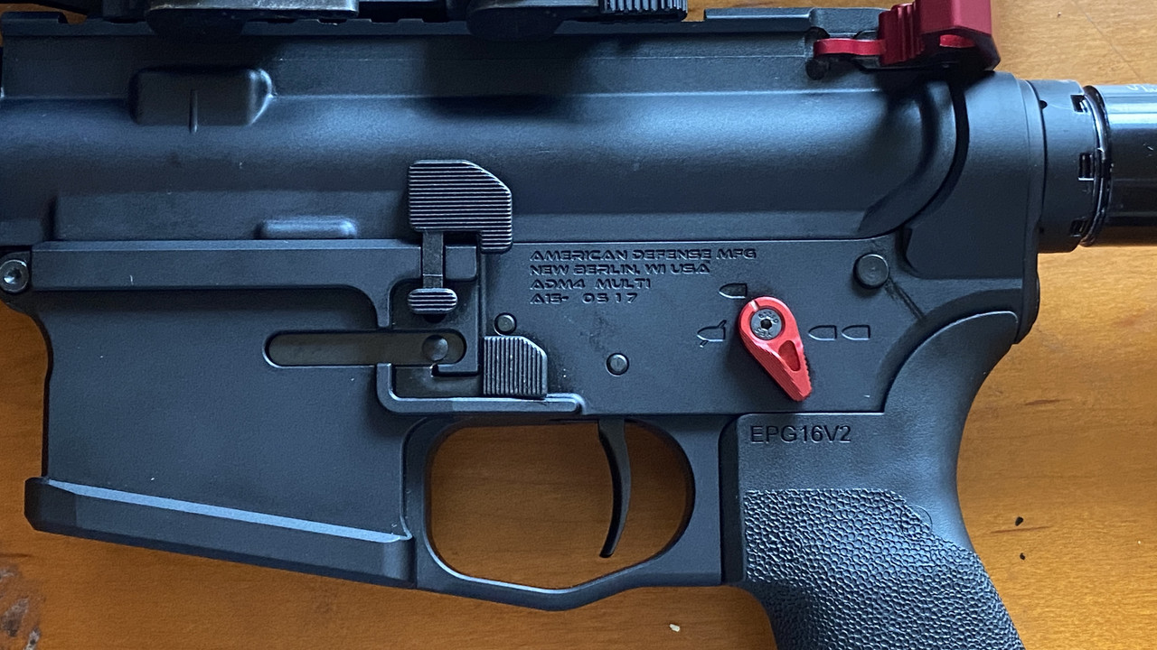

The results. I went for the plain Jane version as I have enough aesthetic clutter to begin with.

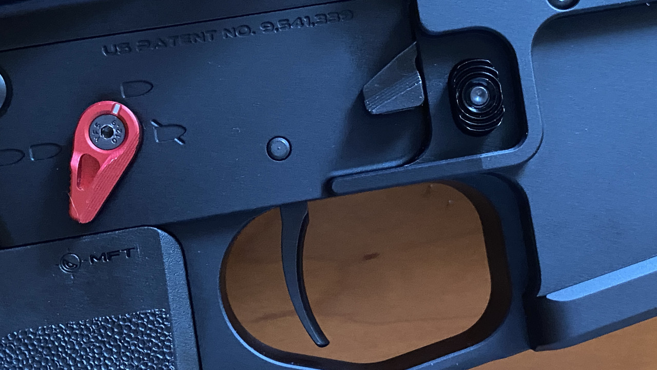

This little guy acts as a bolt lock and release. Pretty slick and easy to function. Not 100% used to it yet.
The left side

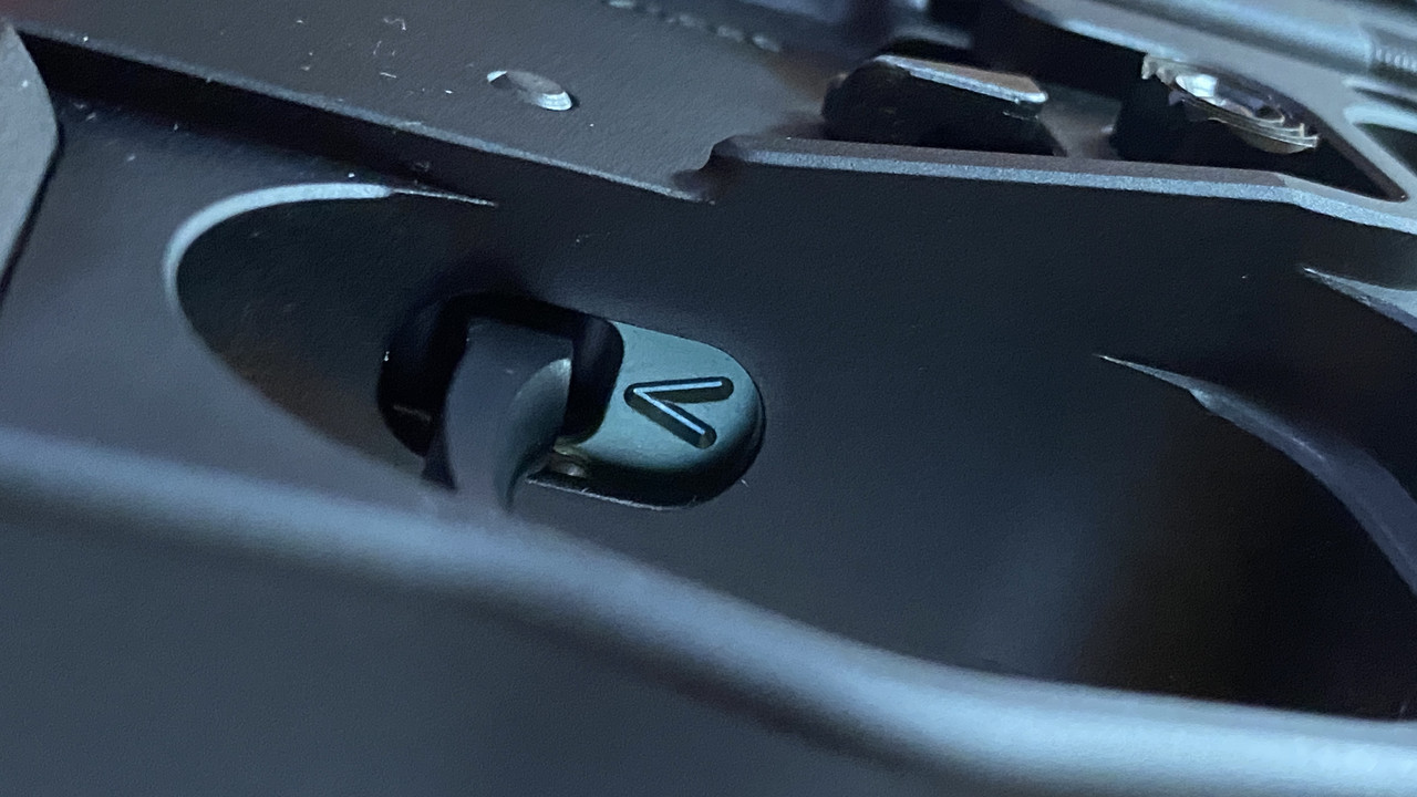

Gratuitous detail shot of the "V" showing through the trigger cutout.
