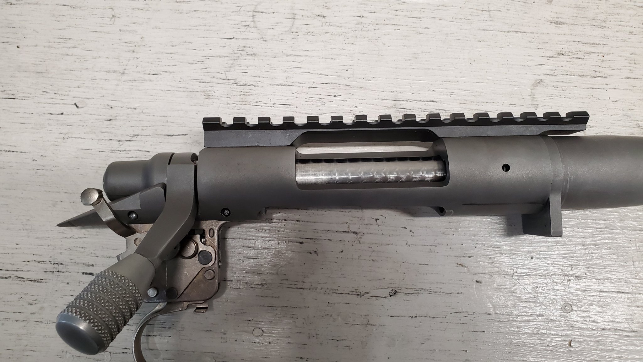

    Trying to thin the herd a bit, and this rifle doesnt get shot as much as it deserves. It's a trued stainless 700 action with double pinned recoil lug. Normal truing process, squared receiver, lug recess, and bolt face, lugs lapped. Knurled oversize bolt knob threaded onto factory handle with gretan speedlock fp assembly. Tps steel 20moa rail with recoil lug. Factory, tuned 700 trigger

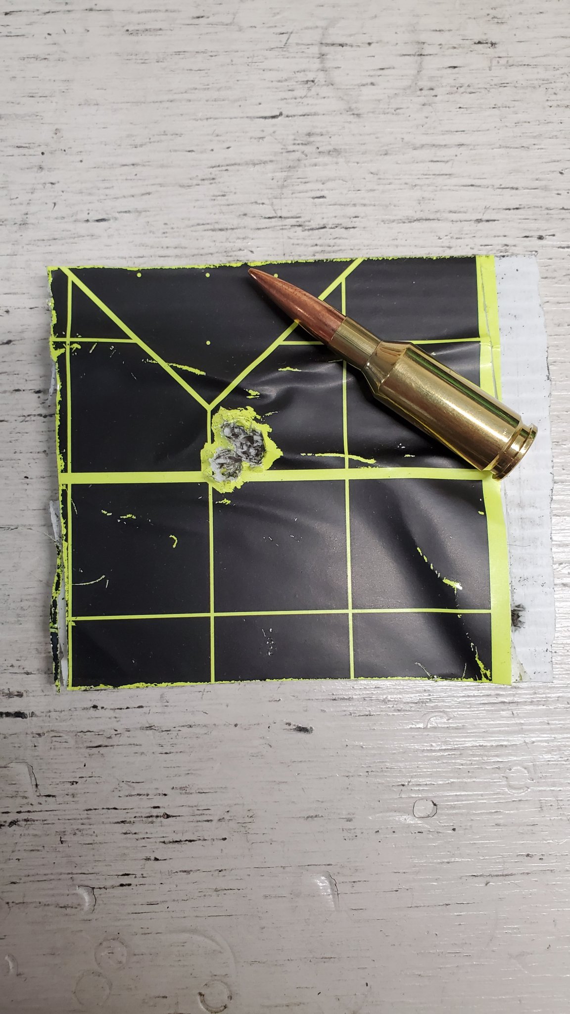

    Now for the barrels. 18.5" brux 7.5tw 6br 5/8-24 threads. This barrel has 825rds on and should be good for another 2-2500 rds of great accuracy. I have 2 loads for this, 107smk and 105hybrids using h4895. It ran 2730 and 2745 respectively, groups in the .2s-.3s was normal. I will include one aics mag converted for 6br

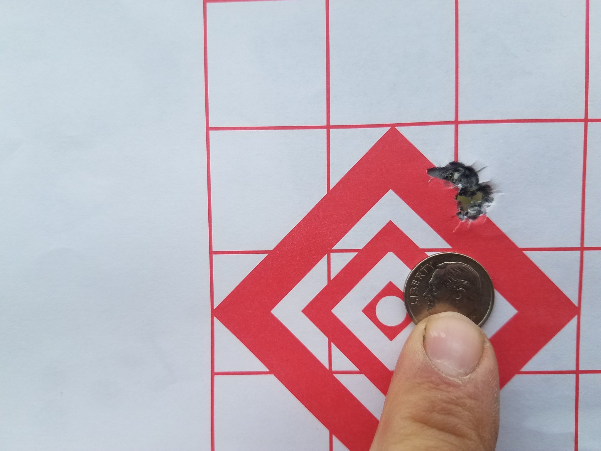

    The 2nd barrel is a 24" bartlien 8tw 22-250ai, threaded 5/8-24. This barrel is still fresh, 185rds on it. Load is a 75gr vmax and h4350 at 3420fps, it is an absolute laser and has smoked a couple coyotes at 645 & 697yds. I will include a set of hornady 22-250ai dies

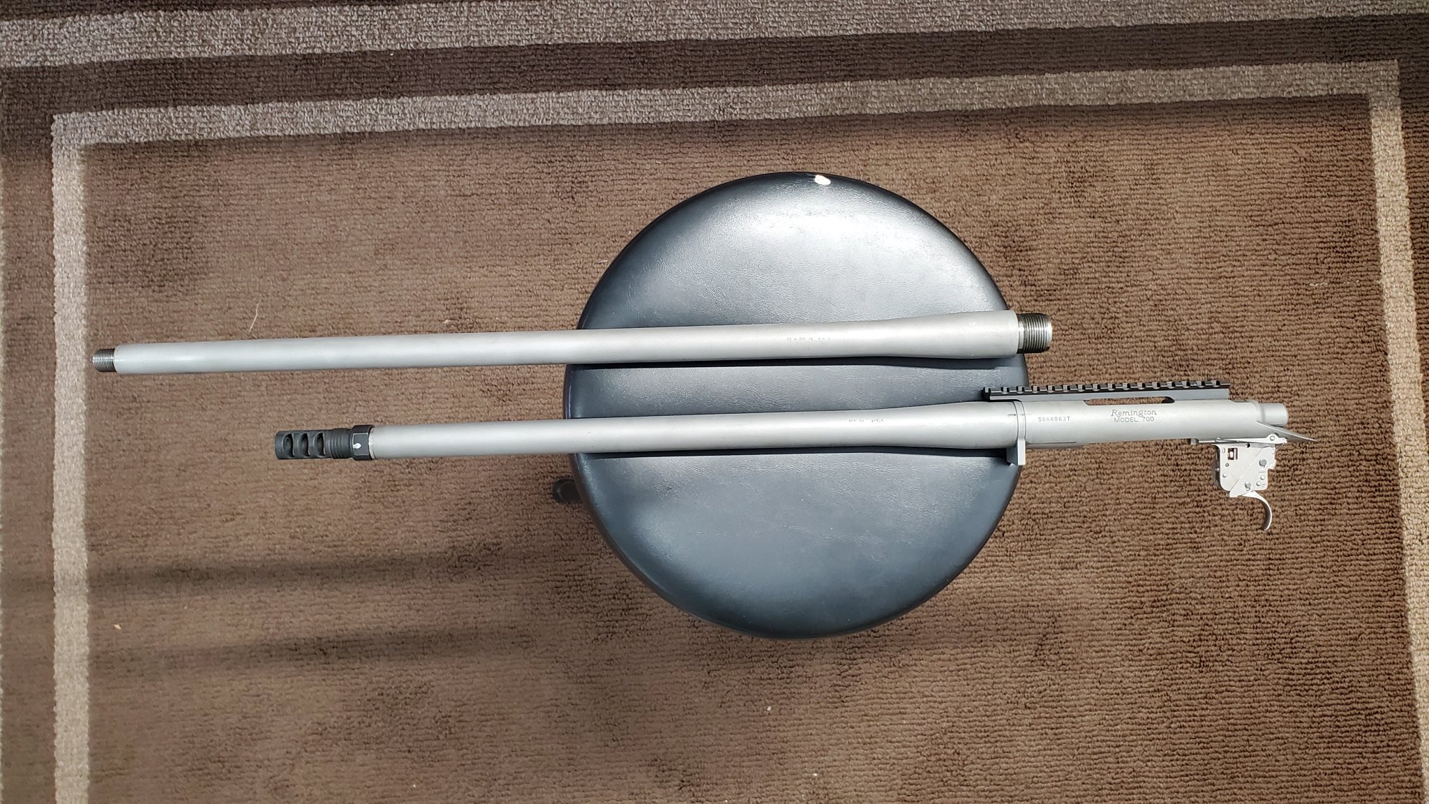

    Both barrels will ship without muzzle devices, but threads protected. PayPal f&f or g&s+4%. Your ffl must accept from individual, or there will be an additional 20.00 transfer fee for my end. Looking for 1200.0 for package
    22-250ai barrel and stuff sold. 6br barreled action and converted aics mag still available, 850 shipped.
    Doesnt look like it. What's so great about a RR prefix? This action came from an early gen1 5r milspec. It was trued up by Gary breitling, fairly big 600yd br shooter and builder from Illinois. I guess the best I can say is that it's a stainless 700 SA 308 bolt face repeater that is as true as a 700 can be made.
    Very good. Ejector spring is shortened 1 coil or 2 coil, gary set it up so it would toss them good with out knocking brass off extractor. The 700 factory spring is pretty stiff, combined with short br case it can cause the case to sling out when withdrawn from chamber and hit receiver wall. That can, depending on extractor, cause the case to drop inside action. By trial and error, shortening the ejector spring keeps it from knocking case loose from extractor during ejection cycle. Brass and loaded rds land same distance/location as any other 700.
