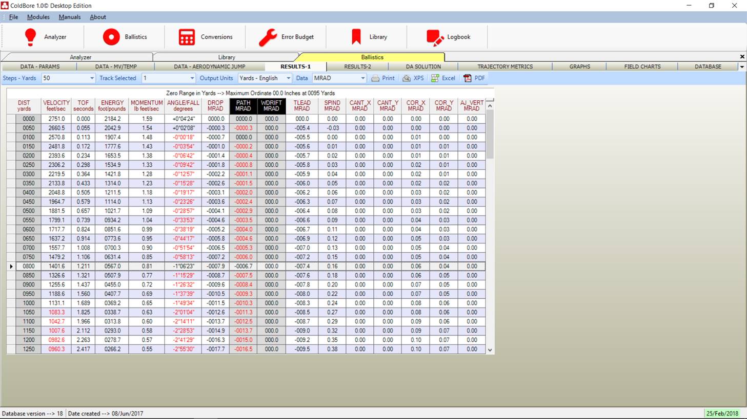

As a newer rifle shooter I have been doing a lot of research about ballistics, the various apps available, capturing and recording data etc. I am trying to find info on how you true BC. I have done searches but unfortunately not having any luck. I am sure there is info on here about how to do it and if someone could point me to the info that would be greatly appreciated.
It’s simple. If you know your MV adjust the ballistic calculator BC until the drop in the calc equals what it actually was. The published BC is only valid at the specified muzzle velocity. If you don’t have a chrono and don’t know your actual MV it’s a bit more difficult. In this case you can leave the BC and tweak your MV to get the actual drop. This is the less accurate method.
You want to true your BC around 800 yards, that seems to be a good middle ground.

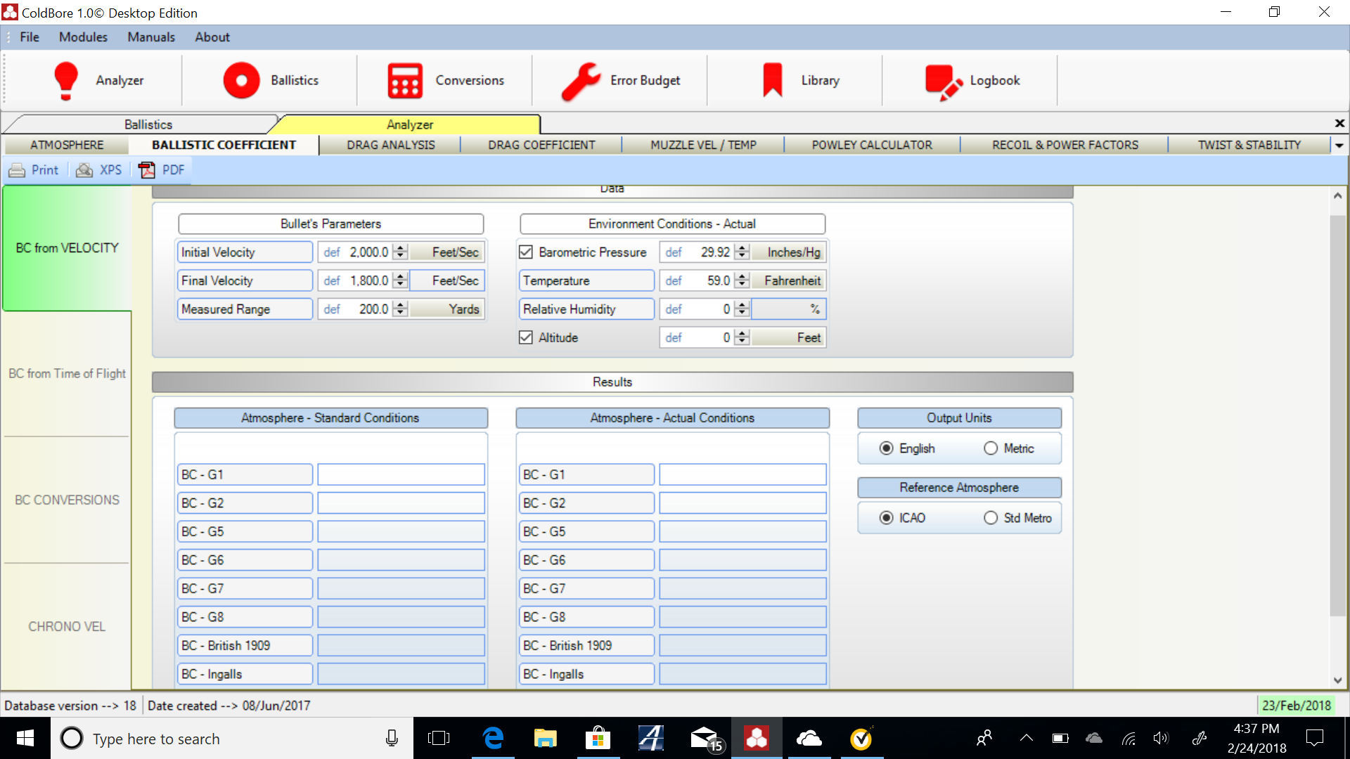

Right now I am playing with the Utility in ColdBore to do it, and it's working out well
This program has been around Longer than Most, it's easily the 3rd Longest running program out there
Patagonia Ballistics
Super accurate, super robust, not expensive, the only downside, is, the only App they have is for a Windows Phone. One license runs on a Windows Desktop, Windows PDA (Trimble) or Windows Phone. All linked via the One Drive

Frank,
I am a little confused.
1. You said it should be done at 800 yards but it looks like 200 yards from your entry.
2. How are you measuring velocity at 200 yards? Can't be a labradar??

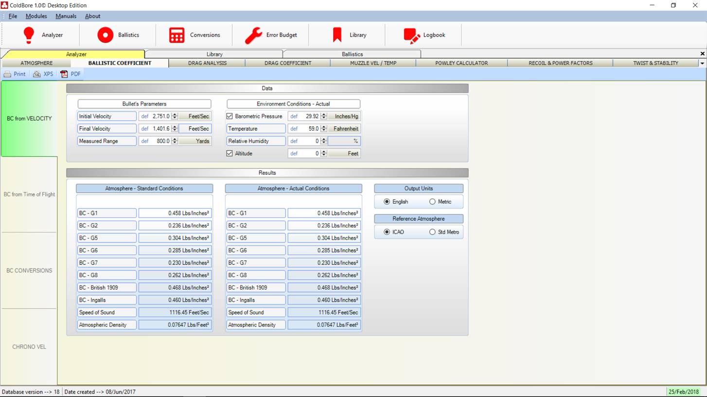

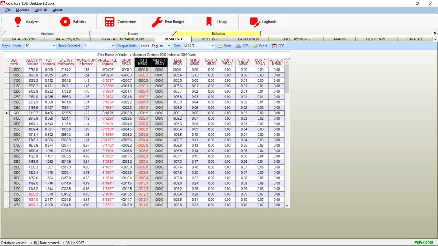

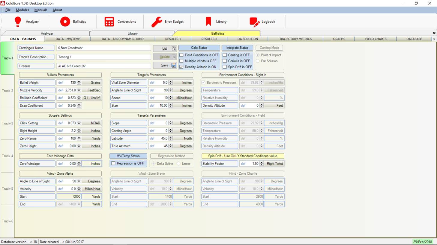

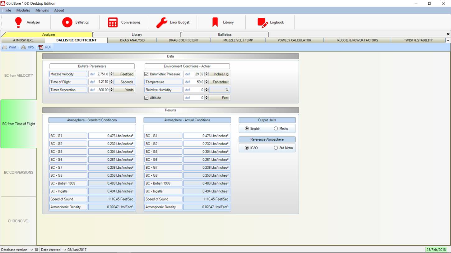

Ok so I am probably overthinking this or doing something wrong but I went into CB to test this out.
Using the Prime Ammo info for a 130gr 6,5 Creed I input the parameters into the ballistics section to get the drop data.
I then adjusted the BC down on the original input data to simulate a different drop at 800 yards.
Using the ending velocity number at 800 I put it into the BC from velocity in analyzer, I also put the TOF from the 800 yard line and input it into BC from TOF. Doing both of these gave me 2 separate G1 BCs. BC from Velocity - .458 BC from TOF - .476. Any insight would be greatly appreciated.

I noticed you are using 2751 fps for MV. Where did that come from?
After correcting I still received different BCs from the BC from Velocity and BC from TOF. .462 and .479 respectively.
