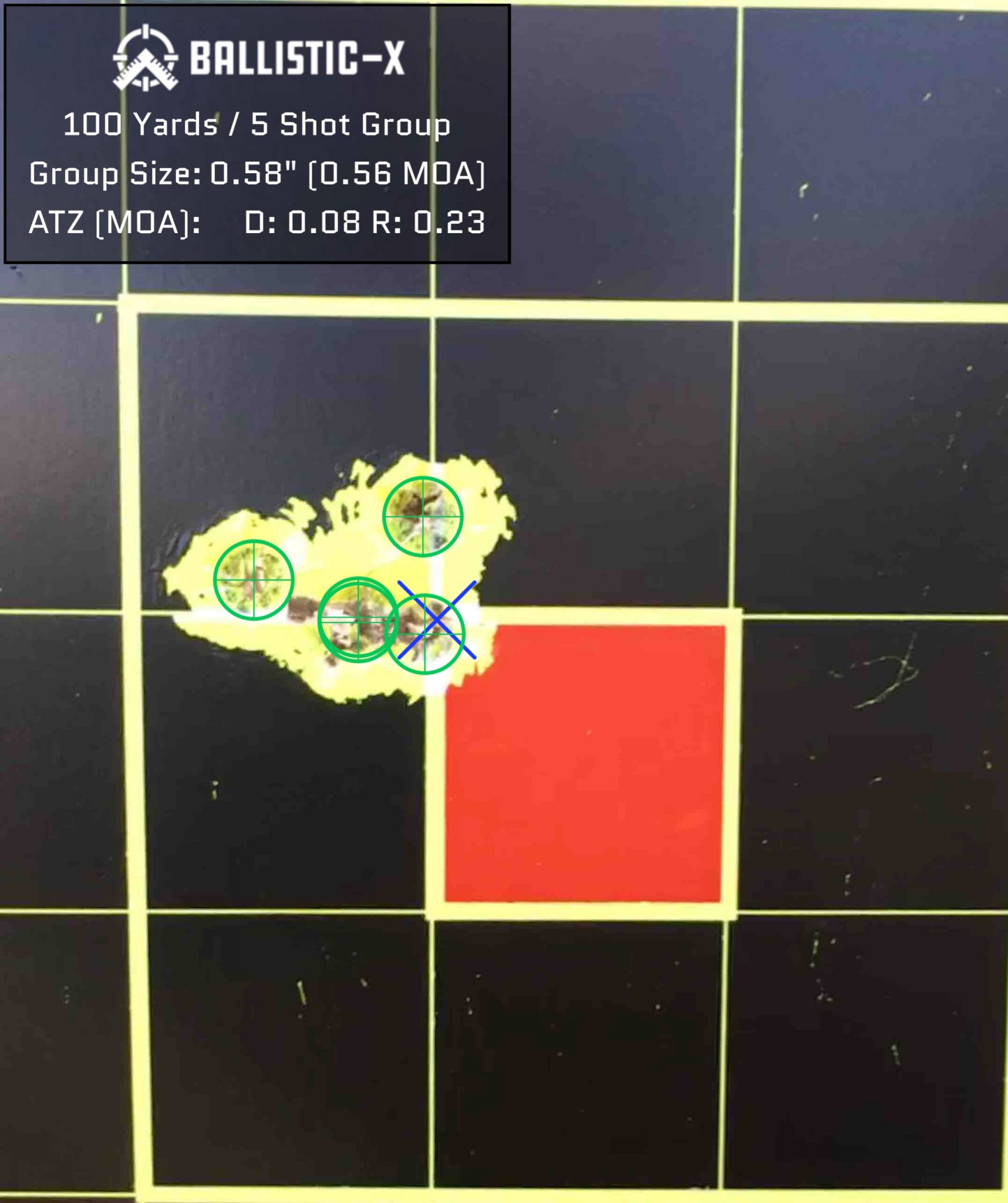

This was my zero check aiming at the top left corner or the square before the match. Also There was a KYL rack at 340yards and I was center punching all targets except the last 1, which I missed ?. My elevation misses were only at 450 and out.
What were the lighting conditions at zeroing vs later when shooting the farther targets?
Funny that you ask, it was a lowlight night match. Targets all had up lighting on them so we could pretty clearly see them. Wind was very mild to none.
So you zerod in daylight and shot further targets at night?
If so, my vote would be the change in lighting. If you zero in strong sunlight and then shoot when a cloud blocks out the sun, your rounds will go .3 to .5 high depending on exact conditions.
Light can, and often does, have more effect than any other environmental change.
Thanks for the nugget! I was going nuts thinking my DOPE was way off yesterday. I've never heard of light having such an impact on POI. I'm going to make a separate card and compare performance next time I shoot a match. Guess the only solid way to learn this is through experience in the field.
