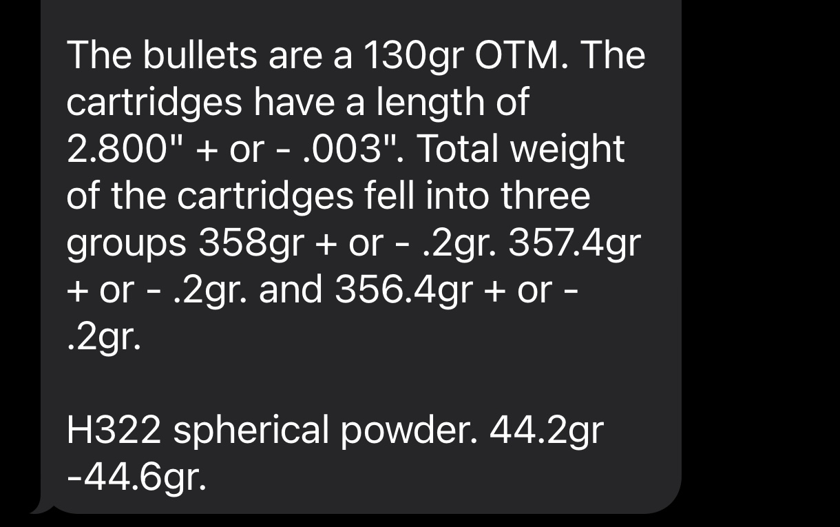

I’ll have to check the H2O capacity, but it’ll be from a 14.5” barrel, aiming for a velocity of 2850 or so from that length with a 130gr
I looked up the MK319MOD0
  • 130 grain OTM (reverse draw jacket) bullet
  • Temp stable flash reduced propellant
  • Not yaw dependant
  • Reduced recoil (10%)
  • Optimized for MK 17 (16” BBL)
  • 2925 fps @ 15’
  • Accuracy, combat -NTE 2 MOA. (600 yds)
  • Intermediate barriers; auto glass/doors.
  • Terminal, Specifically CQC & behind barriers

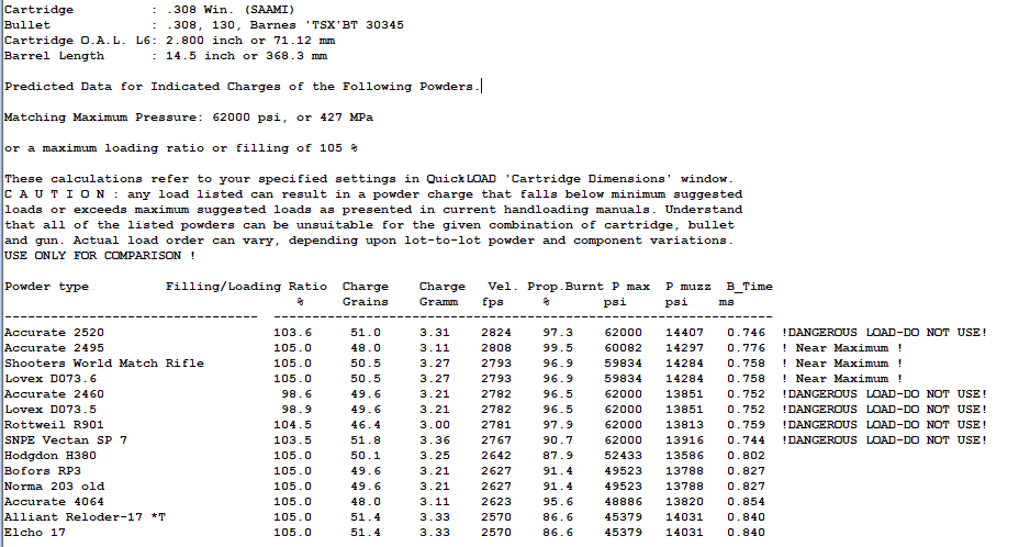

I think you could get 2775-2800 from a 14.5" with a 130gr TSX. Brass primer pockets might not last long.
Reactions: simonp
Well, that seems to be asking a lot from that length barrel.
Looks to me like Win748 is your best powder alternative for "relatively" safely reaching that velocity.
My data is based on 50.392 grain H2O case, so your case volume will matter.
With N133 at 100% case fill you are only looking at 2550-ish. So, with either load it will be compressed.
Not sure you're going to "safely" get there with the powders you've listed, based on my cursory look at the data, without going dangerously close to the edge of what is safe.

Try running the number with 54gr H2O. That would average out over the multiple brands I've tested over the years.
Reactions: hkguns
Using that case volume it looks like I can get to 2725-ish with N133, but it isn't a load I'd be comfortable shooting.
Hold on, looks like 3031 is possible, but I'm not comforatable posting the numbers here.......Something I'd also not be comfortable shooting and would have to start much lower and work up to.......But I got 2846 at just below max pressure with 3031.........AND you are burning just over 99% of your powder.
So, OP, I'd say stick with 3031 and work your way up safely, monitoring velocity and watching for signs of pressure. But you're not likely to get there with published load data.

Barnes has posted on their website a decent load with 3031 for this round so I might try that. Was wanting to do N133 because I’m pretty sure it has flash suppressant in it
Thanks, I’m just surprised by the one laid i saw online of someone using 44gr of N133. I might try to ask some guys from AMU if they have the actual load data for the production round
That load "could" be perfectly safe in your rifle, depending on your case volume and your chamber. However, its only likely to get you to 2685-ish.
FWIW my initial case volume was a statistical average of LC12 762 brass in my inventory.

The powder you will get the highest velocity from is almost certainly going to be a dense, high energy double base powder. Single base stick powders won't get you there.
2000 MR is the best choice for maximum velocity, but it generates a ton of gas in semi autos and isn't the easiest on barrels.
Your velocity goal of 3000 fps is unrealistic, particularly in a 14.5" barrel. Somewhere around 2700-2800 is about the most you should actually hope for.
Also I wouldn't hold your breath for amazing accuracy from your FAL. Mine was a consistent 3-3.5 MOA gun even with high quality match handloads, and it chewed up brass like crazy even with the gas adjusted correctly.

Hodgedon H335 might be worth a try for a couple of reasons. It works well with light .308 bullets (147 to 155) and because this powder is on the fast end of the spectrum, it was the only powder to reliably cycle a new FN FAL build during its initial break-in. I still use it now in the FN at 41.5gr with the 147gr bullets. Since the OP wants a short barrel gas gun, this powder might provide a burn rate to keep velocities on the higher than normal side.
I’ve had good luck with cfe223 and light bullets in the .308. 52.5 grains, a 125 Speer tnt, with federal brass and Cci #34 primers.
Velocity out of a 16 inch lmt are right at 2920 fps. It shoots well out of multiple firearms too.
So a bit of an update, I talked to one of my buddies who’s got contacts at both sniper school and the army marksmanship unit which are just down the road here. I got the official load data for this round and it’s using a way faster powder than I initially thought but this is the published load data for the round and looking at factory data and pressures it seems reasonable.
