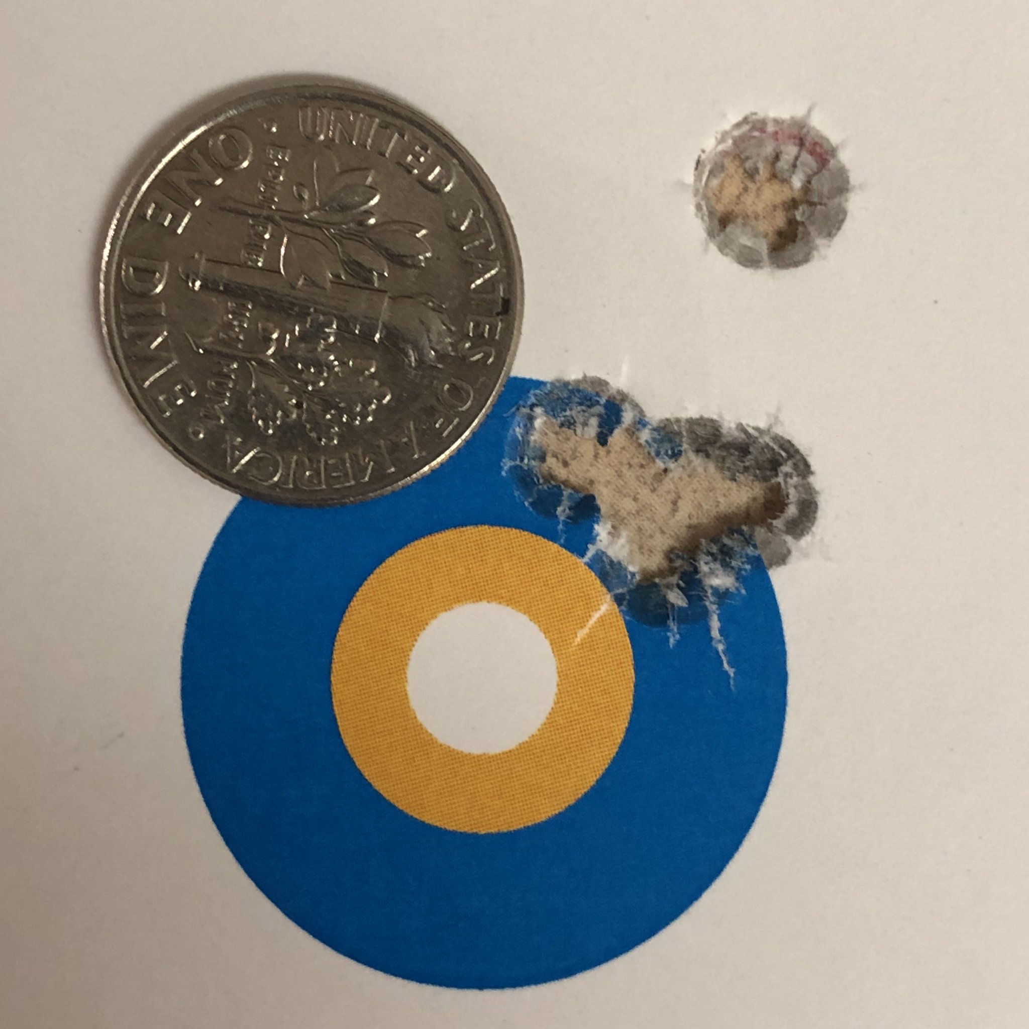

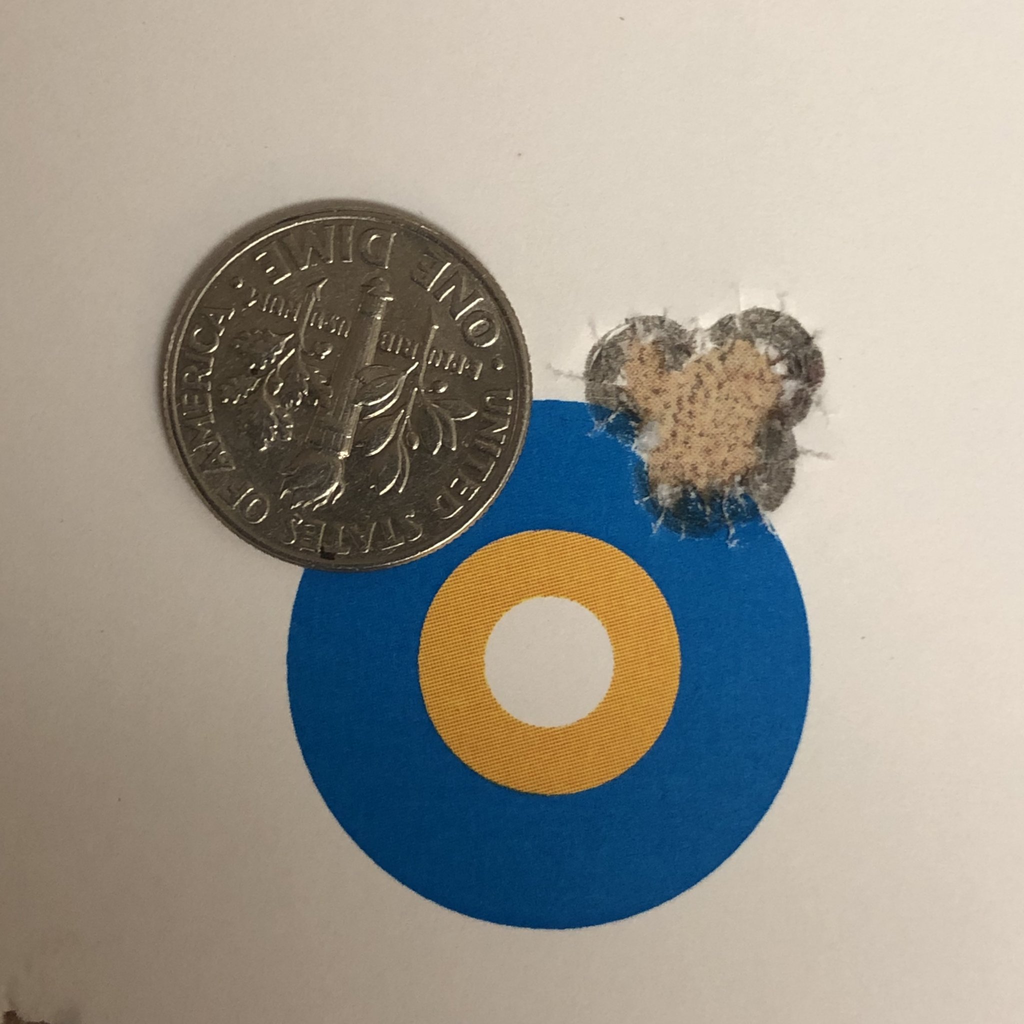

Ran the test I wanted today since I was already at my range for RSO training. Shot a ladder to evaluate bolt lift. 5 round at 42.2 - 43.0 in .2 grain steps.
Lessons learned. In 40 deg temps, bolt lift began to get a bit harder at 42.8, and was more noticeable at 43.0. The two groups below were 42.4 and 42.6 and extraction was buttery smooth.
Next step will be load a box of 50, chrono 10 for velocity and SD/ES, then true up the kestrel with 1000y drop data.
