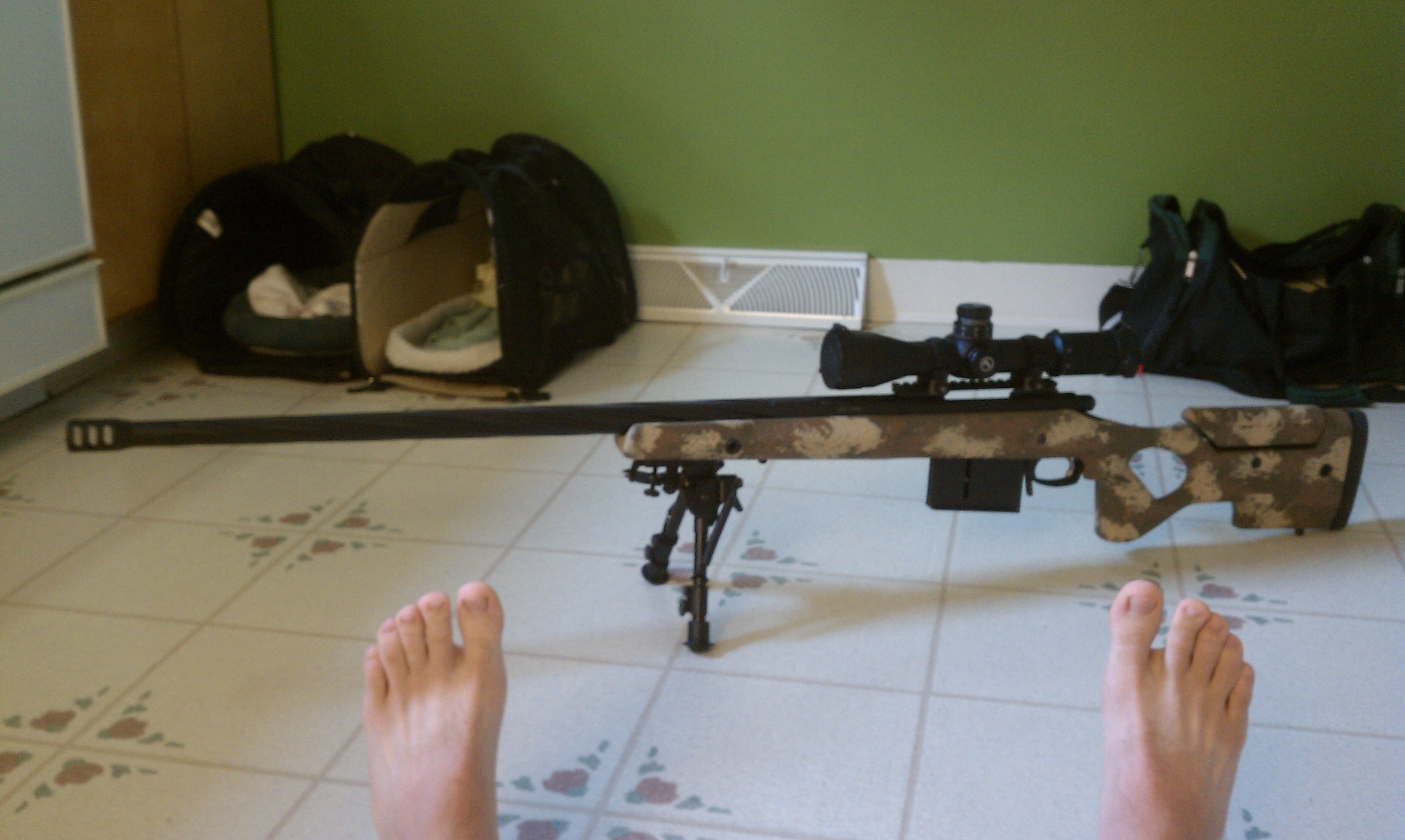

I went with a 300 Rum
manners T5a normal fill with mini-chassis
29" hart barrel magnum 1000 contour (close to MTU)
Hollands muzzle brake
Jewell trigger
Night force scope and badger rings
I came in at 16.8 lbs
