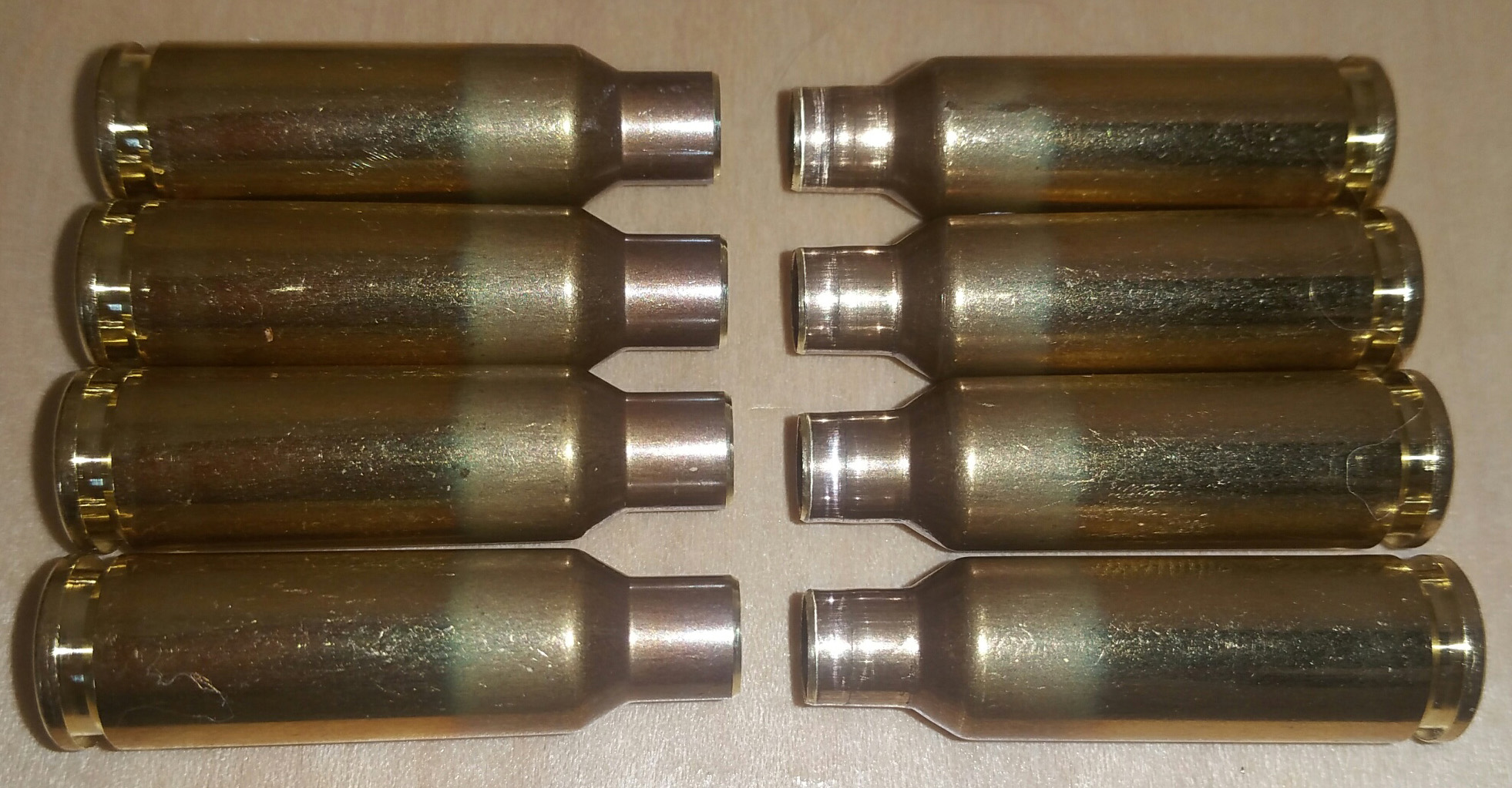

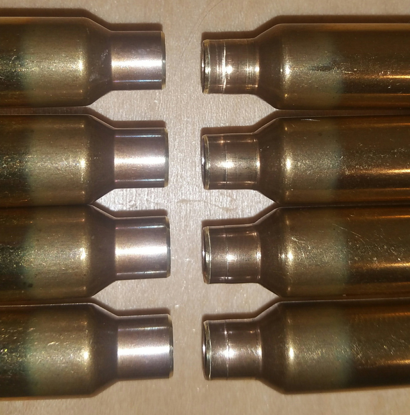

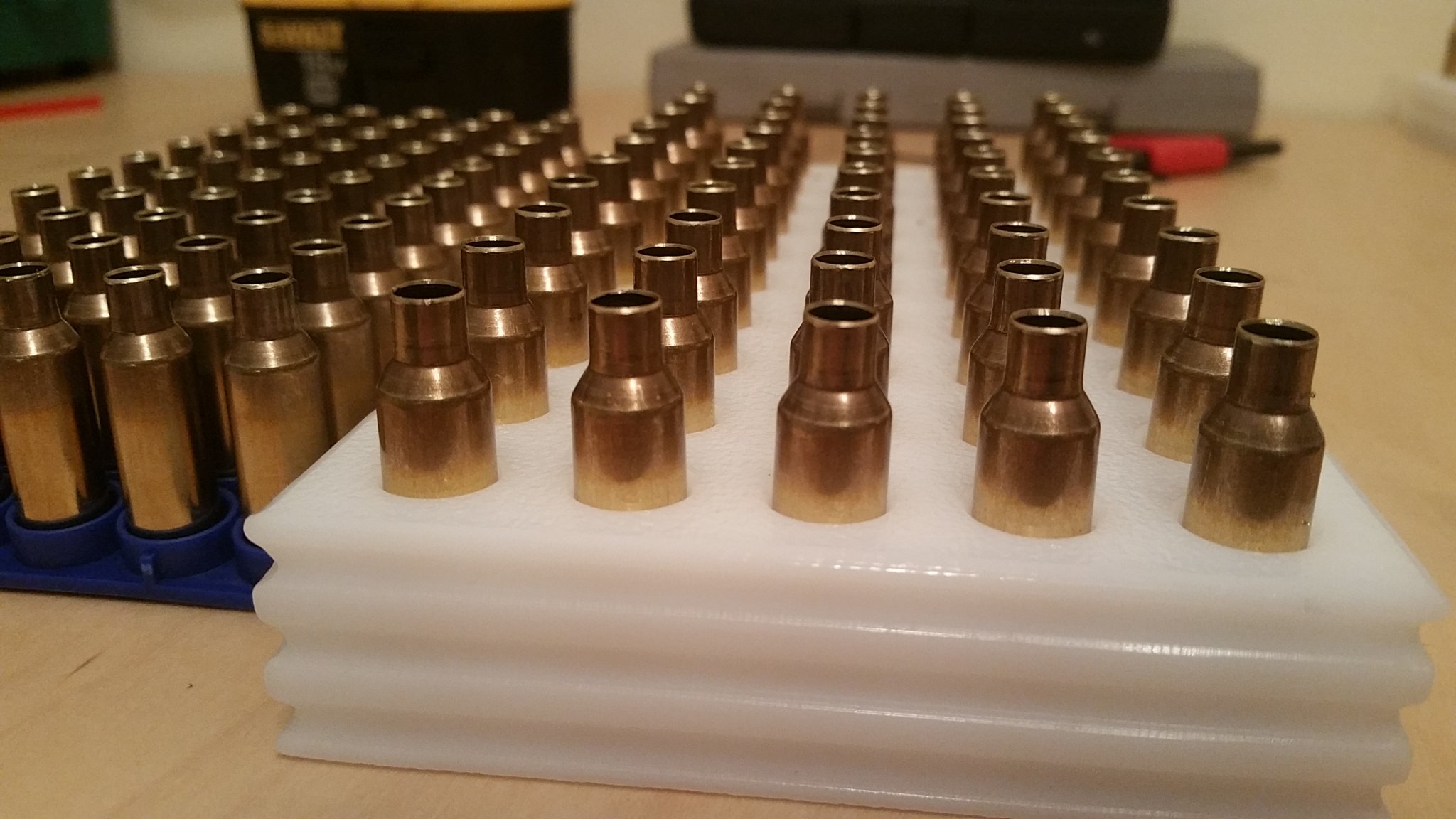

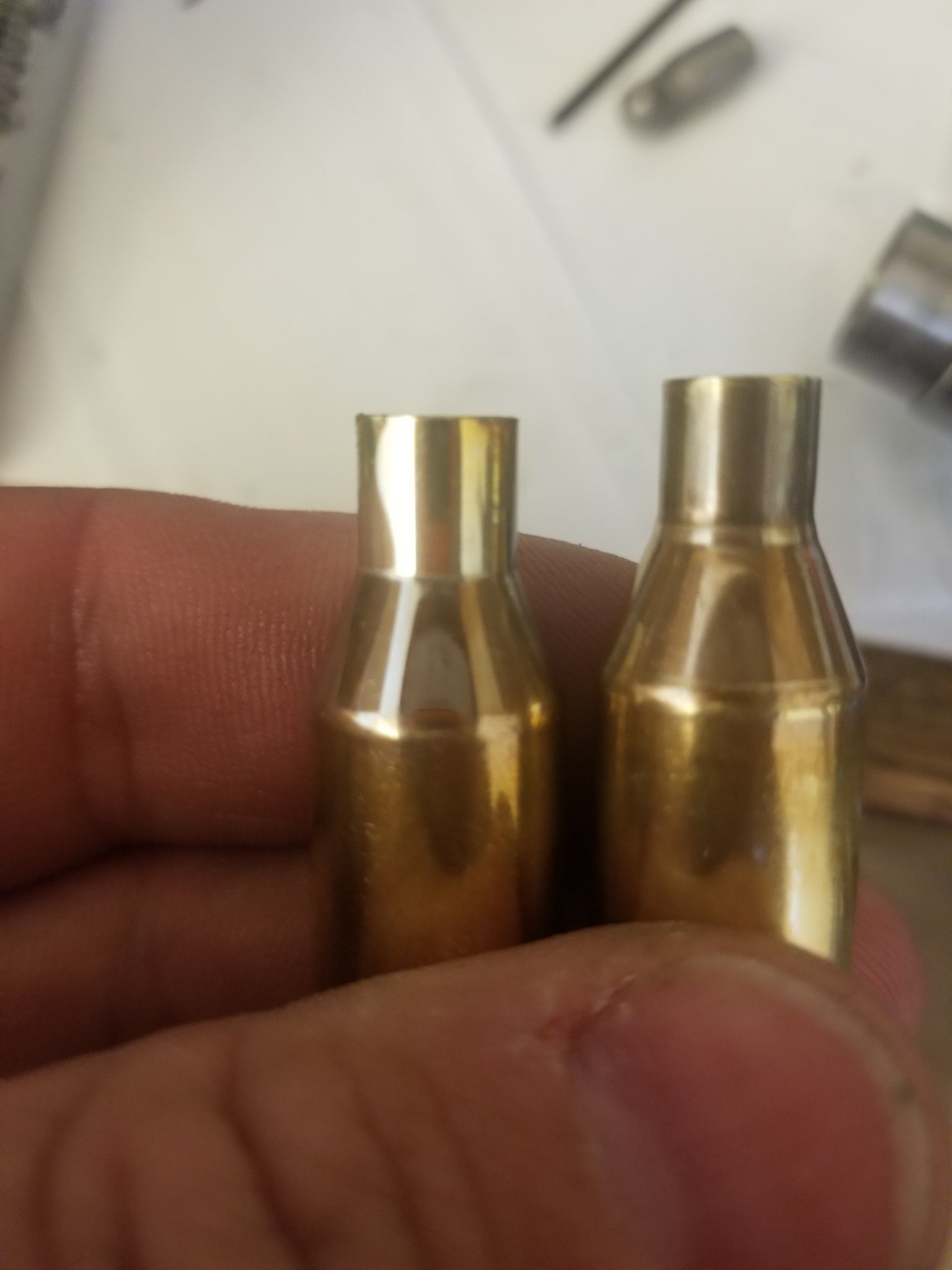

    This is my first attempt at necking down a cartridge, and its not going well. Im trying to take Lapua 6.5 Grendel to 6mm Predator (6mmAR, 243LBC, 6mm Grendel - whatever you want to call it).
    My setup:
    Dies: Redding FL Type S for 6mmAR (w/ entire decapping rod/expander ball assembly removed)
    Bushing: .268
    Lube: Imperial Sizing Wax
    Brass: Lapua 6.5 Grendel
    The pictures can do a better explaining than I can, but there is a ridge, crimp, wave type deformation. I followed all of the directions from the guys that load for this round I thought, but obviously im missing something. The only thing ive found so far for a possible solution is adding a step bushing in the .25 cal range (maybe like a .279).
    My technique is to chamfer the case mouth, lube the neck & body w/ the imperial, run the ram until it makes contact, slowly bring down, about halfway down I raise the ram, then bring down the full way (I tried 1 case w/o the stop and it didnt help)
    Also, I tried setting the die to not bump the shoulder more than .0005" (my caliper rounds to the .0005). Would I be better off bumping the shoulder a full thou to ensure im getting the entire neck sized, or is my technique fine?
    Thanks for any help

    Trying to do it all in one shot with a bushing die is causing your issue. Bushings have minimal chamfer on them, so they get as close to the shoulder junction as possible under normal sizing. Breaking it up into two steps(like you suggested) will solve the issue.
    You really shouldn’t use S dies to neck down for just the reasons your seeing.
    No matter how far you bump the shoulder your gonna have that ledge.
    You might be able to get what you can of the neck then use the chamber and some lube to finish them but that could get iffy as well.

    Just to confirm, the one that you did without stopping halfway through also had the weird ridge in the middle of the neck? Or just down at the base of the neck?
    Bushings wont size all the way to the base like has been discussed already. I find it weird that they would do that to the middle of the neck though.
    I think it’s because of sizing the neck more than bushing dies generally like to.
    theyre all the same - the lighting may be playing tricks. stopping halfway did nothing different than a full stroke.

    For anyone following along, I tried again with an intermediate bushing (actually I borrowed 2 just to be safe - .281, .274, .268). Went much better. No discernable false shoulder, and smooth walls. Also removed the expander ball and did a final mandrel .002 under diameter. Getting cleaned right now, then I'll try to chamber.
