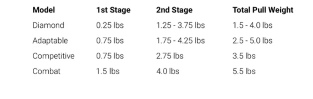

    Here is a breakdown of all the TT AR-15 triggers.
    Reactions: Neurotic
