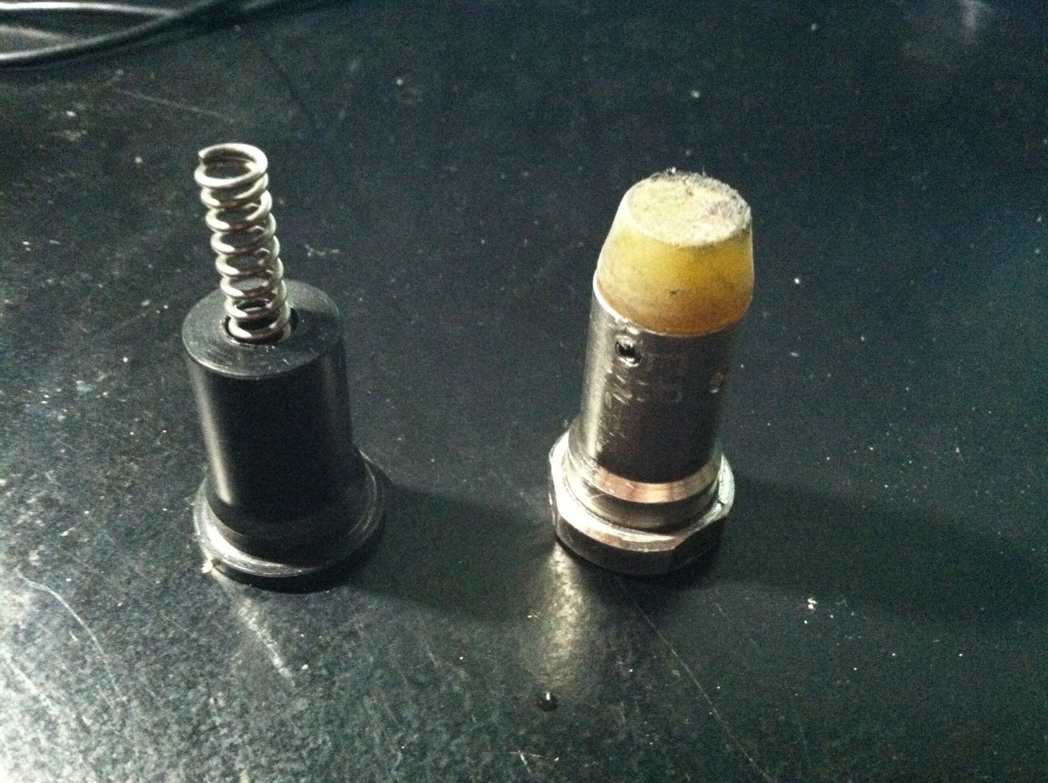

Many, many moons ago I shortened a carbine buffer and installed copper powder. To take up the space removed I made a plastic buffer that went in the buffer tube first on the other end of the recoil spring. And in the middle of the plastic buffer I installed a heavy spring. It acted like a hydraulic buffer and definitely changed how the recoil felt.
Here is s picture of a prototype to see if it would work.
