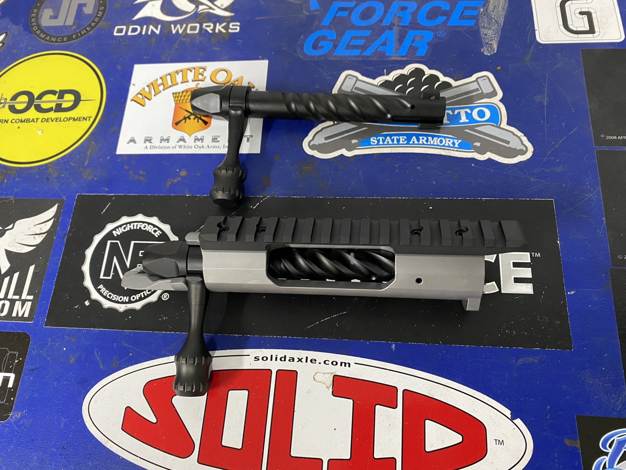

I asked about this a while ago too. Only got one person saying they have one.
I’ll have one Tuesday, but it will be a couple weeks before I spin up a barrel for it. I’m building a .223 on it first, but I got a .308 bolt for it too. I handled one at a match last week, I liked it.
Action came in today, but I have a couple barrels to do for other people before I have time to cut one for myself (for my boys really). .223 and .308 bolts, so it can grow with them.

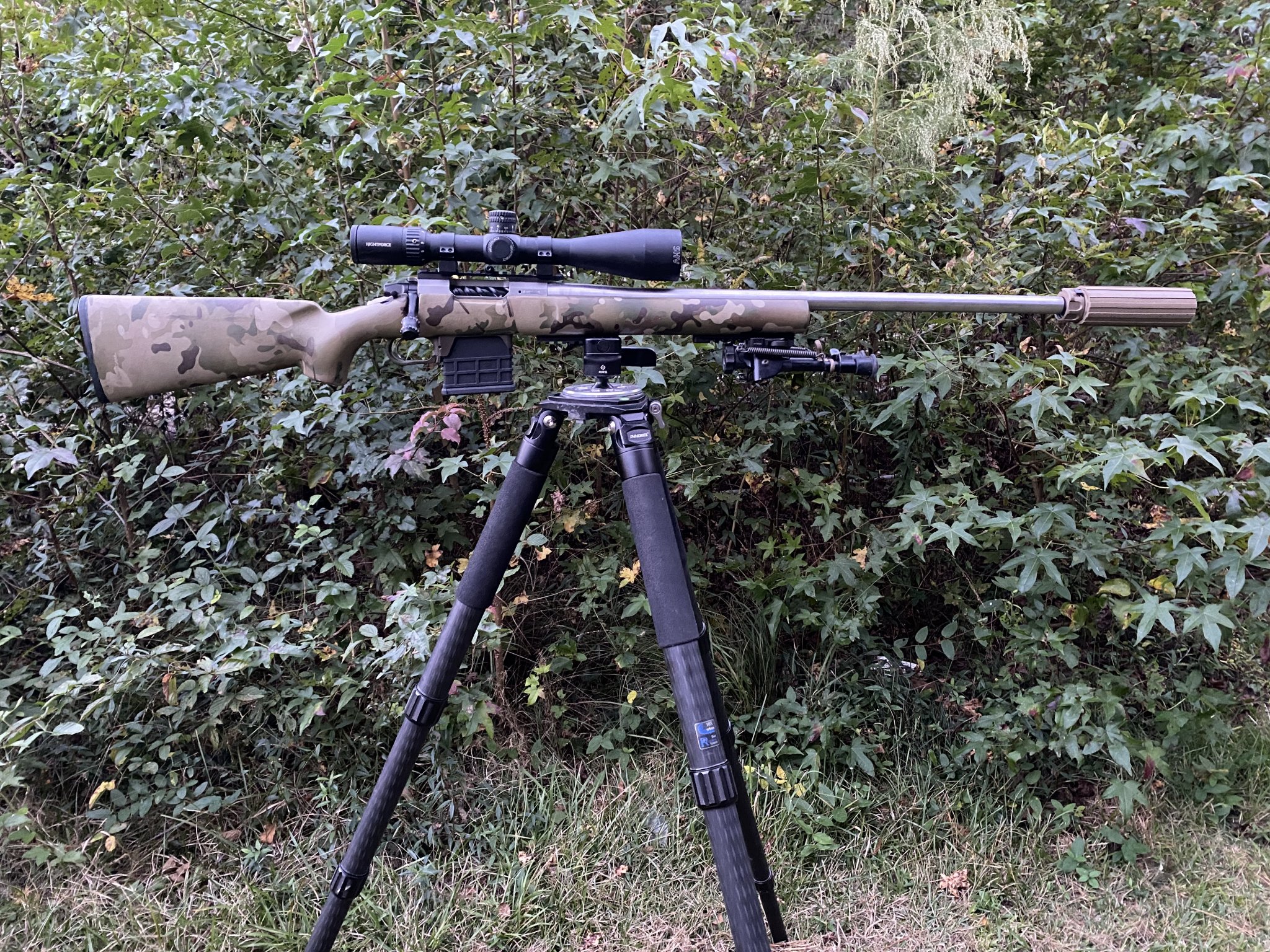

It’s been a while, but I finally got this shootable. It has a takeout Xmark trigger for now, and I stole the scope off the Valkyrie and used an old set of rings from way back. It still needs some paint too, but knowing me the barrel may get shot out before I get around to it.
With the current state of affairs it’s tough finding powders that I’m not already stocked up on, so I seated some 75 ELDM’s over Varget. Hopefully we’ll have a calm evening in the next few days to see how it shoots.
So far everything looks good, the action is smooth and bolt lift is light, but you’d expect that with a .223. It may be a while before I get a chance to cut a barrel for the standard face bolt.
Reactions: briang7511
Quick dirty load test yesterday. I was in a hurry and didn’t measure a thing, I just used the sizing and seating dies as set for a buddies rifle. I used the same reamer for both, so they should be close. Lake city range brass, no sorting other than headstamp. I didn’t even trim them, just swaged the primer pockets. I dumped 24.4 - 25.2 gr of Varget over Wolf primers and seated 75 gr ELDM blem bullets. I shot 5 round groups, the first 4 loads went .51-.55 moa and the last opened up a little. No pressure signs, so I may try some hotter loads later. I consider that accuracy acceptable considering the junk brass and blem bullets. Velocity was 2880-2945.
The action performed flawlessly, it was smooth and easy. I need to get a better trigger, but otherwise I have zero complaints. It’s as good as most of the custom actions I see.

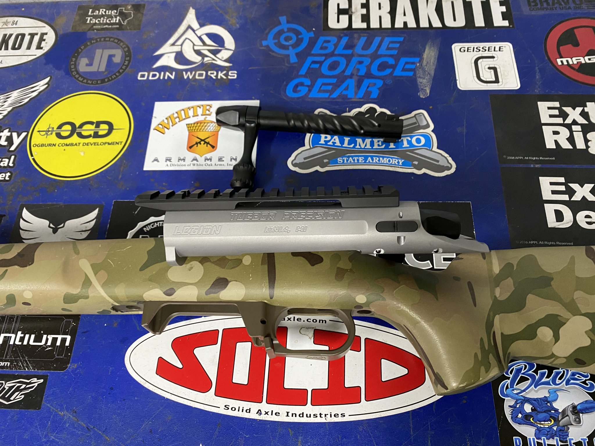

I do like your knob's style better. It has that interior finger grove. Looks similar to Area 419's knob which I LOVE. This is the current design that I've seen in person last month. Not a deal breaker at all, just something I noticed.

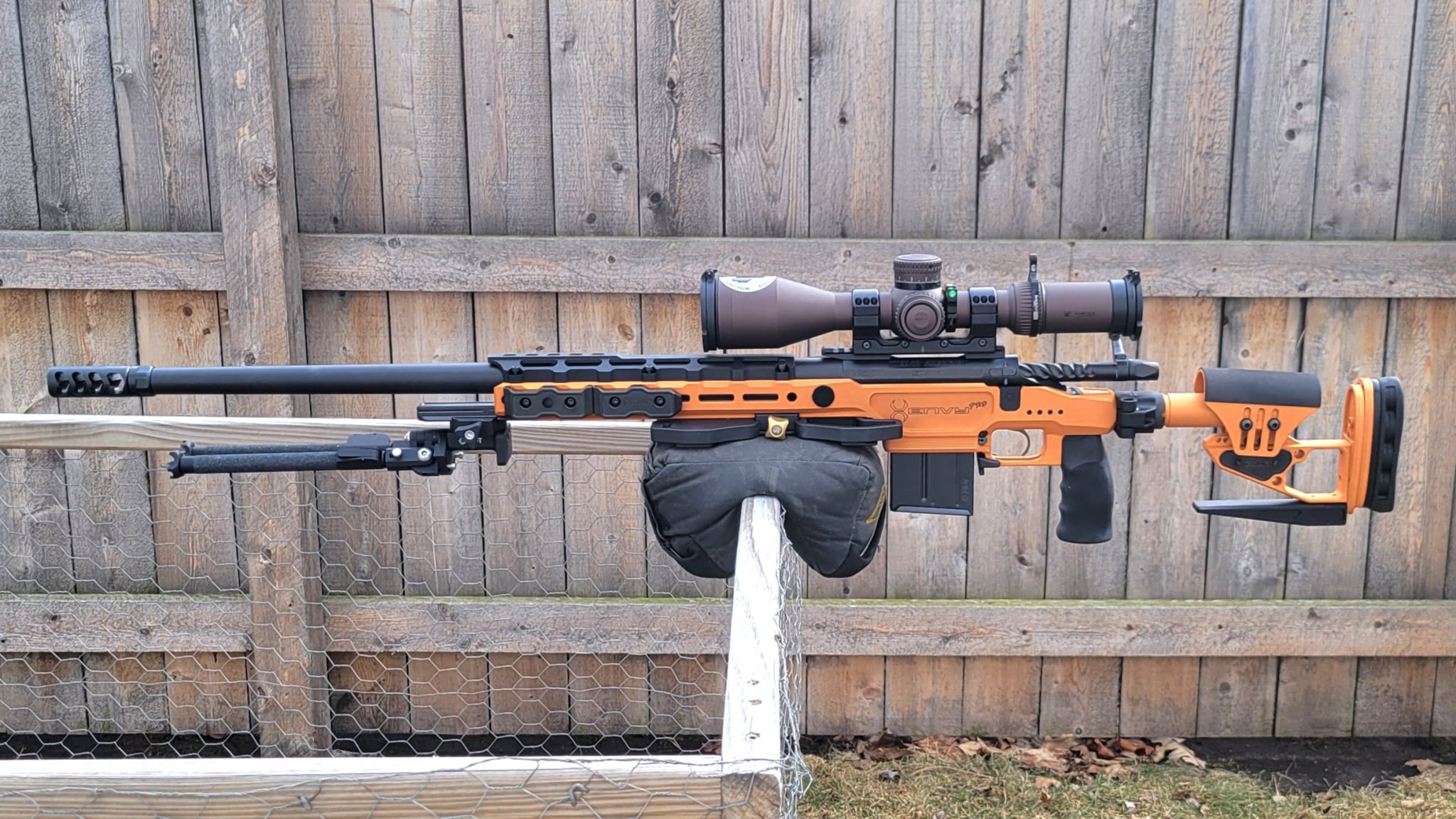

My first non-production rifle is finally done. 100rds for break in this week followed up by ladder load and seating depth testing.
-Tuebor Legion short action in full DLC.
-XLR Envy Pro
-6 BR
-MDT 6BR mags
-Vortex Razor in RRS Uniblock mount
Looks great, hope she shoots as good too.
