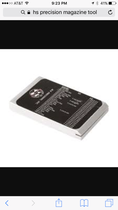

Here's a helpful tool I've found that prevents chewing up your magazines feed lips

I run one of my 6.5 4s in a Sentinel w/IMB and a Surgeon action with Acurate Mag 300WSM mags and Alpha 4 mags. Send me a PM and I'll help you set up your mags with some good starting lip settings, by the way the HS Precison mag tool should be in everyone's kit.
Update.Bas402 got me squared away with great tips and advice.My mags were both to wide to start.Once adjusted they work perfect.Thanks Sully for helping others out.
