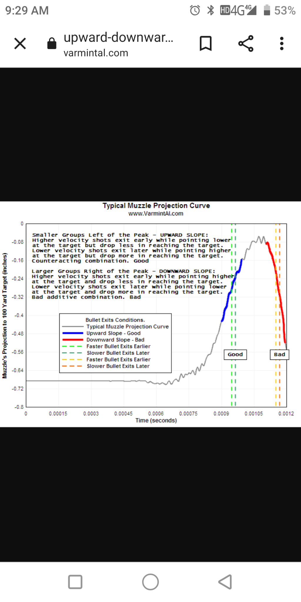

For the past 6yrs I've been been trying to fine a benchrest 22 capable of shooting at least 10 shot 1.5in groups at 200yds. I have bought and sold several guns from full Calfee customs to 50 year old Remington 40x. and everything in between. I have not found that gun yet' but i have learned a few things. #1 All tuners attempt to do the same thing. Get the bullet to exit the barrel on a harmonic node. This is done by adding weight an or length to the barrel. #2 If you can't tune it with a standard Harrels you probably can't tune it. #3 A tuned barrel is a tuned barrel. Barrel harmonics don't change with distance to target. #4 You can't tune at longer ranges outdoors. You never know if differences in shot placement are due to conditions, ammo. you or your tuner settings. #5 Short fat barrels don't respond well if at all to a standard Harrels tuner. #6 The easiest barrels to tune are between 22 and 27in, .870 to .9. And last is ammo,ammo,ammo. Chronographing 22lr ammo is a waste of time. You can't tell from lot to lot, box to box ,or bullet to bullet what the speed of the next shot will be!. Lot testing ammo that is offered in different lots is the only way to achieve maximum accuracy of your gun.

Through experiments I've signed on to this explanation:
Distance definitely seems make a difference in getting slower projectiles to impact the same point as faster ones and makes total sense to me.
I know both you and Calfee don't agree on this. My question is, if you're not getting the rounds to shoot to same elevation by timing the release of the bullet in the wave, what is happening? Also, I definitely see horizontal dispersion in tuning, as if the barrel isnt vibrating directly in line w gravity but in an ellipse or figure 8 pattern. Have you witnessed this?
I've been playing with tuners for a bit, it seems you've been playing longer so I'm curious about your #3.

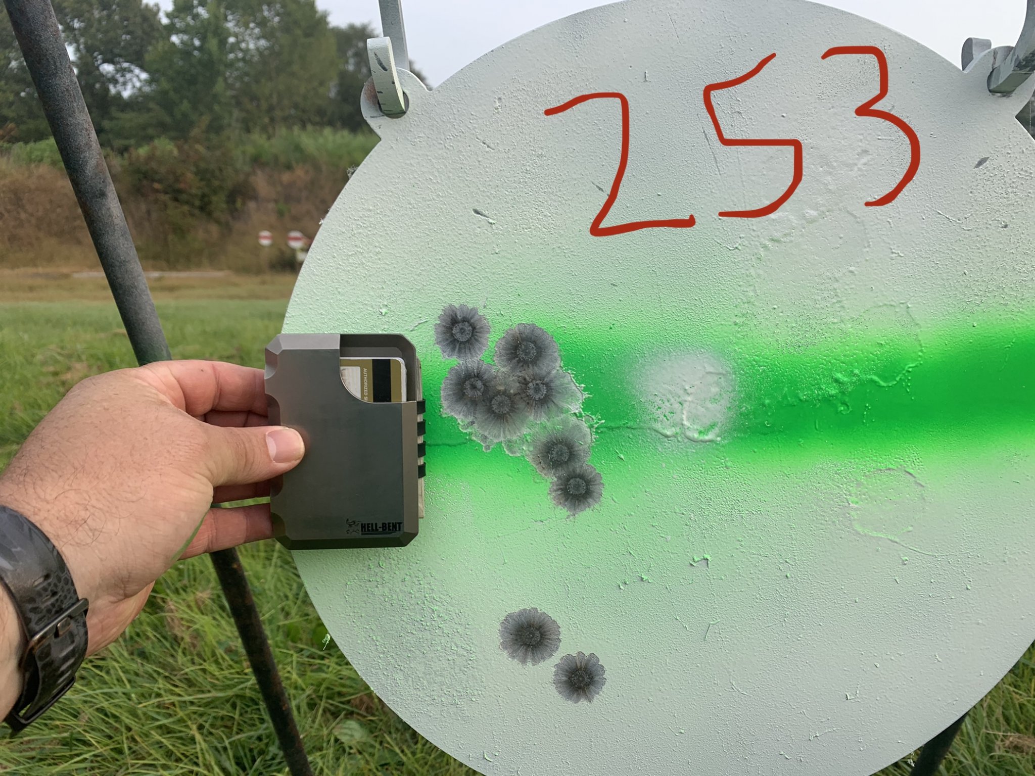

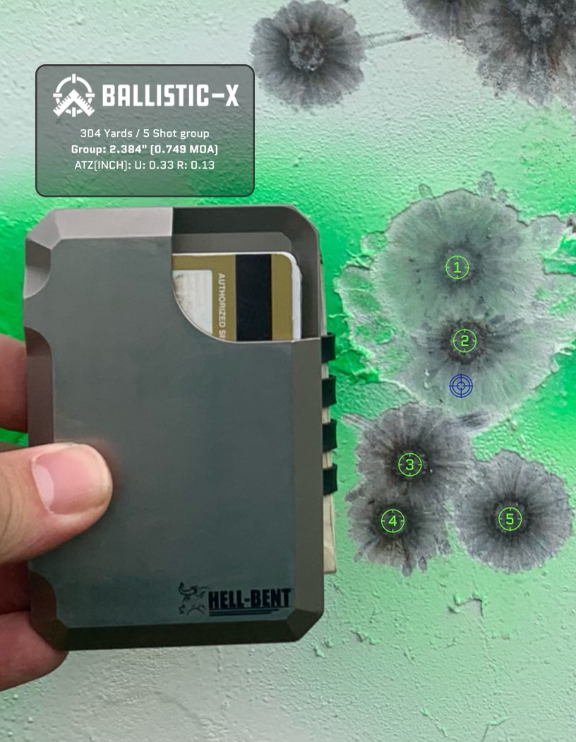

You can in fact tune at 200 and should micro adjust your tune that far out for the PRS/ NRL22 game. You can see the difference in the tuner movements. This is in fact my most CF Shooters tune their rifle at 300-500. There is no way you can have a great group at long distance and not have a single hole at closer distance.
I tune my lot at 50 and micro adjust at 100. Then carry 24" plate to 200 and micro adjust again. It will shrink. You still can't stop a Bad ES or SD. Bad ammo is bad ammo.
Do any of you witness horizontal dispersion when testing for settings?
Horizontal I atribute to me the shooter or an odd wind factor I need to look for.
Vertical Stringing is the ammo ES/SD. It can be tuned out some, but you will not tune out a 20FPS spike or fall in velocity.
All I watch at distance is the group size. If the wind is a constant and moving the group as a hole one way I am good with it. It only takes 3-5 shots at 200 to know if your tuner adjustment is working. The horizontal line on my plate is to try and keep me level and the same position on the plate. I have held one way or another and sent 1 round. The used that 1 impact to base my next 3-5 rounds off of. Make the walk with paint and rinse and repeat. Or adjust the tuner and shoot 3-5 more. You can see the change enough to make the decision.
When I say micro adjust at 100 and 200 yards. I am talking about less than 1 tick mark on the tuner. I might move mine 3 times before reaching the next mark. It works that easy. I was skeptical when I gave it a try, but the proof is in the groups.
