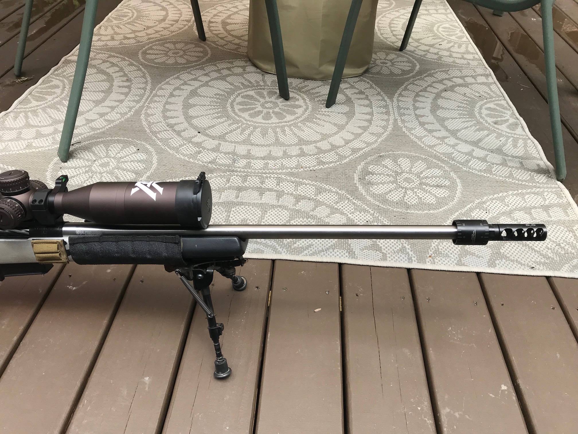

I recently got one of the kinetic security solutions tuners strictly to see if there was anything to it. I had been having some consistency issues with my 338 WM. I tested 2 revolutions. The changes in group size and location were obvious. I ended up getting an improvement in both group size and consistency. I will likely order another.
I can tell you right now. I got one strictly for my 6cm that i only shoot factory ammo through. It took a normal .4 moa average grouping down to a .25-.3 averaging grouping with the hornady 108edlm ammo. It is very apparent to see it work when turning the tuner. One setting, 1st and 2nd shots will be .75 apart, then 2 turns later, they're in 1 hole, and the 3rd, 4th, and 5th follow suit. To say they aren't necessary is one thing, to say they dont work is incorrect.
Really long story on why I continue to shoot a blown out barrel on my 6CM. I have extra barrels all spun up, but continue to push this barrel. The throat is all fire cracked and it’s lost a ton of velocity. I can no longer work with seating depth. I was shooting mostly 2” groups and some 3” and I continue to shoot matches.
Anyway, in front of several Hide guys, including someone that shot the gun with the same results, I put on my Magnetospeed and shot 5 consecutive groups under 1.” Of course, the joke was “Use the bayo in the match.” Anyway, I put the Kinetic tuner, I did not spend much time and it is not as good as the bayo but the groups are 1.5”; so I’m going to use this barrel for one more match.
This was my best group, funny how shitty can look so great after you’ve had ultra shitty.
@Swoodhouse19 ‘s region series qualifier will be this barrels final day. Again, I have barrels, but a reason to try to keep this eating ammo.

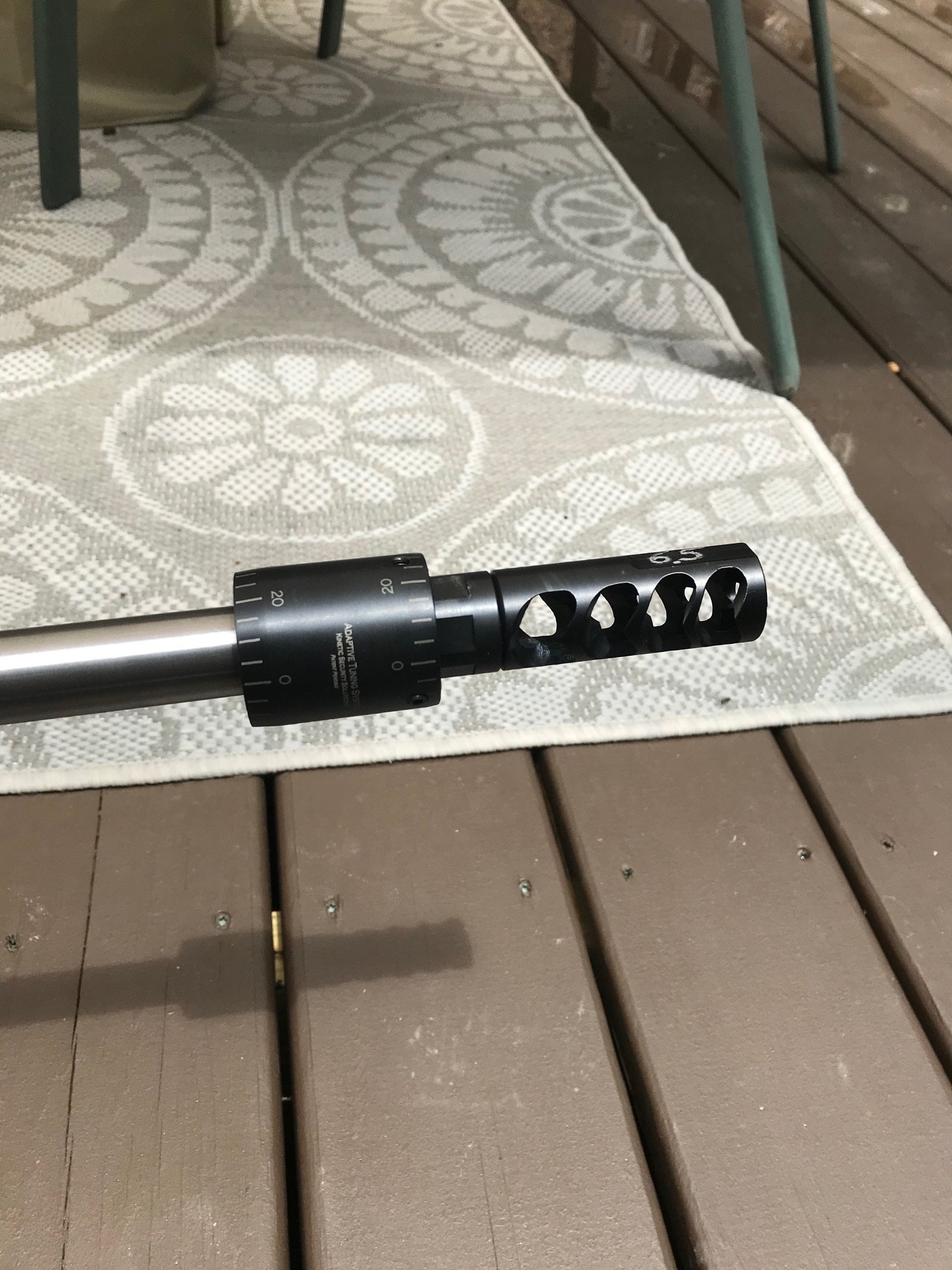

I plan to test this during my next range trip. The goal is not to tune ammo (I've already done that with my reloading process). The goal is to prove that adjusting the muzzle brake out in incremental groups will indeed change group size.

Ok, so I know tuners can help get smaller groups to appear and make your rifle shoot better overall if you can find the right setting. However, do you "find a node" with the tuner like you would with load development?
There are two ways I might go about this and these could somewhat fall under OCW methods one could argue.
1. Find a setting where you have decent SD & ES but if you go +/- a tuner setting or two on both sides, you will have a very similar ES with minimal change to your numbers.
2. Find a setting you have great group sizes and if you go +/- a tuner setting or two on both sides, you will have very similar group sizes and POI.
I wanna say that if you find either an amazing group or amazing numbers (SD & ES) on a specific setting, then that's great. However, it's not so great when environmentals change and now you are "out of that node" so your tuner isn't doing much at that point.
I hope this makes sense. I'm really interested to hear about those who have been using a tuner and what your opinions are on my thoughts. I'm really not trying to create an argument as I am truly curious about this.

Can you even measure movement in thousands of an inch on a high speed camera on an already moving platform. It seems like you are trying to suggest a less accurate test to disprove something that has been shown in results thousands of times over. Do you actually genuinely beleive a placebo effect has anything to do with bench rest shooting
Best that comes from this is we learn tuners work for different reasons than we think. As it’s been shown to work time and time again.
The precision rifle side of the industry (all precision disciplines) is too small to warrant such testing just to show the fine details of why they work. Zero financial incentive to go further than we already have. It’s been shown time and time again that tuners and seating depth adjustments have similar results.
Hell, I’ve never seen a video from any respectable source that shows them adjusting a tuner *without* seeing a change in group size as it’s moved.
The supposition that they don’t work because no one has gone to the nth degree to show exactly why is flawed from the onset. I could get on board with “tuners work, but I am not convinced they work the way we think.” But not “tuners don’t work because someone hasn’t shown me how.”
There are some barrel tuner suppressors made in South Africa called next level silencer that changes the balance of the barrel quit a nice thing to change bad groups into quit accurate ones by changing your nodes to suit the load
