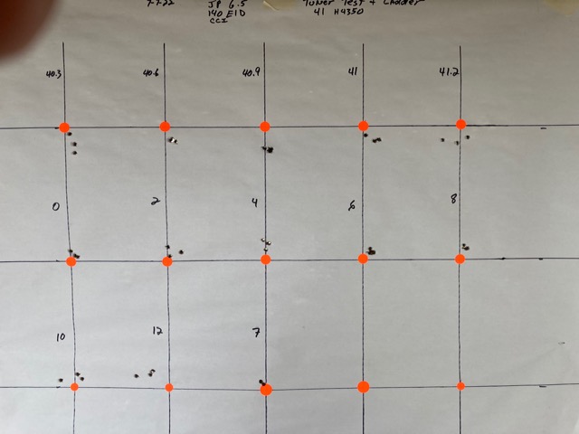

I recently bought a JP LRI in 6.5 CM. I did all the load development I could but due to the limitations of the magazine of the seating depth I had to stop at 2.814 OAL. It shot consistent .75 MOA groups but I knew it could do better. I really didn't like the 4 lb factory trigger pull so I replaced it with a Triggertech Diamond and set it down to 1.5 lbs. The groups got tighter but still not what I thought they should be. (I know the AR platform is more difficult to shoot)
So one day I happened to see a video of Eric Cortina tuning an AR10 with one of his EC tuner/breaks and thought to myself what the hell it might be what the Dr. ordered so I bought one. I really had my doubts, but after one tuning session I was impressed with the results. This is a picture of the tune: The top row was a quick powder charge test to see what the new tuner liked for a charge. Then I started at a 0 setting and increments of 2 I went to 12. As you can see it settled in at 6-8 and then started to open back up after that. I settled on 7. I think a tuner is a good addition to the AR platform.
Well sir from my experience it’s damn near impossible to replicate test results due to all the variables involved. I can say this from other tests (different charges) that it tuned very similar to the above test just at different settings.
Now, go back and redo the test and see if you get the same results... Not saying they don't work, but there is not enough data for a statistically relevant assessment in the test presented above.
And as a control, shoot the same amount of groups without a tuner.
I bet from a performance and statistics perspective that not much changes.
