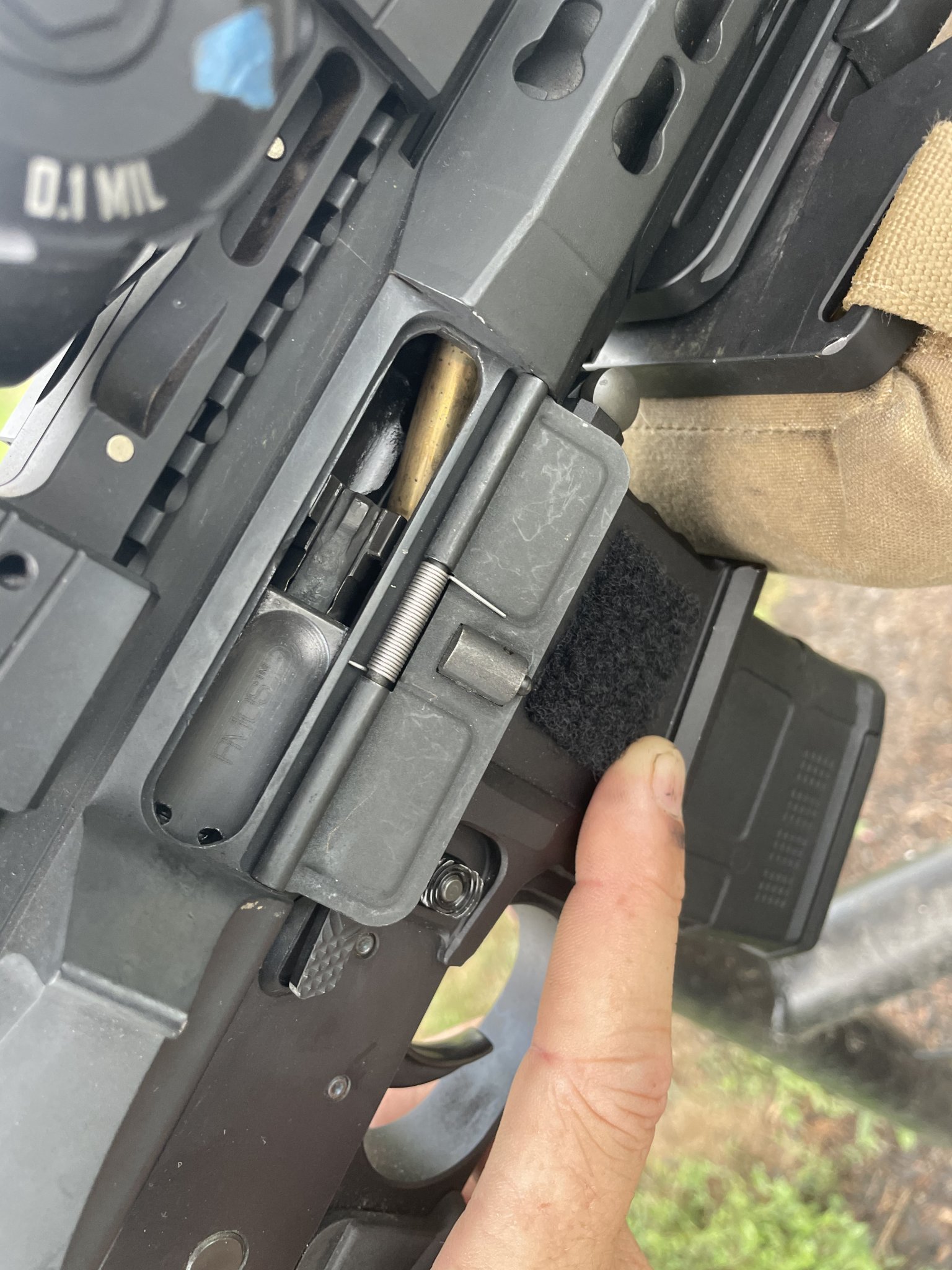

    Does everyone agree with this chart ^

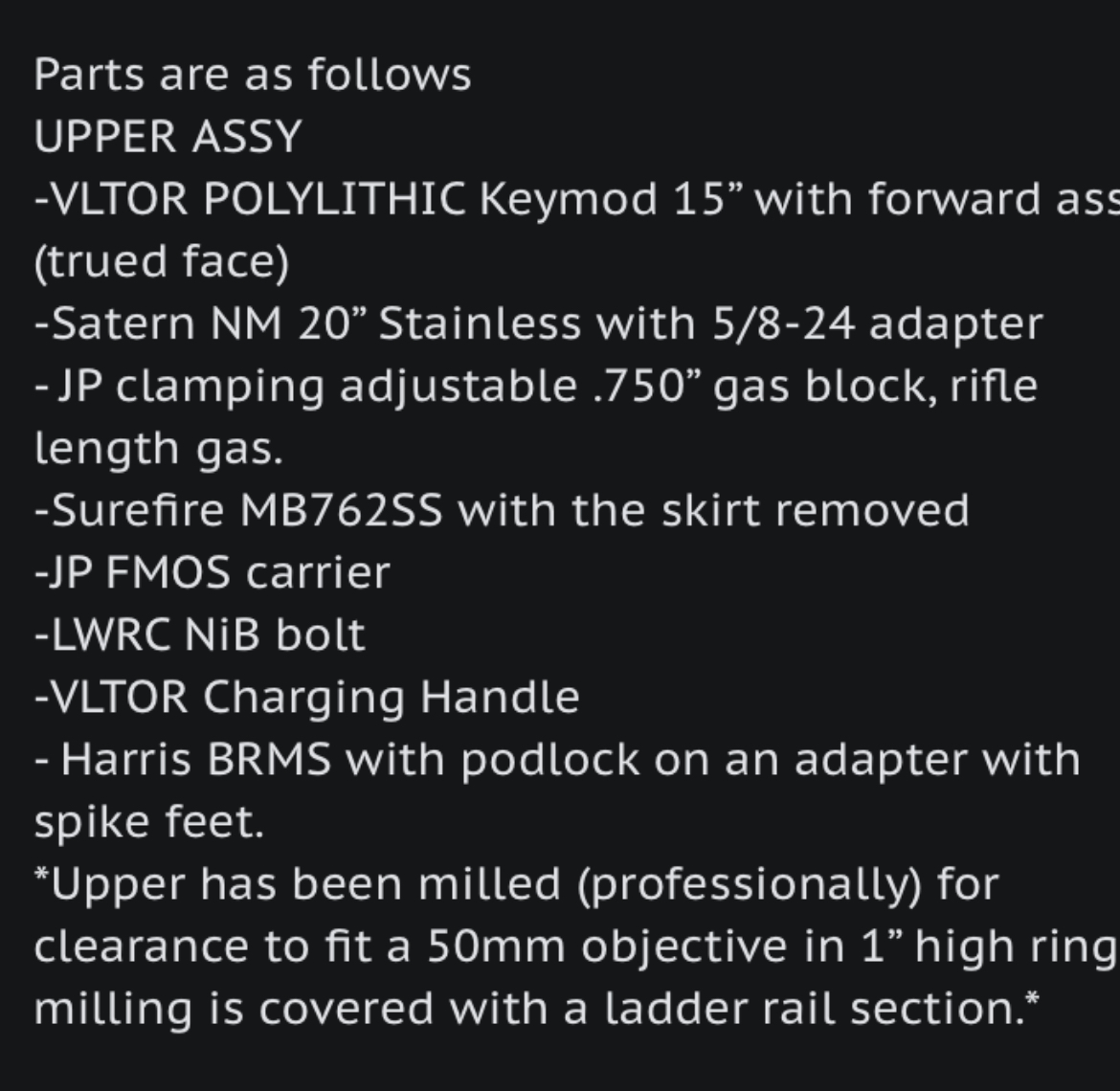

    I’m getting brass at 1-2 o clock to get the bolt to lock back
    Razor core 77gr
    Jp fmos
    20” barrel
    Tbac 338 ultra can.
    Jp gas block

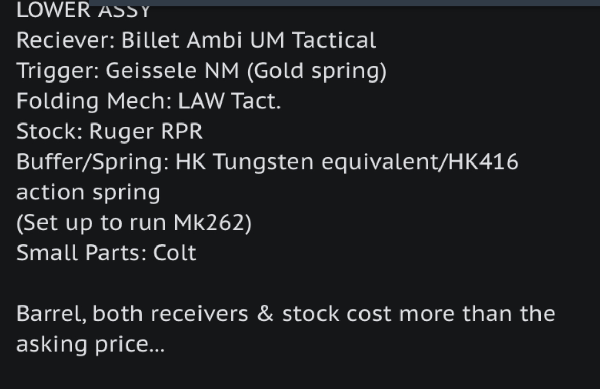

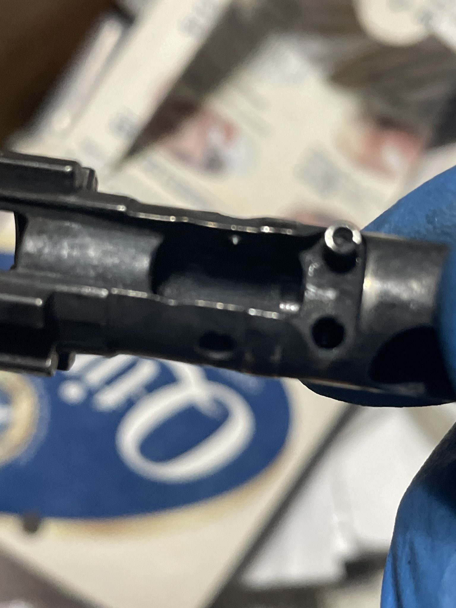

    Also. This gun I bought used. Finally tore it down to diagnose spent cases not ejecting and the extractor only has one spring ?
    Razor core 77gr
    Jp fmos
    20” barrel
    Tbac 338 ultra can.
    Jp gas block
    That’s most likely your extraction issues. I’d replace both with new.

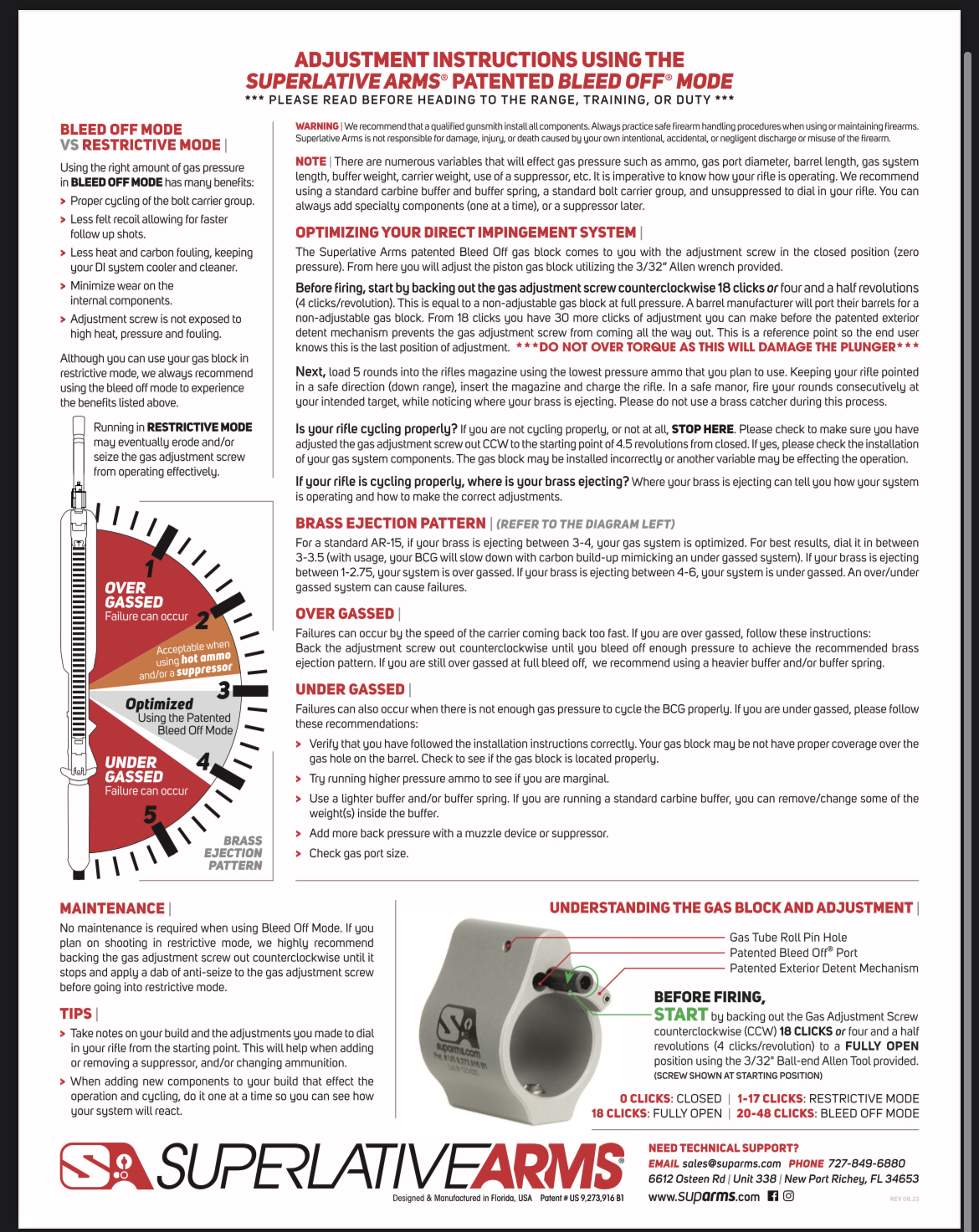

    That's all I do is just start out closed and open till it last Round mag. holds Bolt and give one more Clik of open.
    I got a few of the Superlative Adj.GB's .
    to the Law Folder .. I did experience a little Gas hinky BS on the last build I did this year. I almost had to open the friggin GB totally Open to Last Clik to get last Round hold open . On a 16" Mid.length 5.56 gas set-up . I actually had to remove significant amount of buffer weight to keep it 100% reliable.
    But .. I just chalked it all up to having added the Law Folder unit to the entire equation that FuckedUp my state of normalcy .
    If your extractor and ejector are not working 💯 that will certainly effect your ejection pattern.
    The chart is a guide but not law. When I build my own I go for what locks the bolt back with my can, then usually give it 3,5 more clicks to cover unsuppressed and reliability... My ejection is usually never 3 perfectly when I do this but it's usually the least amount of recoil while still bring reliable suppressed vs non
