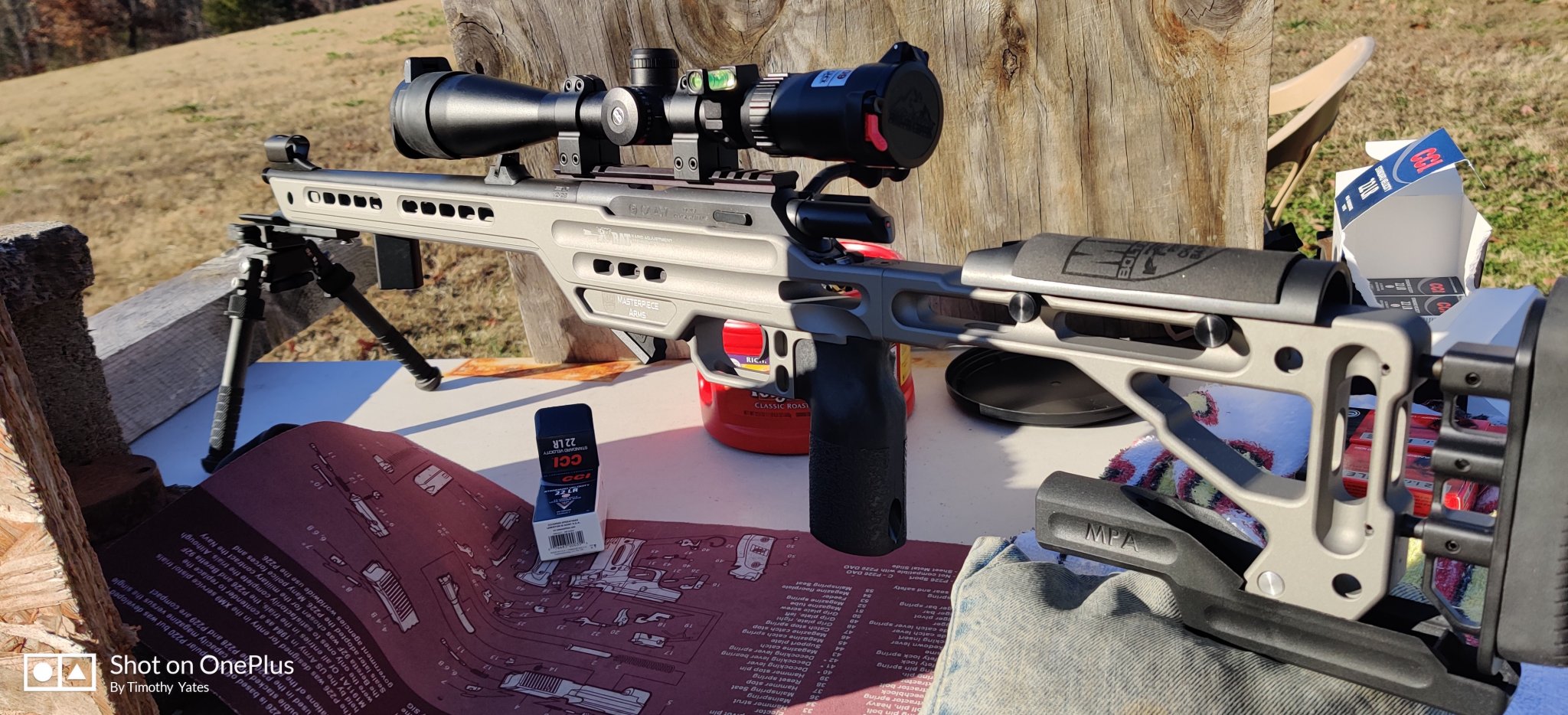

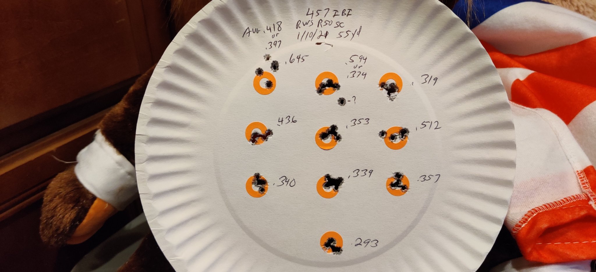

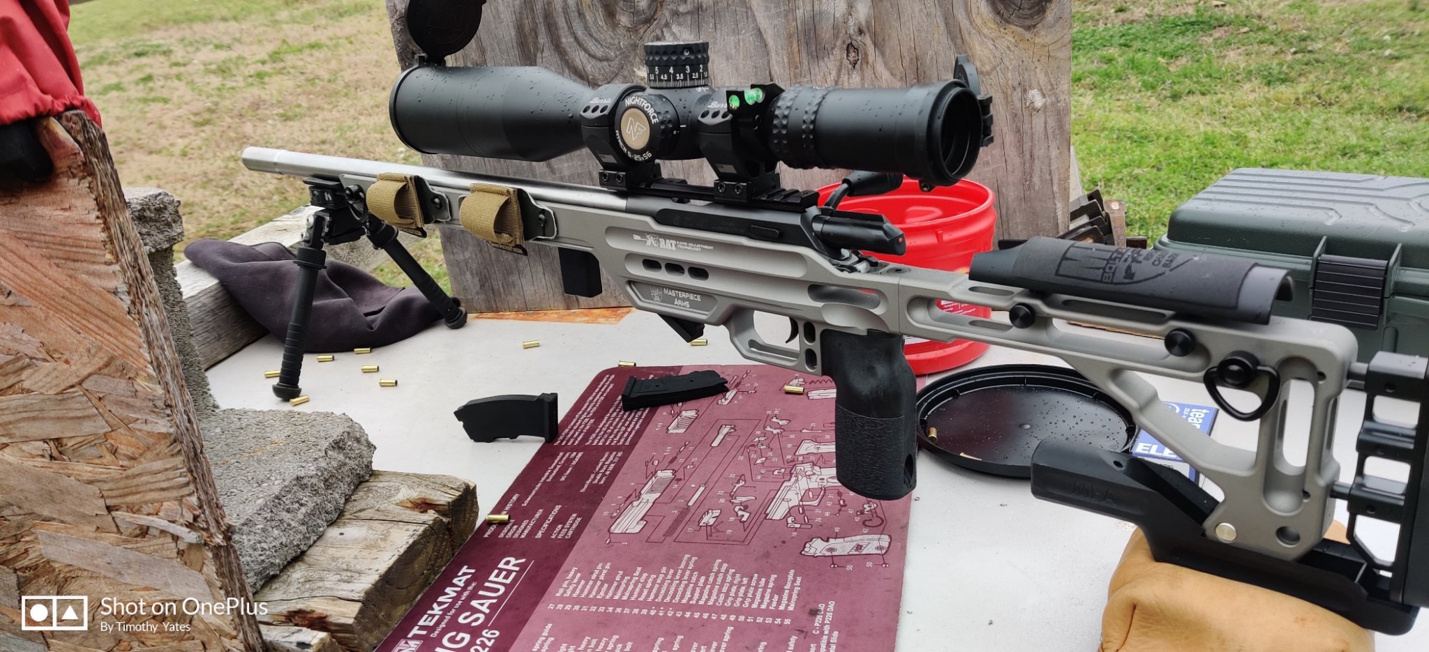

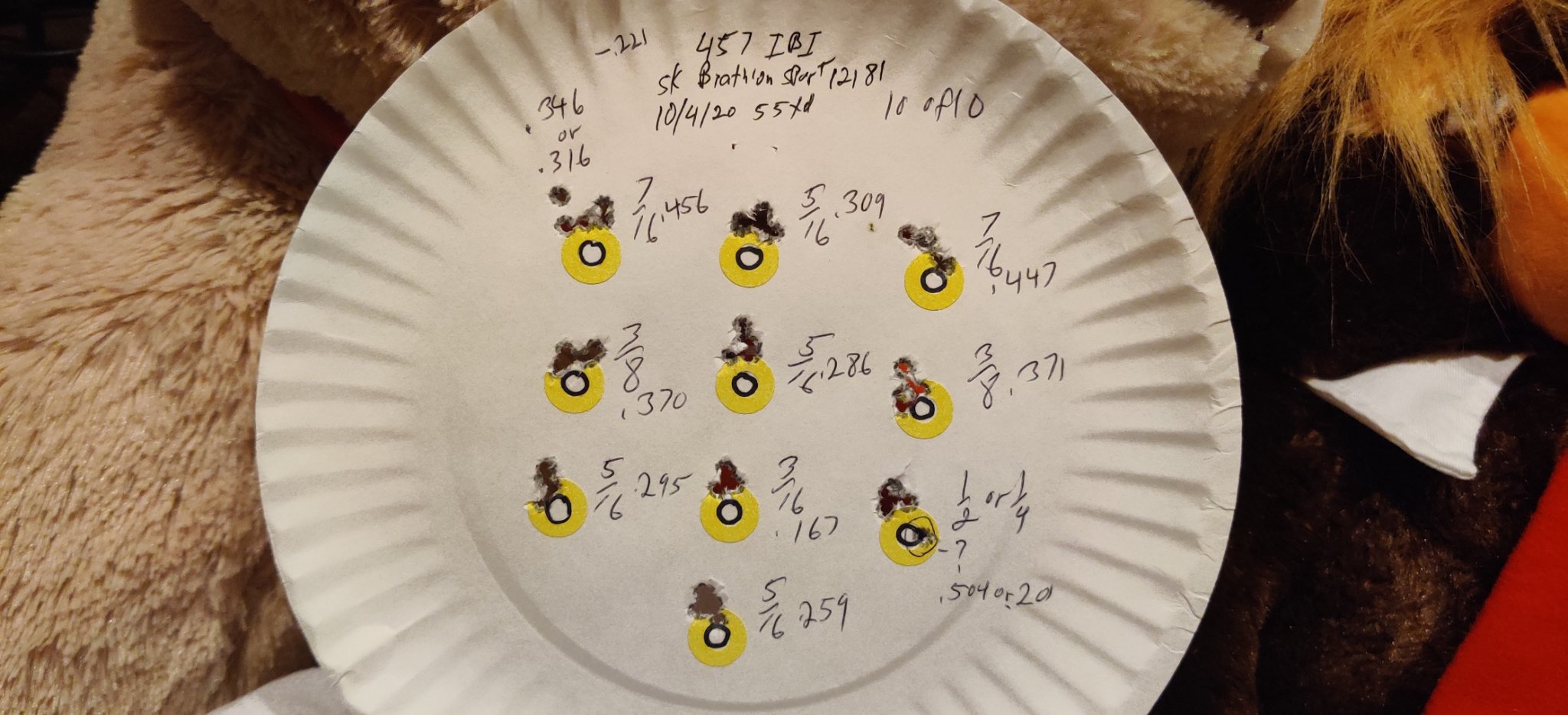

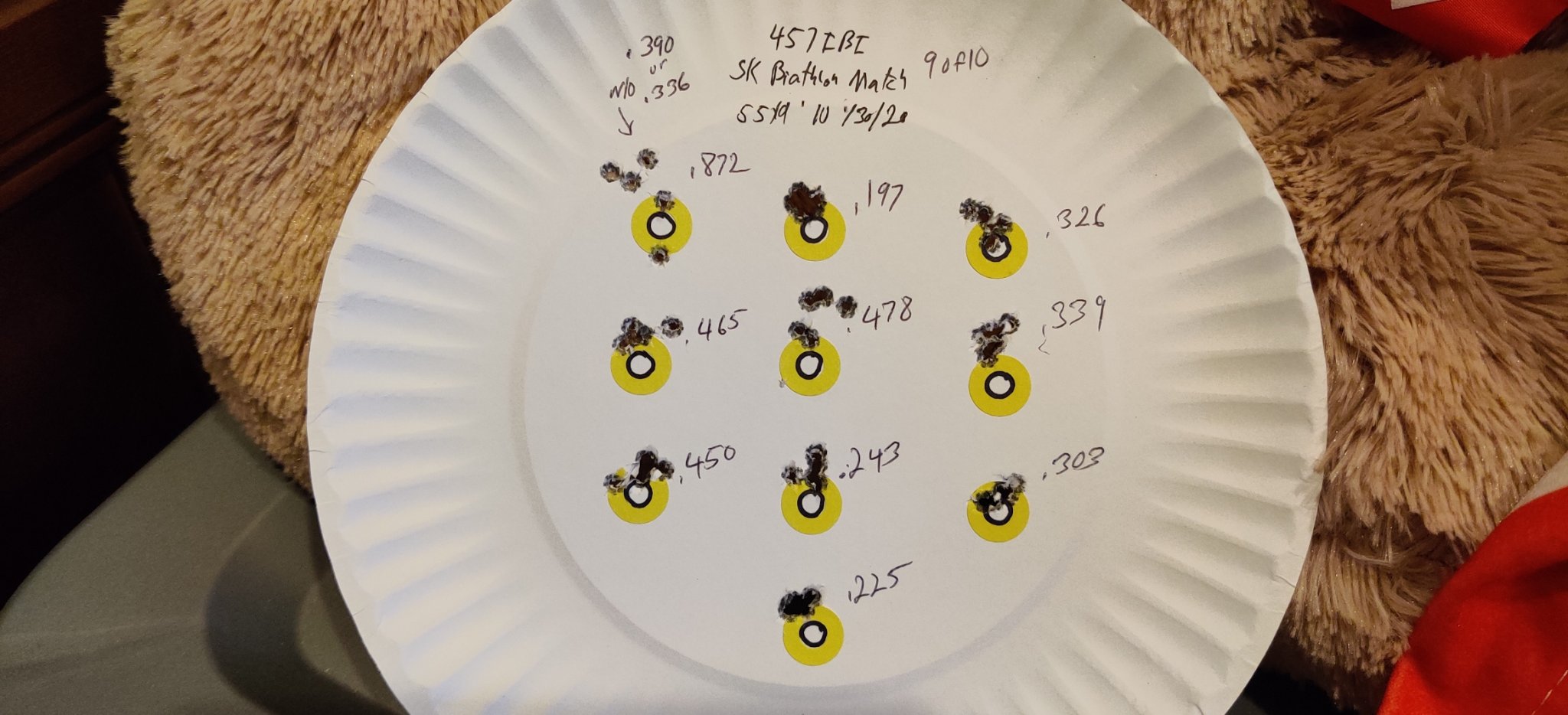

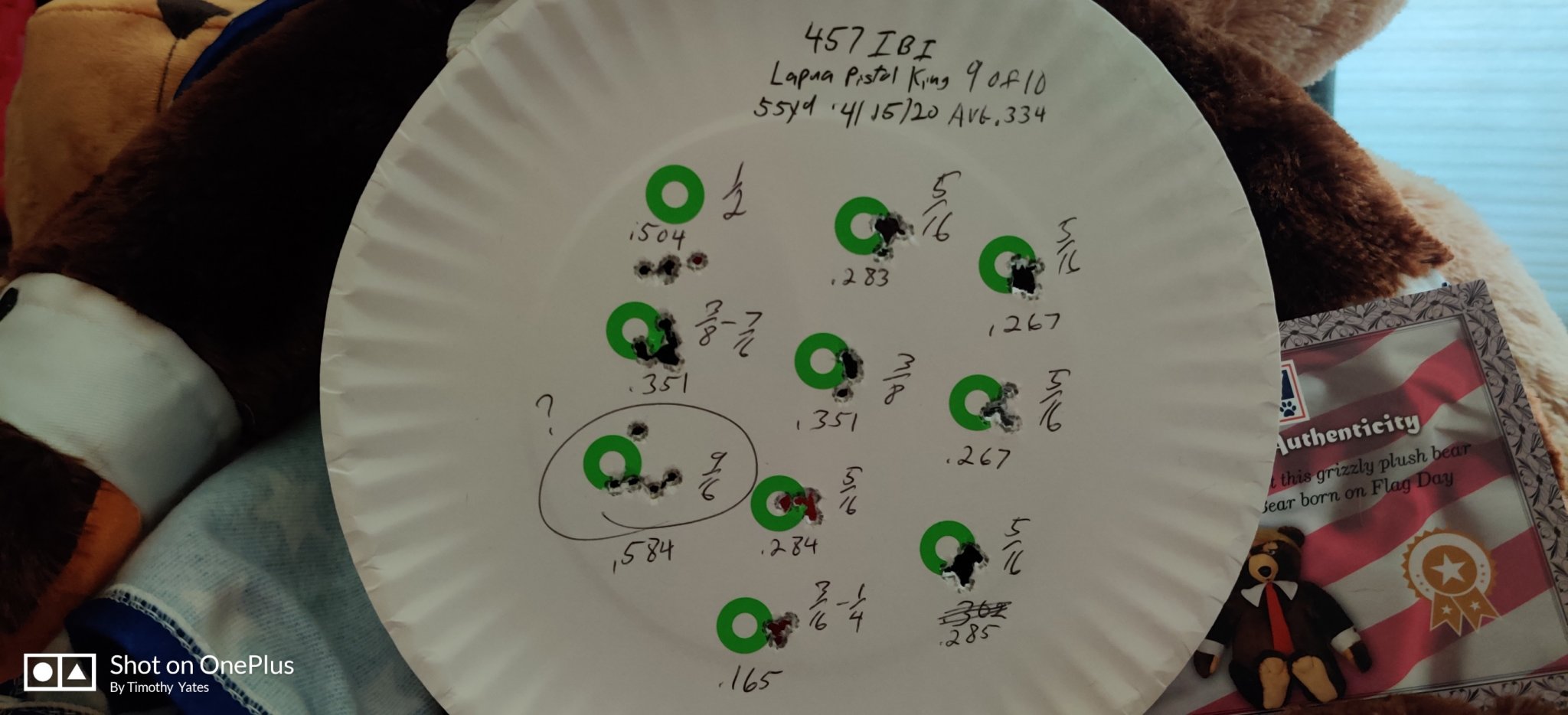

A year back I bought a 457 Scout model "$315 delivered" for the sole purpose of doing what are thinking about. Sold the stock and barrel, bought the MPA Hybrid chasses, IBI barrel, polished the trigger surfaces and lived happily ever after.
Shoots pretty good, I'm happy with it.

Thanks. I'm happy with all my "upgrades" on the 457 as well as my other rifles. With the Vudoo track record you can't go wrong with one of those either. Right now I have the Ultimatum Deuce on order. Honestly I expect it to shoot in the .300 - 375" range. If I had a Vudoo I'd expect it to shoot the same. Is either worth "that" much more than an "upgraded" 467? Honestly in my mind, no. Only reason I'm getting the Deuce is because they had a really good Black Friday special and I just wanted one. When the 60 degree bolt throw Vudoo comes out I'll get one of those too, not that I "need" it or think it will outshoot everything I have but because I like different things.

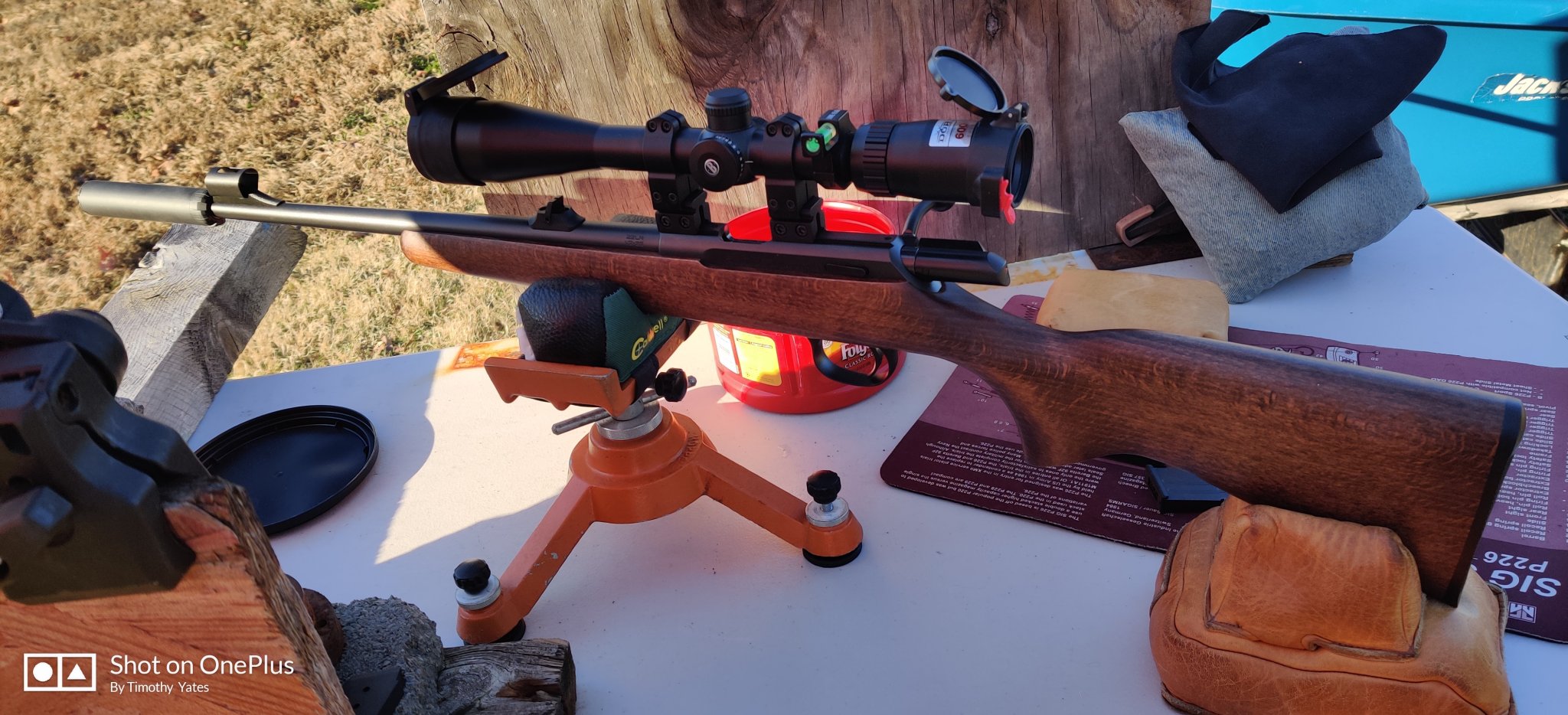

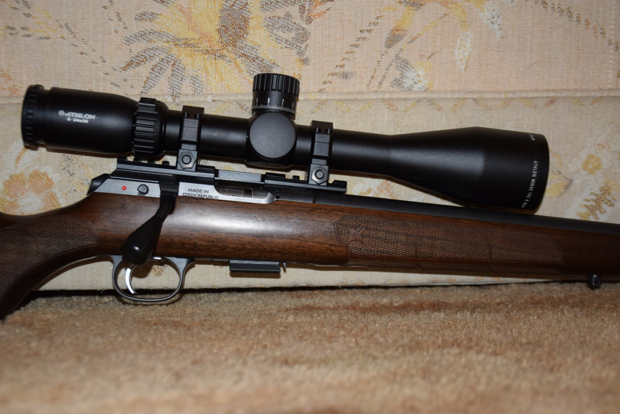

My 1st CZ .22 was a 457 American that came with a pretty nice stock - no fancy grain or figure, but very attractive. Was immediately impressed with how well it fed, extracted, and ejected, and also appreciated the fully adjustable trigger - very nice features (along with the bolt release) at the price point. But mine didn't shoot worth a damn at 50yds - not with any of the std vel match ammo I tried through it. I pulled the bbl & re-cut a fresh crown at the muzzle, as the factory had done a pretty crappy job of it - that helped a little, but still never got consistent 1" groups at 50yds.; was averaging over 2 MOA. Didn't want to send it in under warranty, as I was afraid they'd just replace it, and I'd lose the nice stock. So bought a Shilen ratchet rifled blank, parted-off the 1.2" shank, and did a very little contour work to finish it at 23" and a weight of 1/2lb more than the factory bbl. Chambered it with my EPS reamer, cut the extractor slots on the mill, then mixed some CeraKote graphite black & tungsten in an effort to match the factory nitrided action, then glued it in with Loctite #609, left it sitting overnight, and the next morning, I had a rifle that shot at least as good as it looks. Since CZ went with a threaded bolt knob on the 457, I heated the steel knob a bit with a Bernz-O-Matic torch, and it came off easily. Measured the threads, and turned an extended knob with the same general shape as a B-O knob, blasted & CeraKoted it, then loctited it onto the handle. The extended length reduced the effort of running the bolt, so was well worth it.
Eventually, I ordered in one of the 24" 457 VPTs with the Manners PRS1T stock, and after putting a few hundred rounds through it, thought it was shooting ok at 50yds. Groups at 100 were acceptable I guess, but when I backed off to 200, I couldn't keep 10rds on an 8" plate. Compared to the custom .22s I've built for myself over the past several years (Stiller 2500XR/Krieger, 40X/Benchmark, 40XB/Lilja titebore, V-22/Krieger, RimX/Bartlein), it just wasn't acceptable, so another Shilen ratchet rifled bbl was ordered & installed, and now it's a very decent shooter. Yes, I'm spoiled by the upper tier customs, but who wouldn't be? Once you find out how good a really good .22 shoots, you're kind of ruined for rifles with lesser accuracy. I've kept both these 457s because I really appreciate the way they run and the features of the actions - and with custom barrels with very good chambers, I don't feel the need for making excuses for them, even when they're compared to full custom builds using the above mentioned actions. But would I have paid to have someone else up-grade the 457s? Would've been a tough call, although I really enjoy having the American with it's pretty stock, and the VPT's Manners stock is much appreciated too. And I would guess that my experience with lack of accuracy of the OEM CZ bbls might not be typical - you might get a pretty decent bbl on a 457. But it's a roll of the dice, and there's no telling for sure. If you go into the purchase of a 457 knowing that you might have to pay someone to replace the bbl, are you better off than buying a Vudoo in the 1st place - especially if you have an aftermarket M700SA stock that would work on a V-22 bbl'd action? I think not.
