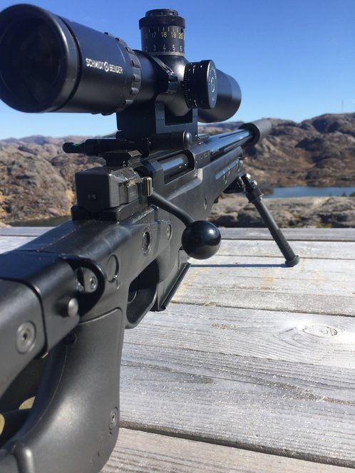

Hi Everybody,
A question about twist rate:
I will be buying a 32" Barrel for my AIAW 338 Lapua M. and will be shooting Lapua Scenar 300 grs bullets. The goal is to hit a plus 2 KM (1,24 Mil).
The normal approach would be to go 1:10 in twist rate since that is recommended by the bullet manufactur on the bullets reloading guidance however; Bryan Litz recommend 1:11 in order to achieve a SG of 1,5.
So the question is; what speaks for getting a higher SG then 1,5?
I know that the BC G7 will benefit a 0.001 for each 0.1 the BC G7 goes higher than a SG of 1.5 according to Bryan Litz.
I was hoping someone in here would know if there are any valid data supporting getting an even higher SG than 1,5 when passing though transonic and flying in subsonic.
Hope you all will help me out, if you have any qualified knowledge on this.
Br
Christian
(from Denmark)
