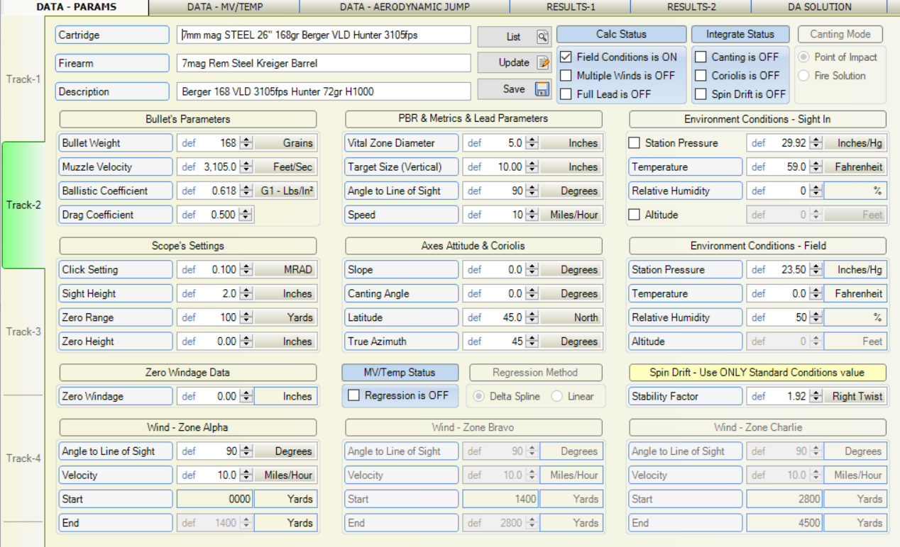

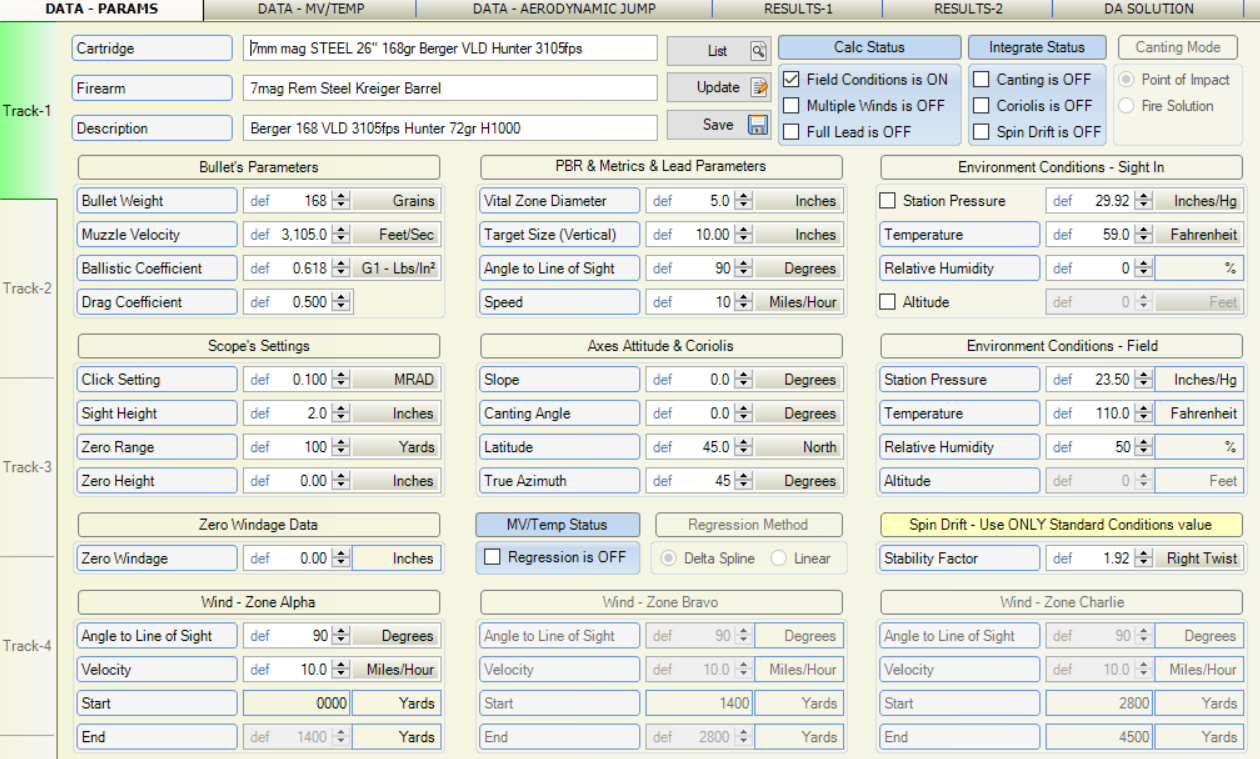

I'll print out a 110-degree swing at 100 yards, using the muzzle as pure muzzle drop. ie zeroed at the muzzle. The delta is rounded so it's less than <0.1" which's still a single bullet hole hardly detectable or even relevant for that matter. Note that Drop is what the bullet is doing, the path is what we dial. I included 1000 yards as a reference point so you can indeed see DA has an impact at long range, but other than an academic, not in play for our fast high bc rifle rounds.
DIST
yards
TRACK - 1 Wyoming House 110 degrees
MRAD
TRACK - 2 Wyoming House 0 degrees
MRAD
TRACK - 3 Sea level CA House La Honda 70 degrees
MRAD
TRACK - 4 Wyoming House 110 degrees
inches
TRACK - 5 Wyoming House 0 degrees
inches
TRACK - 6 Sea level CA House La Honda 70
inches
100 DROP-0.5-0.5-0.5-1.84-1.871.88
1000 PATH6.06.67.0-203.4-223.9-234.7
1000 DROP7.07.78.0-240.1-260.6-270.4

Ok, let restate what you said in a simpler way. instead of using Death Valley and Everest.
1. you have a DA delta of only 2,000'​
2. you said you need .1mil or .36" to reestablish our zero.​
I gave you an example of over 12,500' DA delta with less drop differential than you can adjust for. I really think that covers most anyone's realistic usage parameters without using airline cruising altitude.​
Here it is in DA -- BTW stop using DA it will over complicate our head. Use station pressure.
Here is the above restated in DA. IN both these example the gravity drop is rounded to -1.9" on my 7mm @ 100 (run on Coldboare & AB analytics)
Ca House
  • temperature: 70 deg f
  • uncorrected barometer: 29.920 Hg
  • humidity: 50 %
  • vapor pressure: 0.739 Hg
  • dew point: 50.478 deg f
  • grains: 54.5
  • air density: 96.899 %
  • density altitude: 1,074.379 ft
Wyoming house​
  • temperature: 110 deg f
  • uncorrected barometer: 22.5 Hg
  • humidity: 50 %
  • vapor pressure: 2.599 Hg
  • dew point: 86.792 deg f
  • grains: 262.0
  • air density: 65.823 %
  • density altitude: 13,636.917 ft
Why is this so?
Drop is a function of gravity exposure (time). Gravity is acting on the bullet constantly and pulling it down immediately as it leaves the barrel.
Drag is a far more complicated mix of speed, shape and affected by air density. The caveat with drag is that it takes time to effect change to actually slow the bullet.
The 100y TOF is 0.099 seconds with a velocity of drag influenced FPS of 2942.8 vs TOF of 0.099 but drag (DA) influence a higher velocity of 2984.8. (you need to note that the barrel node is the same for both, while certainly is some TOF difference it's too small to deal with). Yes, the calculators are tracking and round the math, so the true gravity drop might be reported as a delta of .04", I'm mean that's not even 1/2 a 1/10th of an inch or 10x smaller than you can adjust your mrad turret. If you shot a group that tight you might assume all but 1 bullet grenaded in-flight LOL.
Since gravity needs time (seen as distance in our shots) to create drop and because the TOF is so close to each other at 100y, we see no perceptible elevation change at 100 yards. This is one of the main reasons 100 yards is the preferred number over something like some hunter's 300-yard zero's and some BR guys 600+ yard zeros; plus it's all holdovers, not a mix.
If I took my same fast 7m and use a 300 yard zero (3x+ more time for drag to work) I would need to enable zero conditions on the solver as the above example would result in -18.1" drop vs 17.6" drop or adjust .1mil for the 300y zero shift. Slower and lower BC bullets will have more drastic results, as would the guys with 600+ yard zeros.

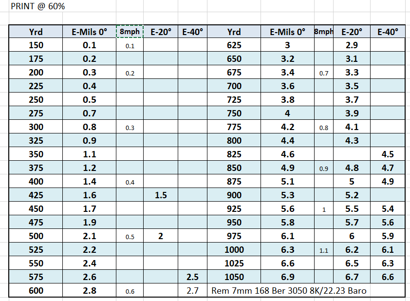

Last takeaway - You never know when you tech is going to bite it. Always carry a drop print, the best strategy is to look at the entire trend of the drop and where those numbers aren't bouncing back and forth. Don't get too focused on the individual drop numbers even with 20 almost nothing and with 40 degrees of temp shift out to 600 or so. The calculators are rounding, so what might look like a change is sometimes only a shift between 2.34mils and 2.35mils, reported as 2.3 and 2.4 or whatever.
Here is an example of my hunting card from the last Elk Hunt, printed on my sidewinder. 3x5 2 sided folded over. The wind is shown in FV and only at the wind brakes.
