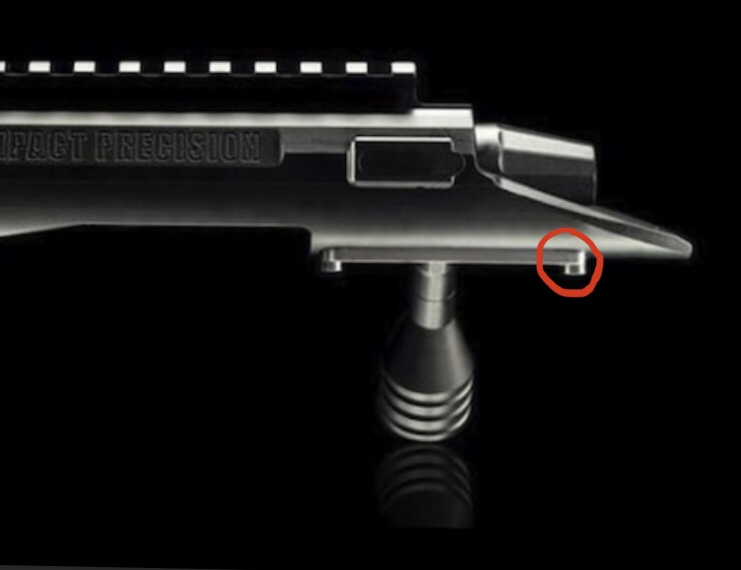

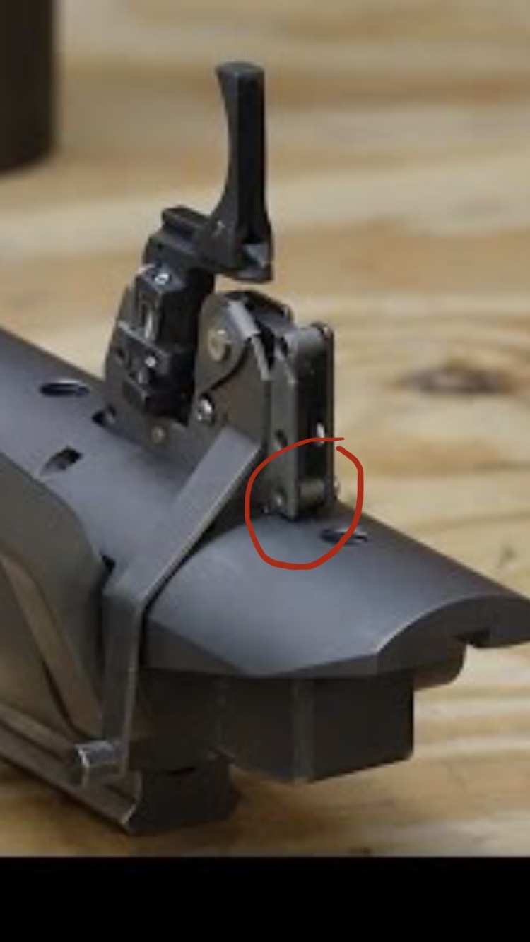

    The one that bolts to the bottom of an Impact 737.
    I wound up getting rid of my T7T because it was not able to work with the Impact. The tail end of the trigger, when installed in the hanger, does not allow the rear of the hanger to be bolted onto the action.
    Got any pictures?
    Who makes the Impact ?
    Circled is the rear bolt which holds the hanger to the action. The rear of the T7T prevents access to this bolt & in turn, does no allow the hanger to be installed in the action once the T7T is in the hanger.
