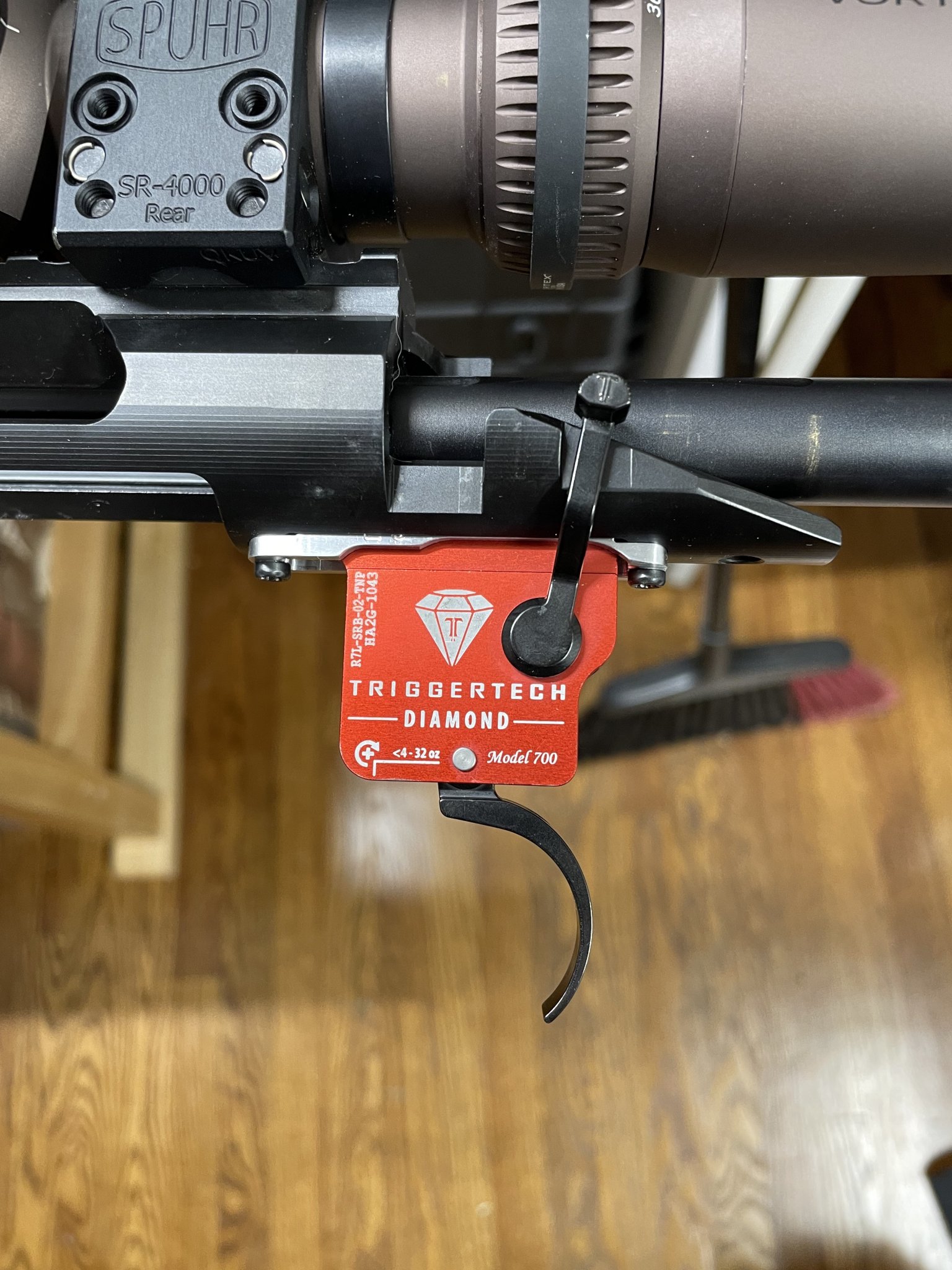

I hope this doesn't come across as insulting. Can you post a pic of the installed trigger. I have seen people install triggers in Impacts with the hanger upside down that has lead to trigger issues.
This might explain two different brand/design triggers having the same issue.

Sure thing. I would be very happy to be wrong and I have been wrong many times before. This is a left handed action just to remind.

Looks correct.

Thanks for the pic. Just wanted to make sure.
