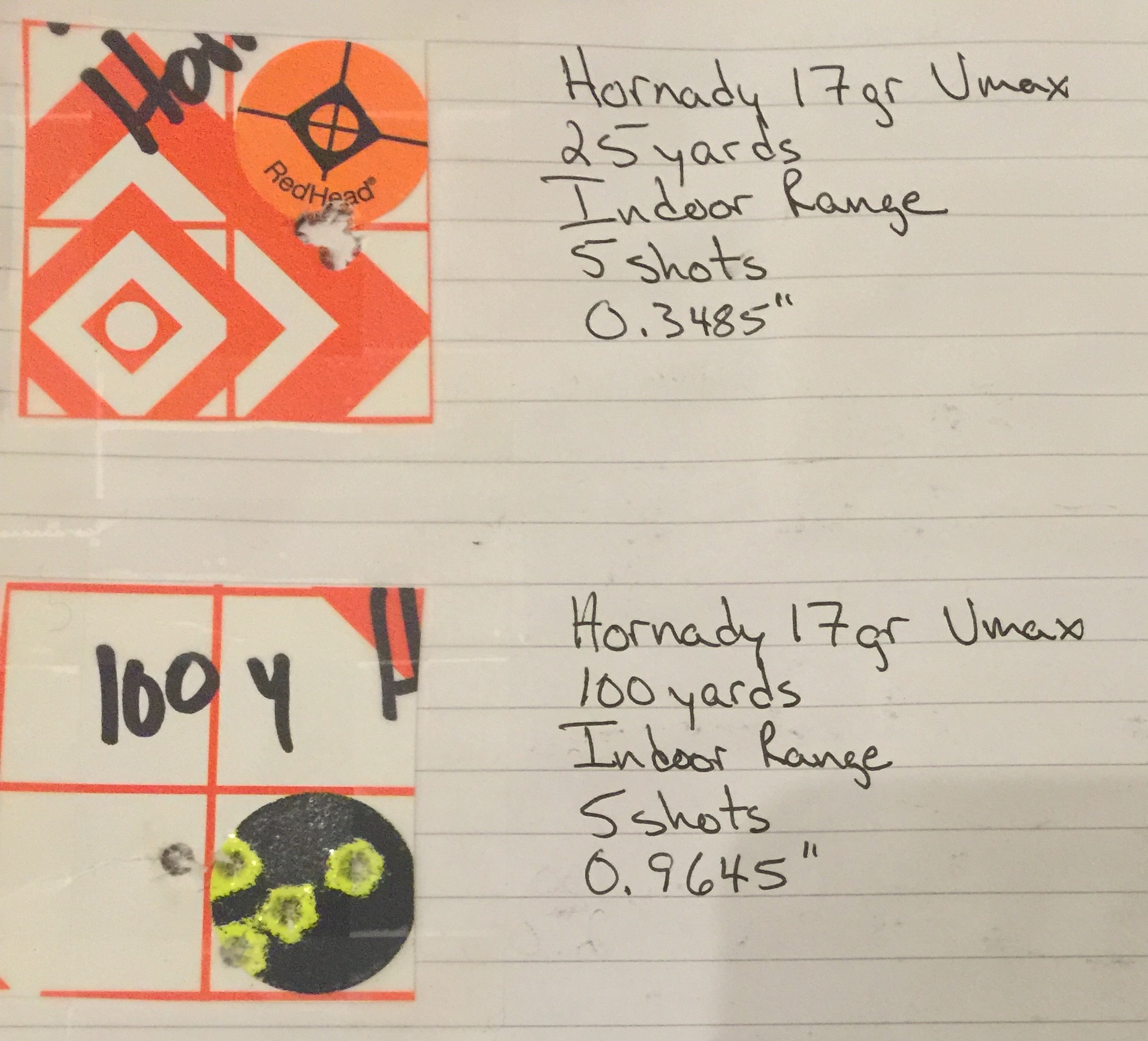

My Ruger American Rifle Target Model using Hornady 17g Vmax at 50yds using bench and bags outdoors with swirling winds 3-6 mph. This was shot during initial break in, it's gotten better based on it's performance in the orchard with 331 Grey Diggers KIA'd.

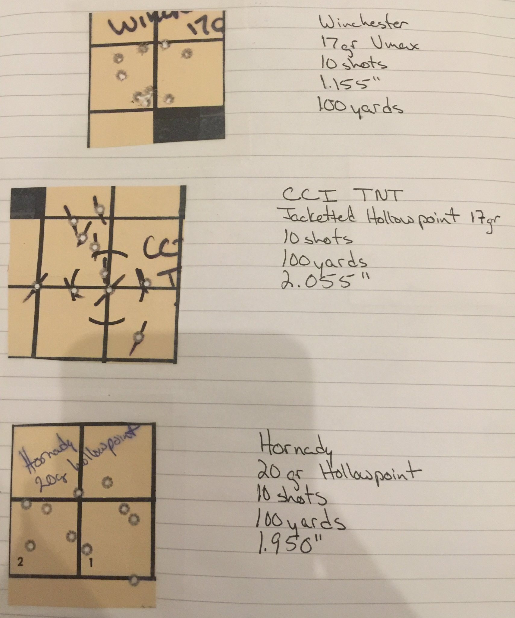

Here are some groups from some ammo testing I did several years ago... Measurements are edge to edge and include the bullet diameter. Outdoor testing was not done on the same day as the indoor testing, but with the same rifle. Marlin 917vs, Cabelas 3-9x40 scope.
Maybe the groups could be tighter, but- honestly- it does what I need it to do...

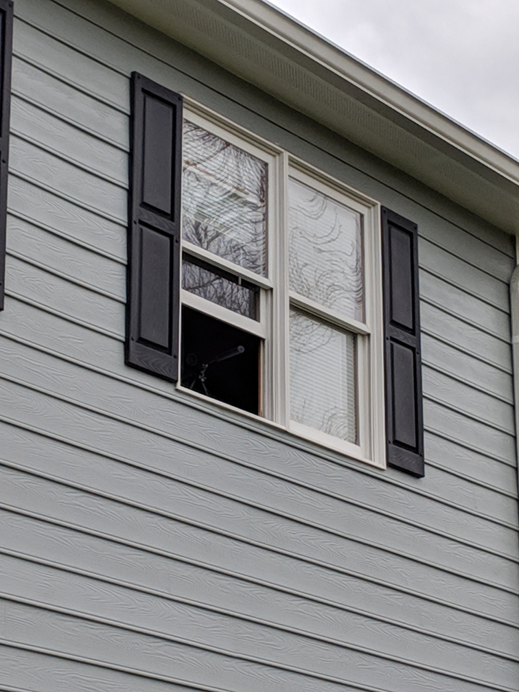

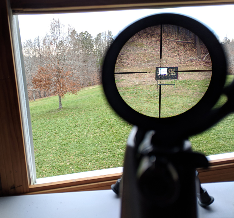

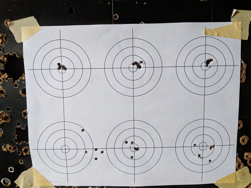

Today was pretty nice and I had some time so I figured I'd try a few at 50 for you.
CZ 455 sporter (nicknamed "the laser") Weaver tactical 3.5-10, Hornady 20 XTP
I suppose I could do better at 100 with more scope, but this thing is mostly a corner rifle for unwanted guests.
Typical? I don't know. I sold the Anschutz when I got this one.
Top row 50 / bottom 100
Had a little bit of wind to adjust for
the perch
Maybe it's just my eyes. I used to be able to see much better at 10X/100
#needsmorescope
