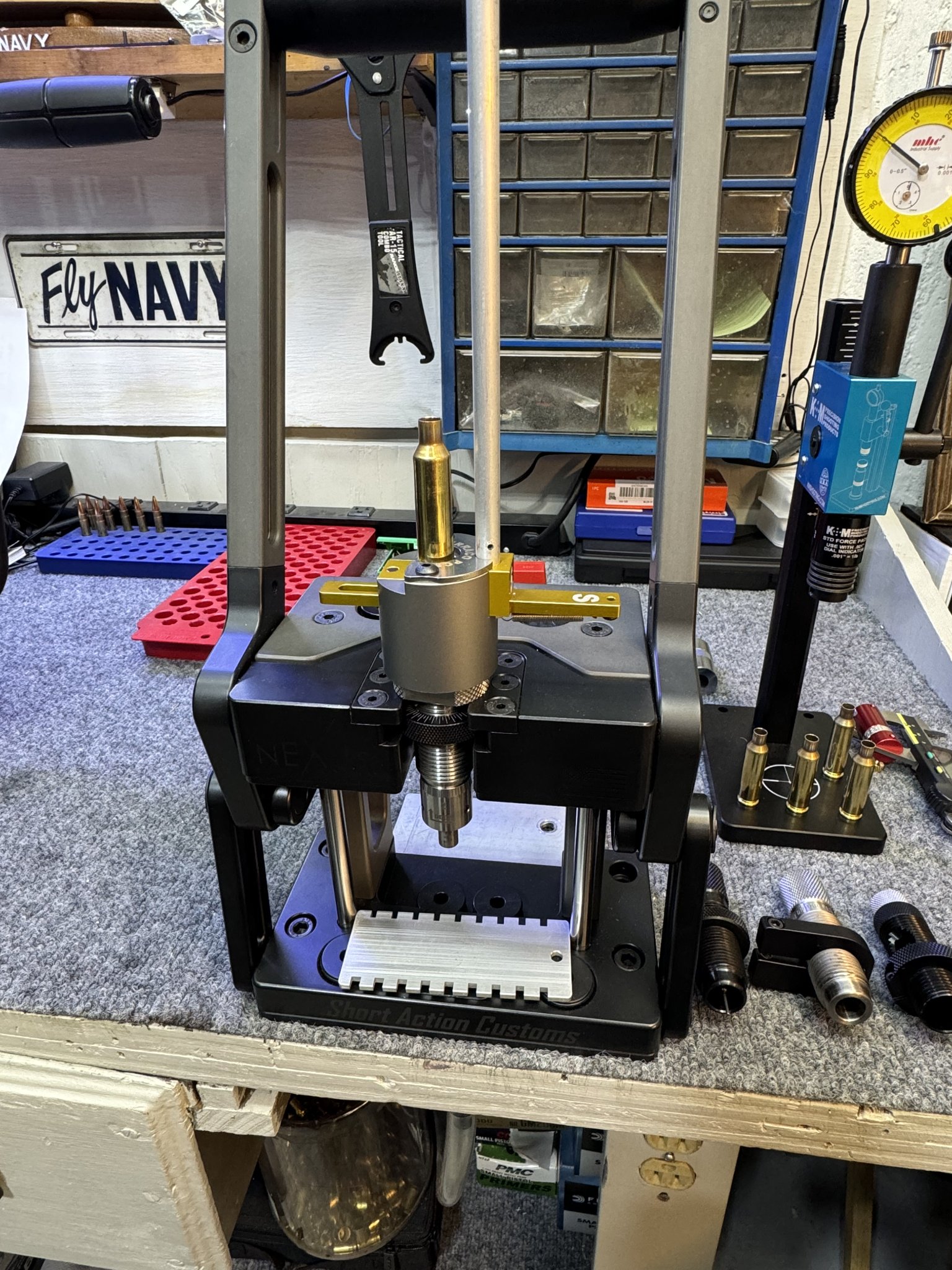

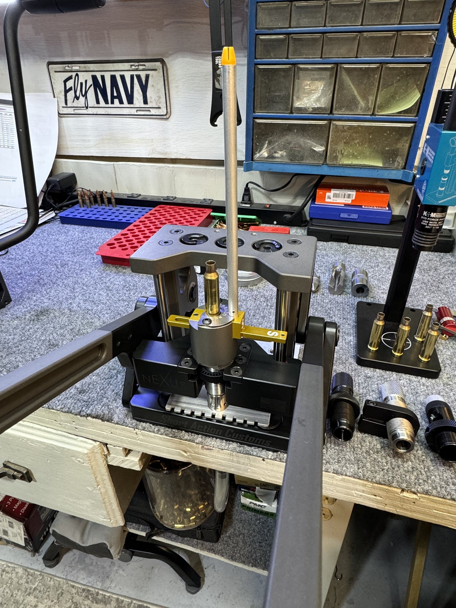

I asked SAC if the Ugly Primer Seater would work on the NEXUS. They said no. Well, they were wrong. I couldn't find any info on the web where this was attempted before so I just did it myself. I cut a primer tube in half to fit under the handle and just fabricated a piece of aluminum plate to sit over the Nexus case holder. Works like a champ. I will be making a more permanent plate that will have pegs that slip into the spare cam stops holes, just to hold it in place.

Yes, it can be made to work. But the ergonomics are very questionable compared to a press design way more favorable and affordable.
I'm using the Nexus to reload, not just for priming. When I do get to priming step, it's simple, die holder with UGLY slips in, ergonomics to prime are easy and smooth.
