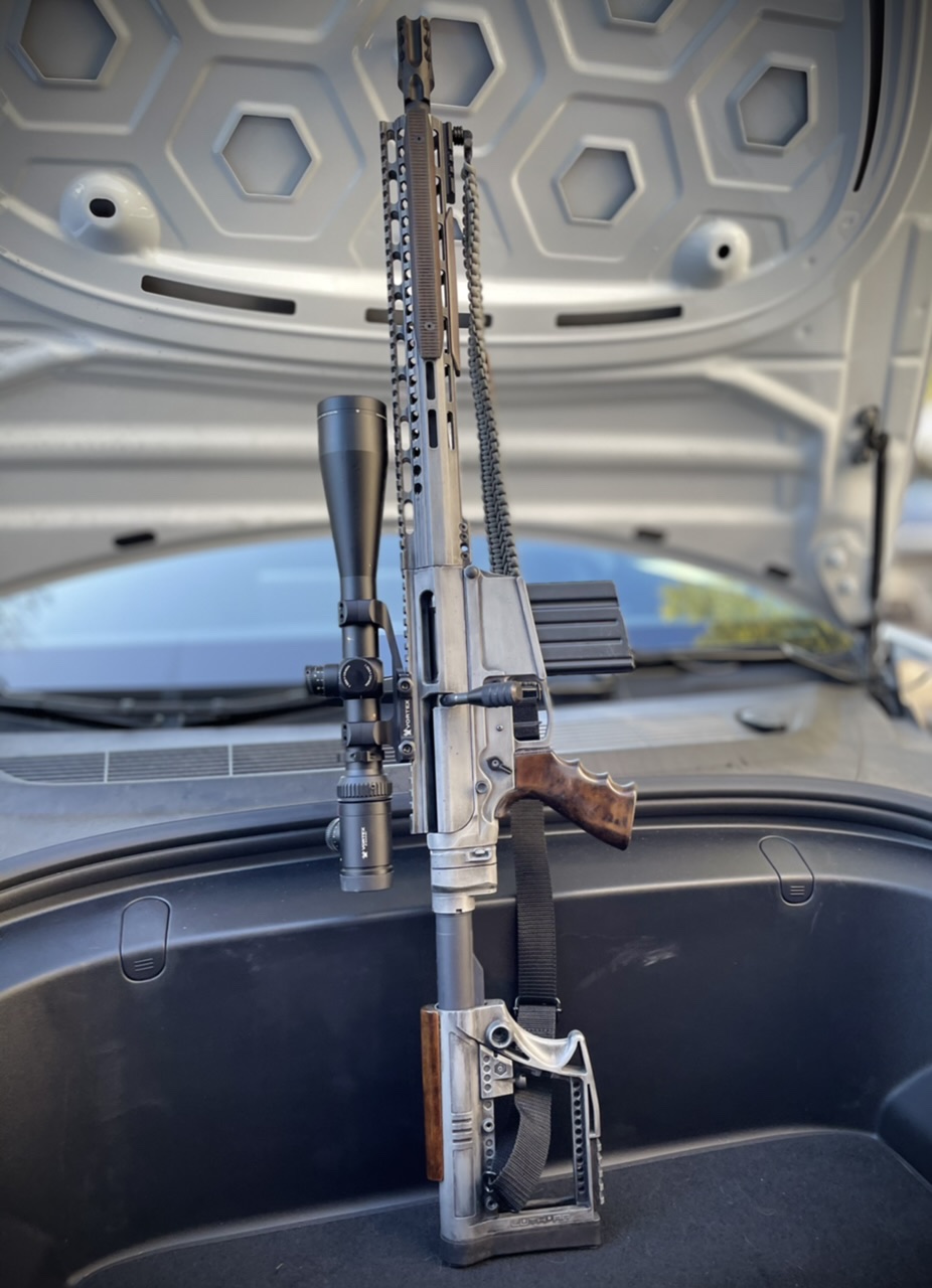

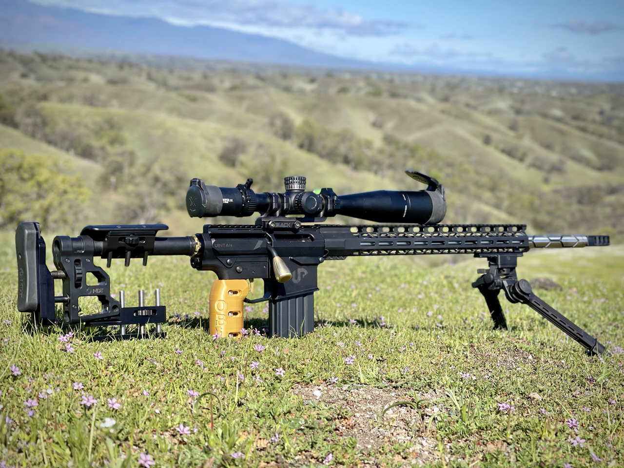

I have three and love them all, they are built very very well. I took my 6.5 creedmoor up to 3050 FPS with the 153 atips on a preasure test had it held up beautifully.
all of them shoot under .5 moa, snd they all have no problem Being very consistent out to 1 mile. (Even the 224 Valkyrie)
They action is actually pretty sweet, I can run the bolt faster and smoother that me blueprinted r700 action and savage action.
The only con I can think of is you are limited to the sr-25 mag length. So the best coal you can get on your reloads is 2.860 with the ar-10 version.
I think I’ve seen one of the above users mention his feeding issues before. But I think he is the only one that I have seen had issues with it.
my the 224 and the 6.5’s feed awesome in all my mags.
