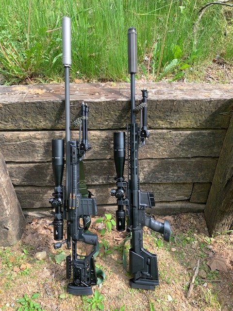

The Uintah is on the right. I don't regret my purchase and it is one of my favorite rifles to shoot.
