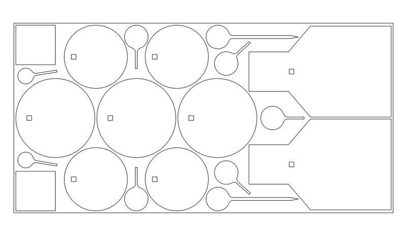

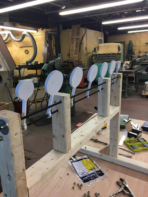

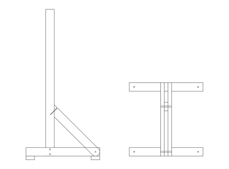

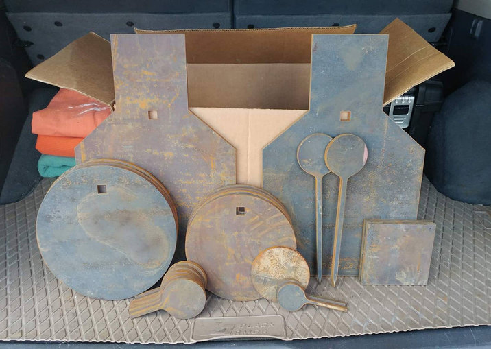

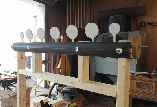

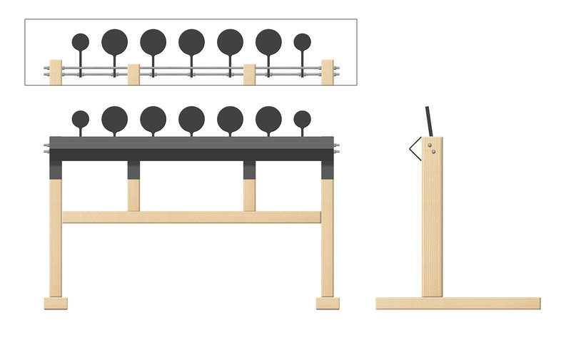

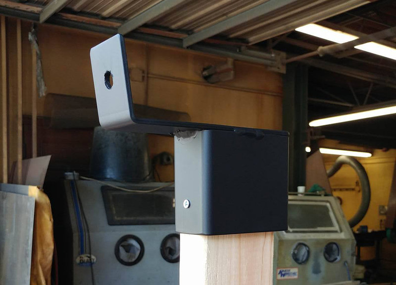

    I recently built a bunch of steel targets for my private range. I ordered a 2'x4' sheet of AR500 from a local distributor and then reached out to a local machine shop and rented some time on their waterjet. I built some simple frames from common lumber and welded up some mounting "hats" from mild steel using 2"x4" bar stock and some 3/16" x 2" flat stock.
    All in, I think it cost me about $600 plus a solid 8-10 hours of build time to produce about 10 targets than can be setup in a multitude of configurations.
    I attached a few photos from the various plans that I drew up as well as some of the in-progress pics during building. I am heading up to my range this weekend, so I'll take some more photos of the final products all assembled for you.
