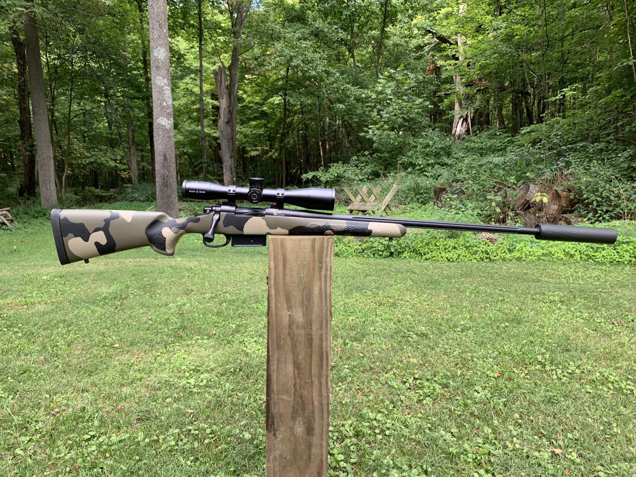

In my original post I decided to go with a 25sst because I havent left the state of missouri to hunt and so I can take 5-10 handloads with me when I go out deer hunting. I like the 25sst because its fast and has more than enough energy for longer range kills if I want to kill one at 700-800y. Alot of you have mentioned a switch barrel setup but really any rifle is a switch barrel if you have a barrel vise and action wrench. If it's a shoulder barrel then it can be spun off and another barrel be screwed on pretty quickly.

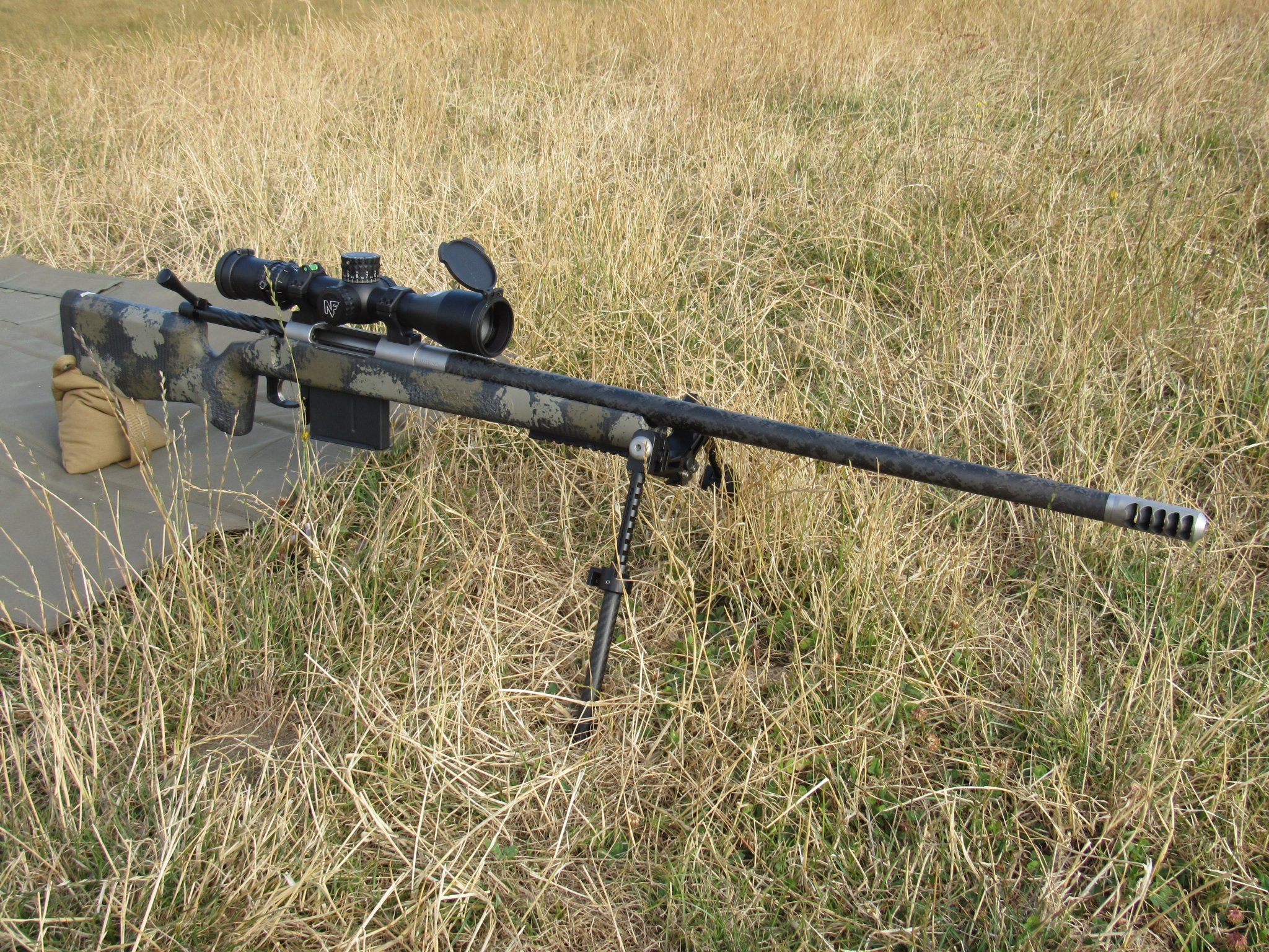

In addition to my first post, I sent 700SA to LRI for their “Stage II” Blueprinting. Had a Brux #5.5 bbl chambered in 260. Bbl is Fluted. Stock is Manners MCS SL. Trigger is Rifle Basix set at 2.5lbs
This has made a good very accurate hunting rifle. If I had to do over, I would go with a smaller taper bbl, and would chamber in 7mm-08. Would stay at 22” finished cause it is a Hunting rifle

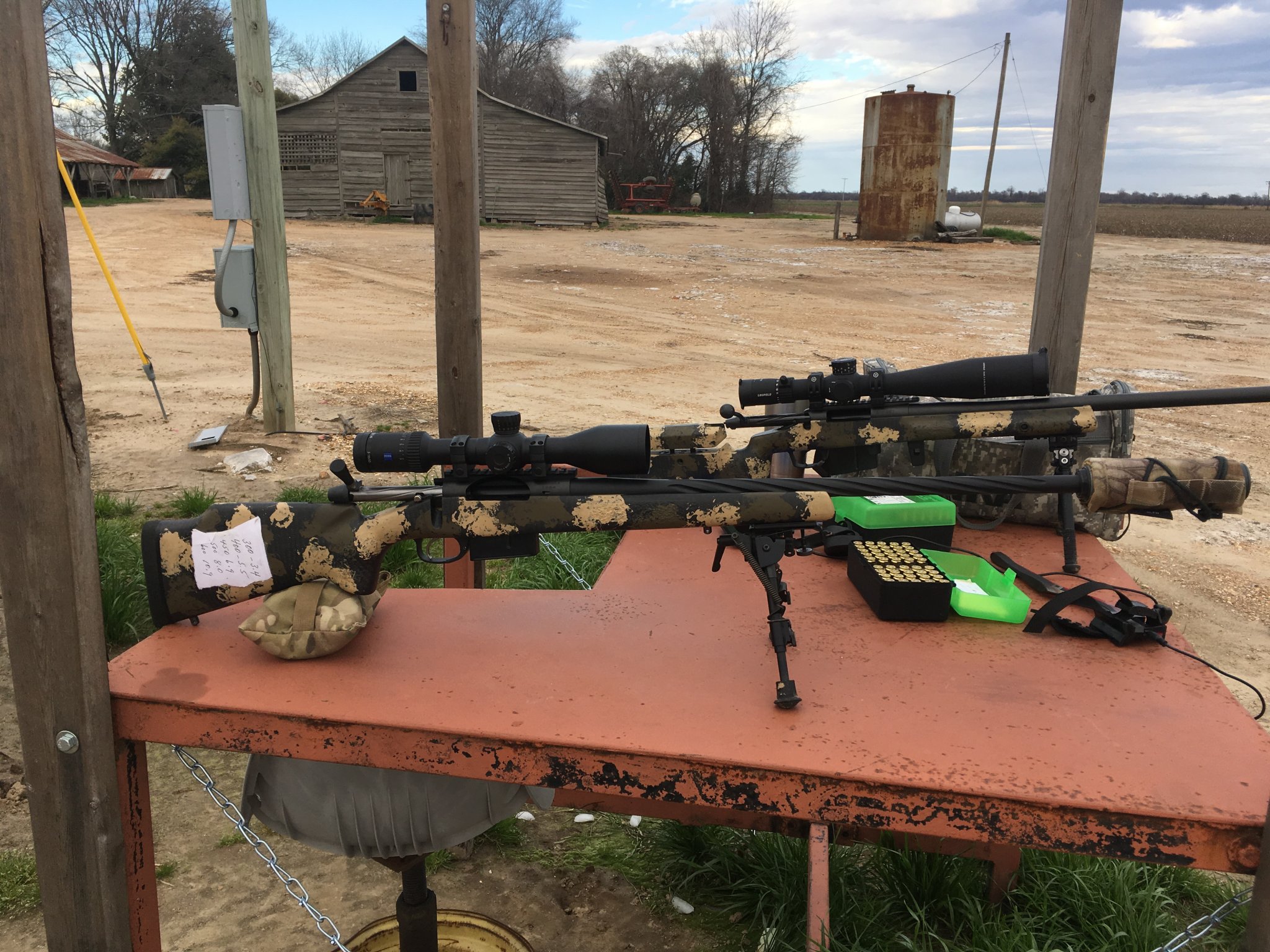

Here are two medium weight hunting rifles dad's i had Mark at SAC build and mine that David at Deep South Tactical did. Both are roughly 9lbs without the can and bipod and 11lbs when loaded. The exception is i feel my rifle balances much better due to the proof. Love both of them though.
As for the build i just tend to lean toward medium weight than featherweight/ultralite rifles. I get the purpose but i like to have range sessions with my stuff as well. Not that it can't be done with light weight hunting rifles. It's just not that comfortable to take a 7lb magnum out to the range to go bang steel. Currently what i'm planning looking like this.

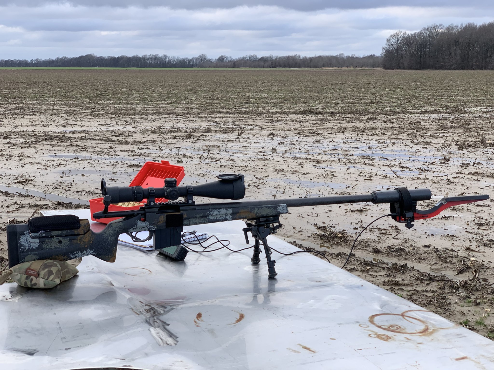

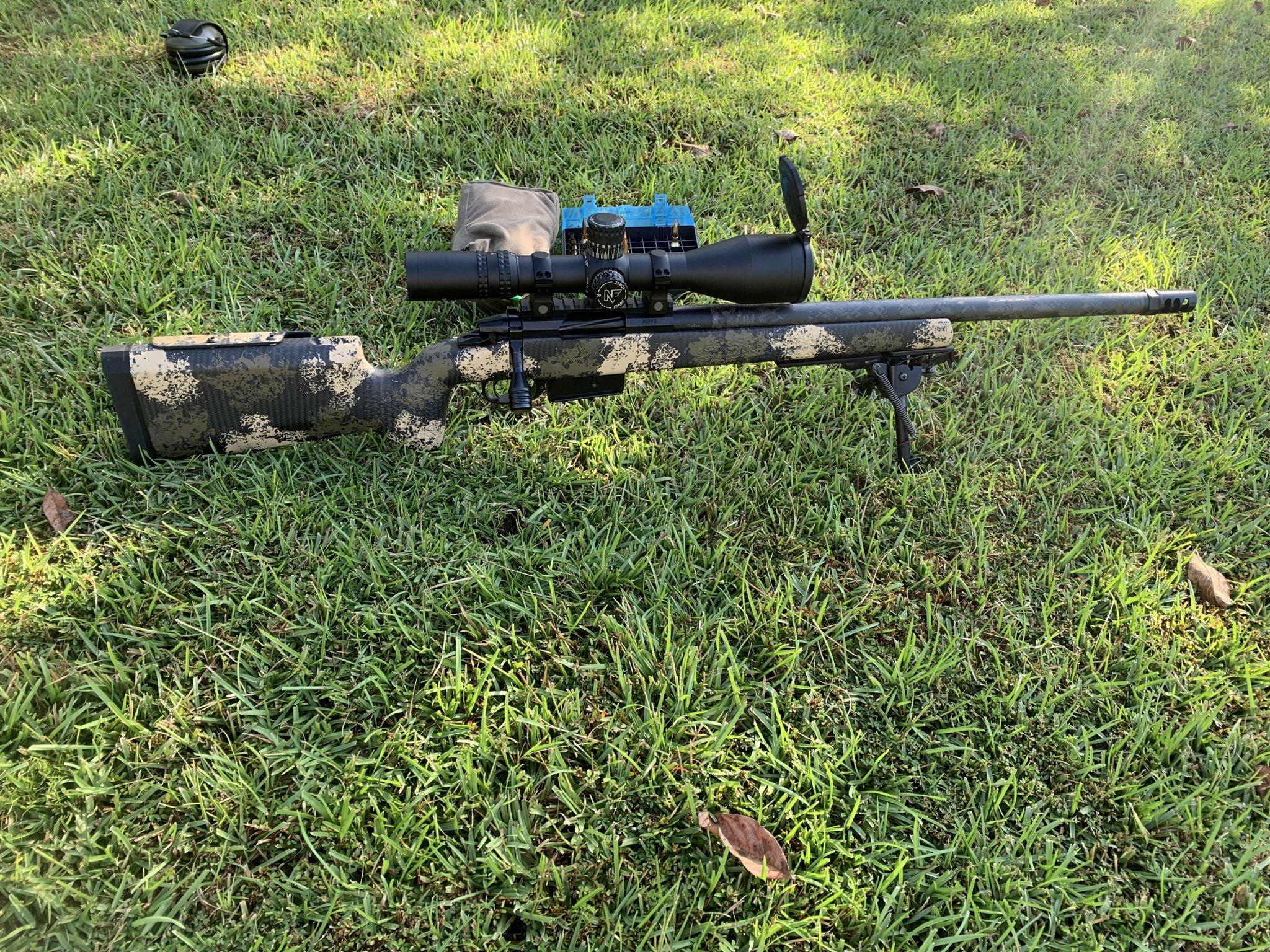

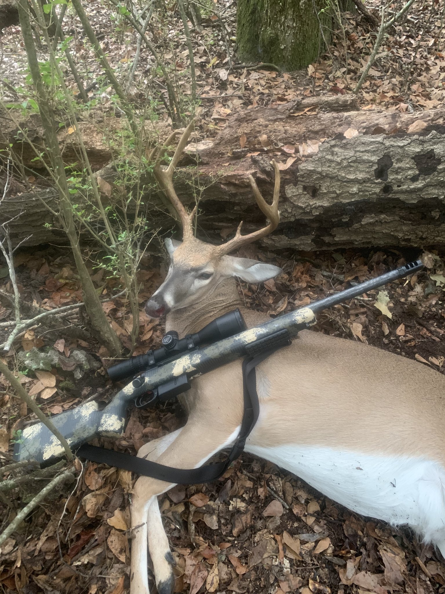

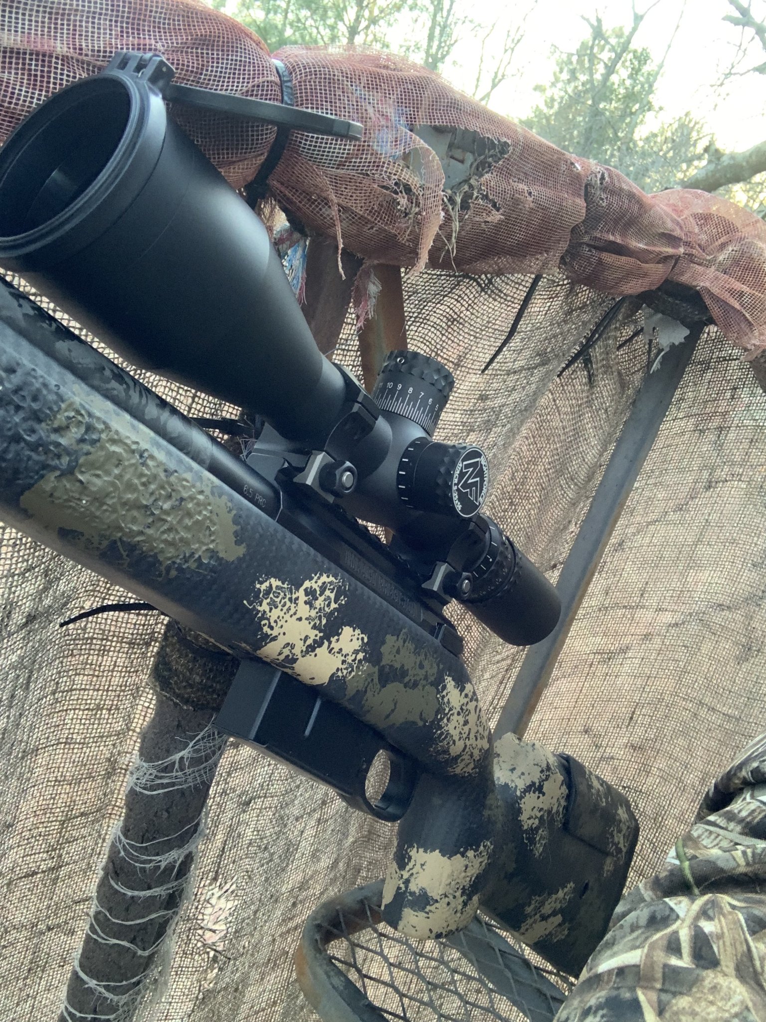

I had mine built this year, I went with a 6.5 PRC, Impact, proof 22”, manners eh1, TT diamond, and a APA brake and DBM,
And depending on where I’m hunting I swap from an Atacr to a Meopta scope.
The titanium impact wasn’t available at the time.
Killed a bunch of shit in the short time I’ve had it including some double head shot does!
Gradous built

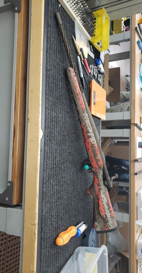

LRI has my Lone Peak Razor Ti now.
Fluted k&p #3 with short shank at 24” in 7rem mag (ever see a Walmart without one box of ammoMurphy fucking sits on my shoulder)
Going in an AG composites Privateer that just showed up. Hawkins bdl. Triggertech. I think Eric said the barreled action was right at 3lbs.
