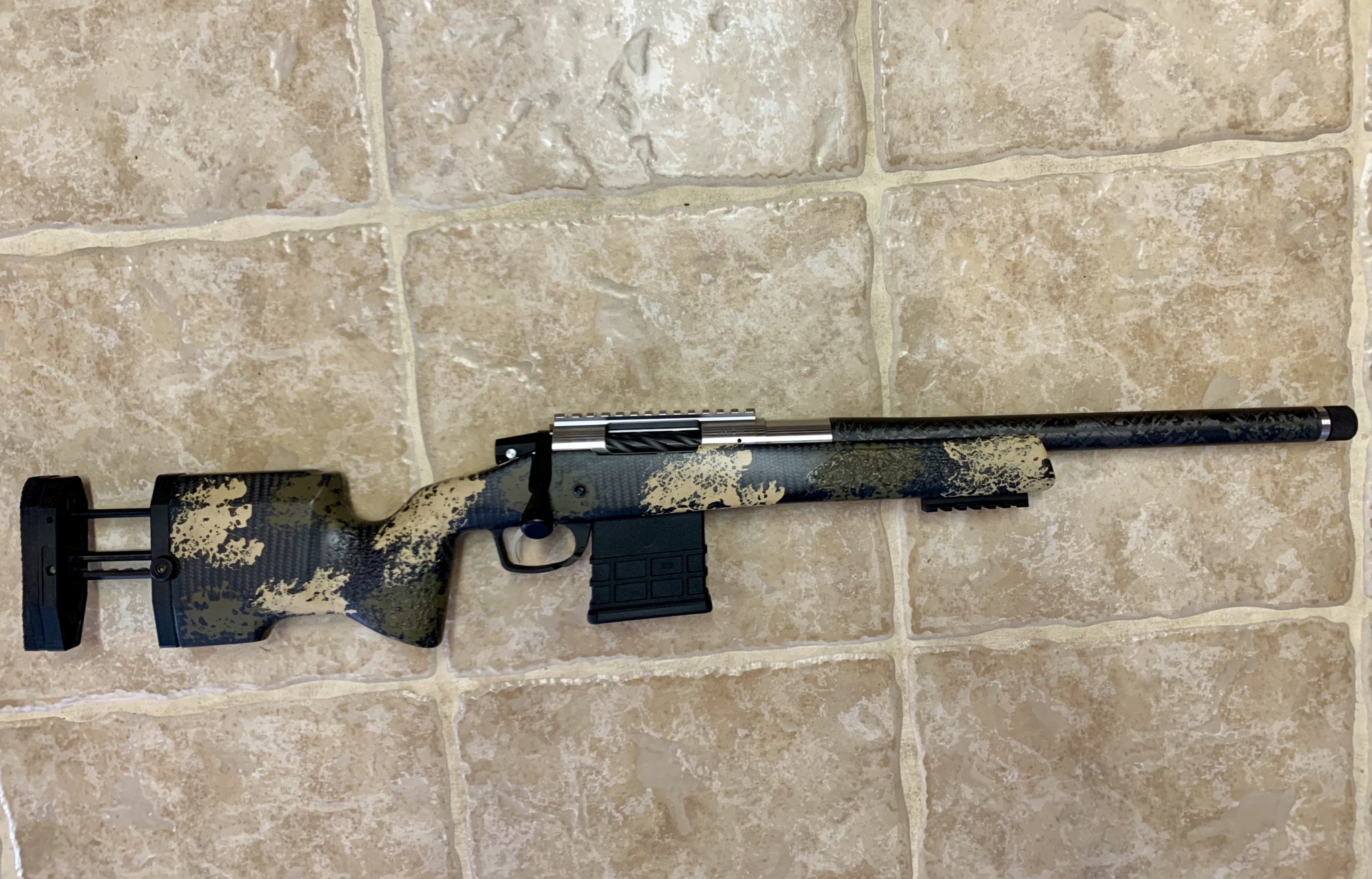

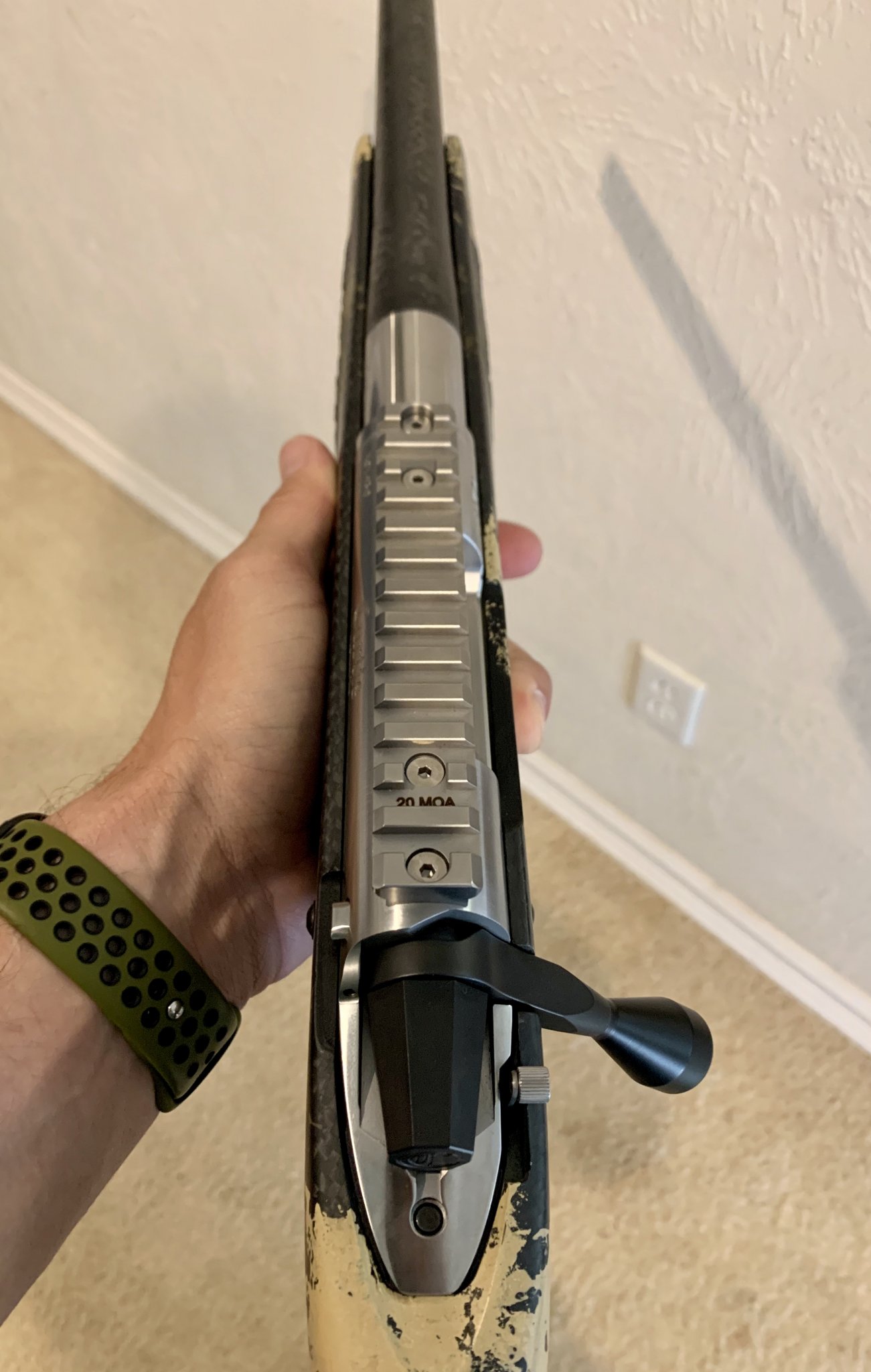

I went through this when my son was getting old enough to hunt with me. I needed a gun that had a short length of pull because of his tyrannosaur arms, but wanted easy adjustment so that I could shoot it too. I wanted a detachable box magazine so that I could easily be in control of the ammunition. I wanted a visually identifiable safety so that I could easily make sure it was on safe when it should be. I wanted a good trigger. And, I wanted an accurate rifle. The decision was easy. AR15!!! I mean, you could go min14...
As for the PC hand-wringers, tell your grandson to tell them to fuck off.

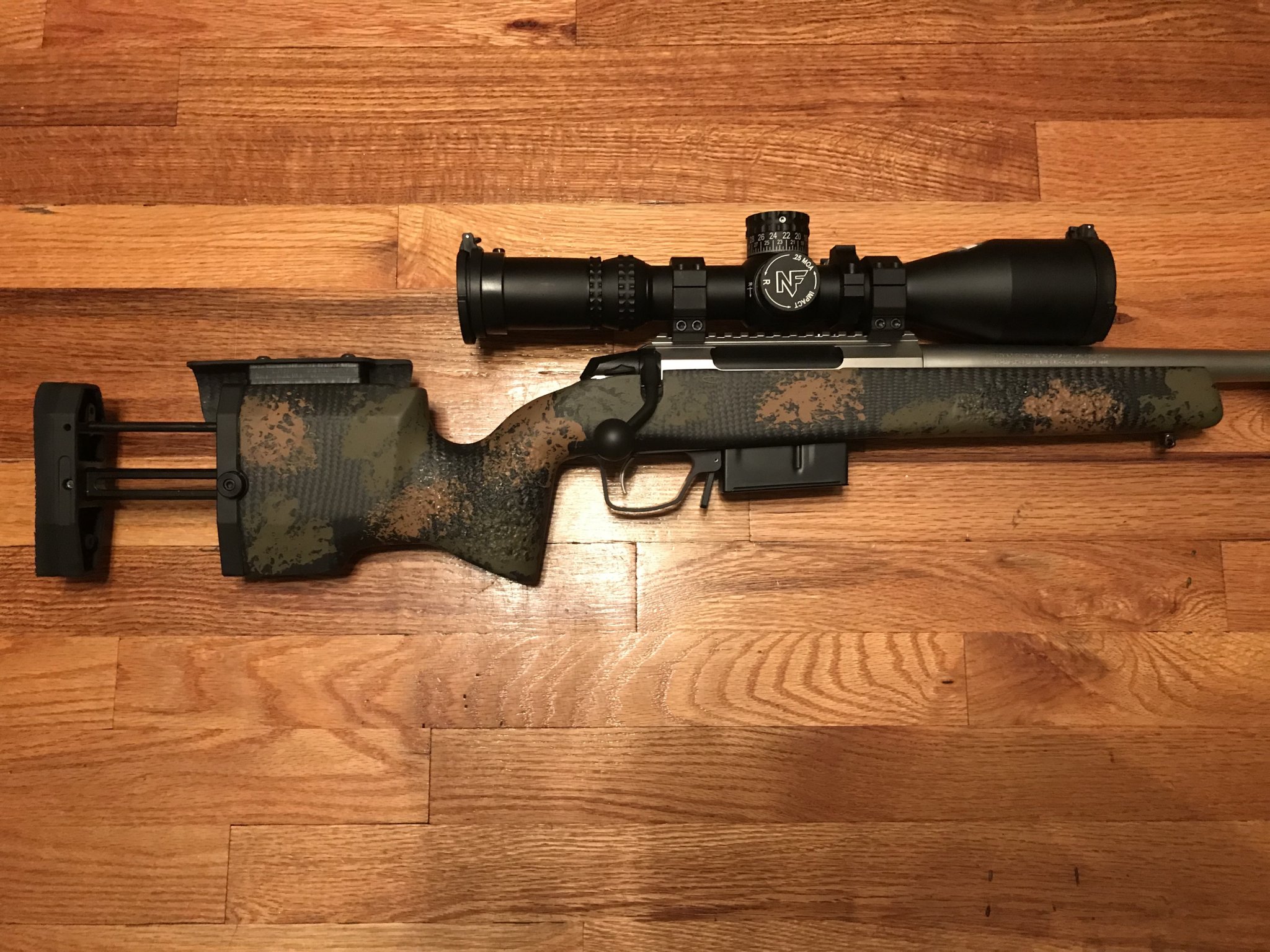

This is what I did for my kids
They can shoot it, I can shoot it, and the wife can shoot it.
6.5 with a brake
Although I do swap scopes around depending on what it’s being used for at the time
