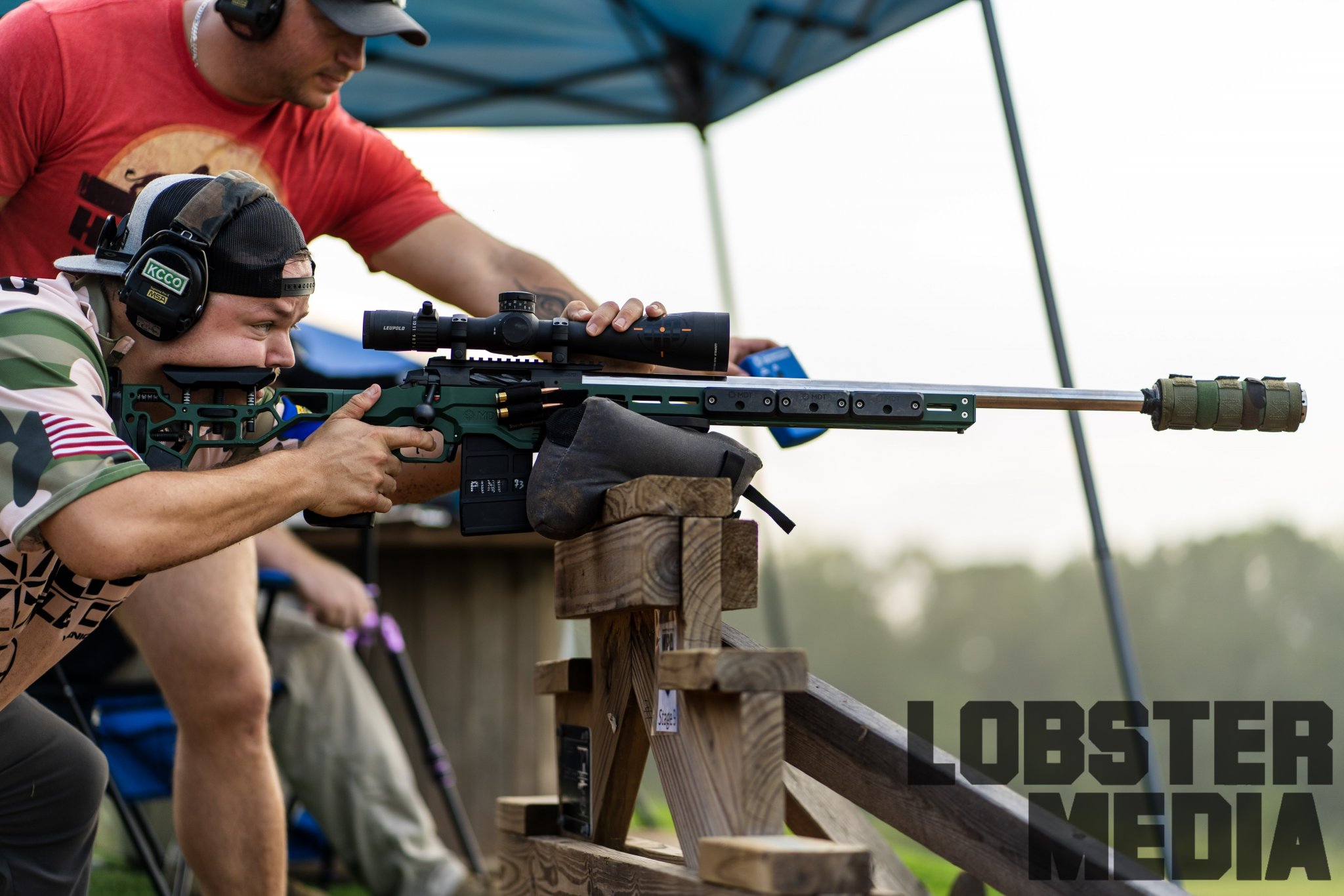

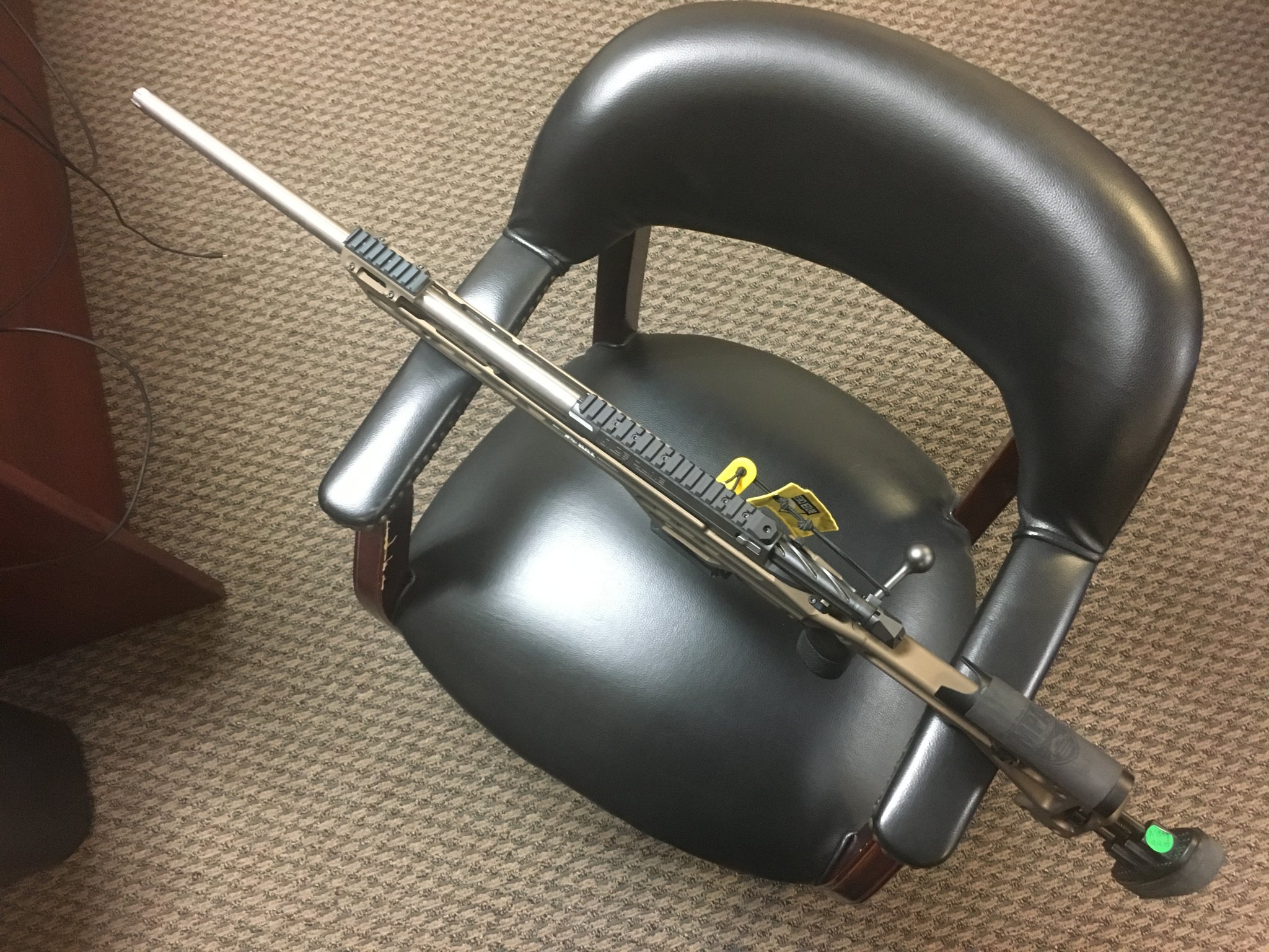

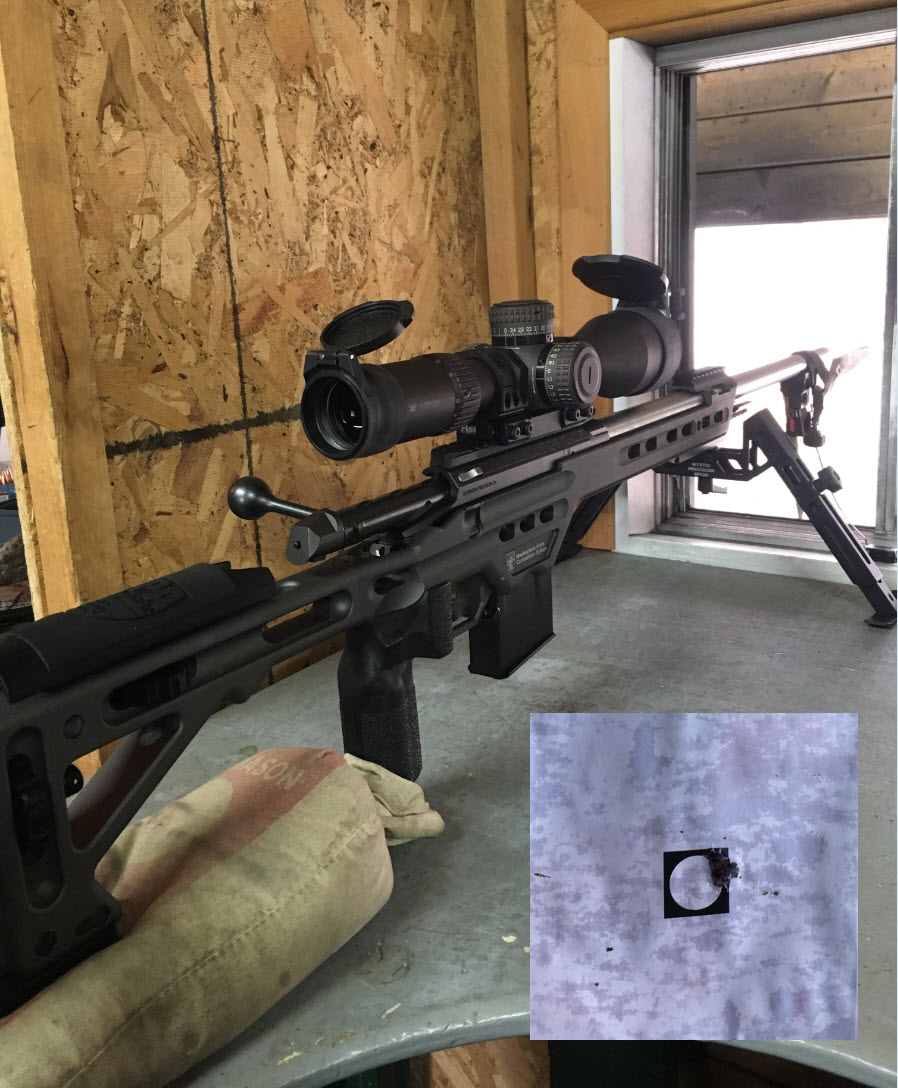

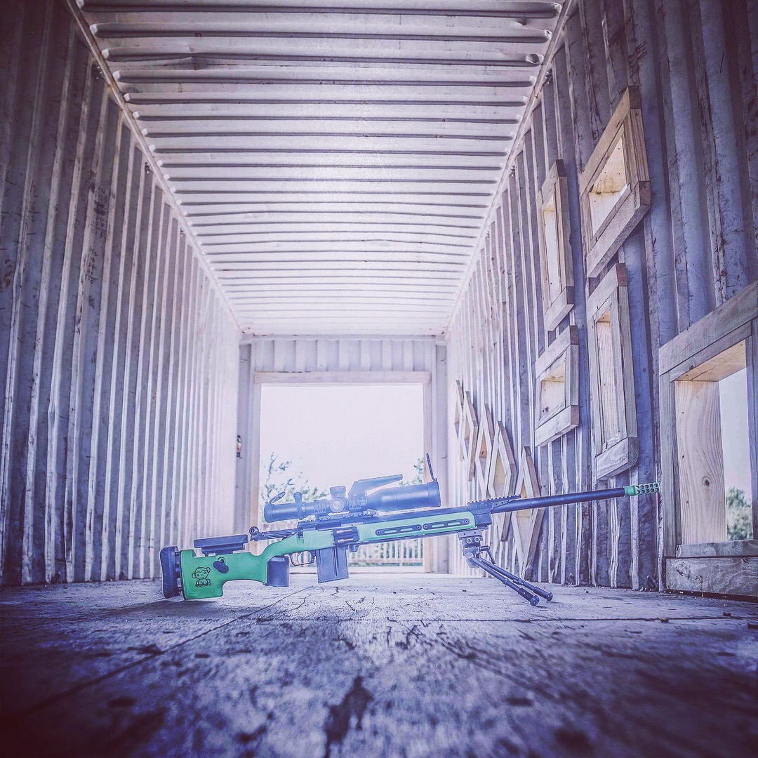

I'm running 2 Ultimatum Deadlines, and I think they are great. Built like a tank, and I haven't had any feeding/ejection/extraction issues. Both are in Manners stocks, which also needed some meat removed for the trigger hanger, safety, and the mag catch trimmed to use AW mags. All stock mods took about 10min total with a dremel.

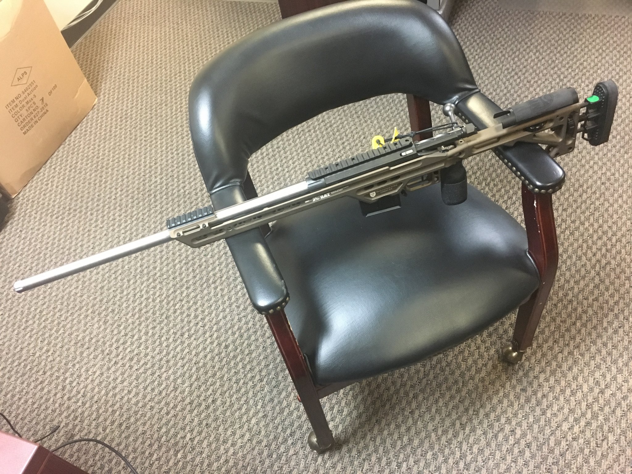

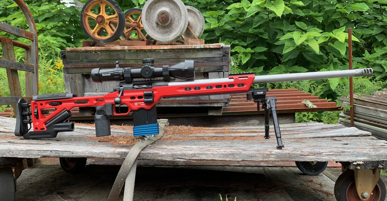

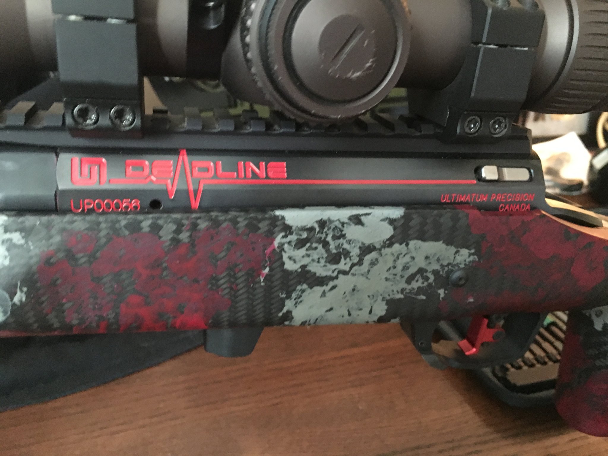

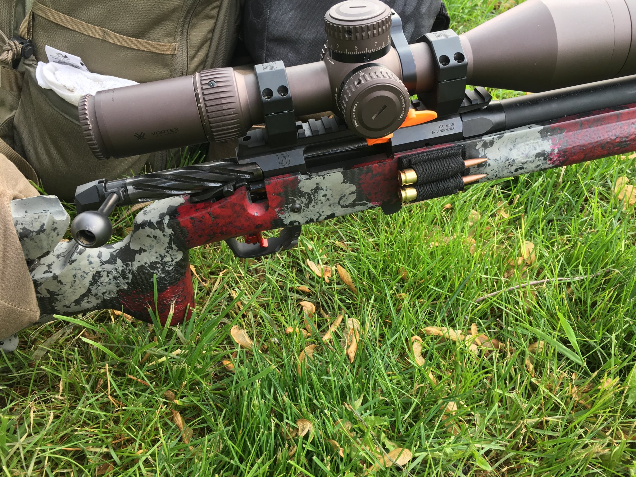

Here is mine.

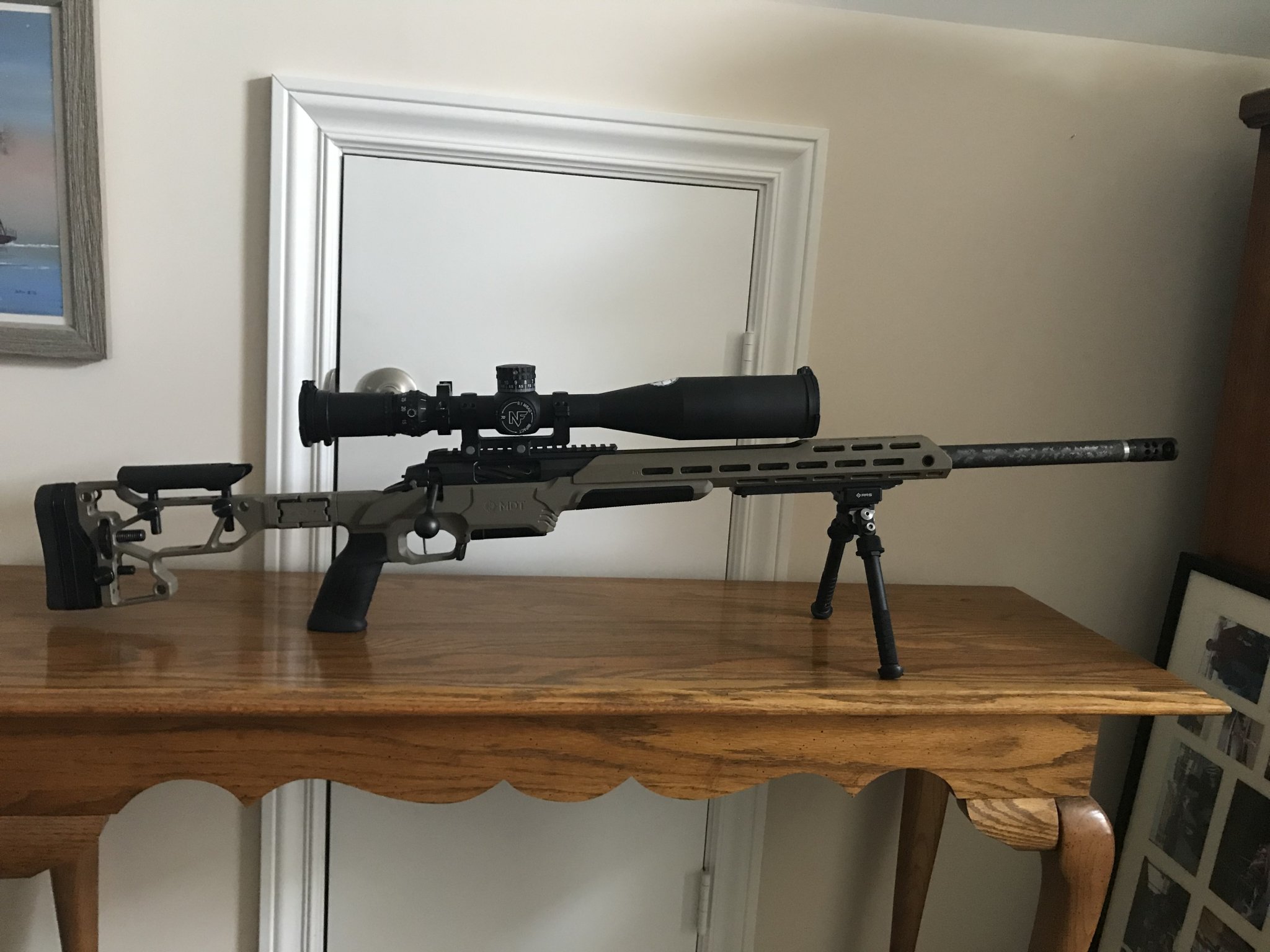

I just put mine in an MPA as well. Did you have to trim the rear action screw? I noticed mine would drag on that so just needed to be taken down some.
I did not have to trim the screw. However I did shim the rear tang 0.007” to ensure a smooth travel of the bolt when the action was torqued.
Poly Mdt mags would not work with the deadline because of the action design, but the cadex mags worked very well.

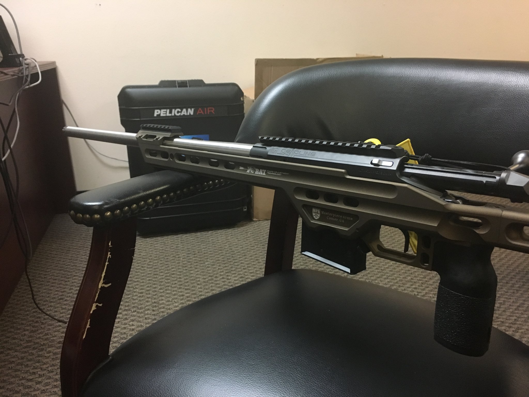

I have been shooting a deadline action chambered in 6.5 creedmoor, in an MDT ESS chassis with no problems. Have over 1,500 rounds through it. Only issue was having to shorten the rear action bolt in order to torque to speck. Without this trimming, the rifle bolt would drag when moved fully toward the rear. With the shortening, action is smooth as glass. Love the setup.
