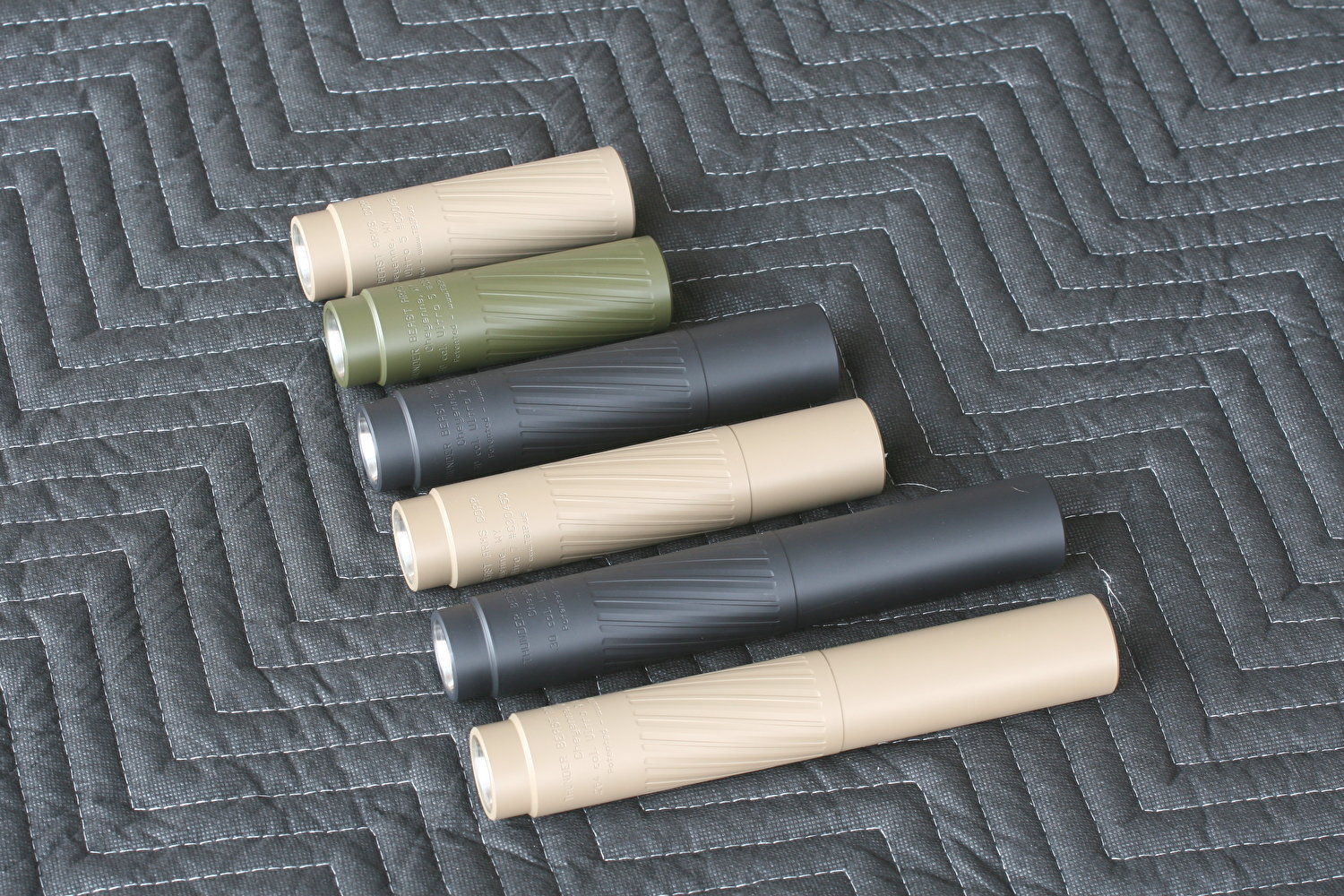

ULTRA Gen2 Product Announcement
We are pleased to announce the next generation of the ULTRA suppressor line. This design change affects the ULTRA 5, ULTRA 7, and ULTRA 9 models only. Compared to the original ULTRA series (Gen1) introduced in 2015, these are on average 1.7 ounces lighter (about 20%) and about 2 dB quieter. This is a “Tubeless” design, a change debuted on our Dominus earlier this year. Gen2 Ultra 9’s, 7’s, and 5’s can be identified by serial numbers higher than C40000 or by the visual changes.

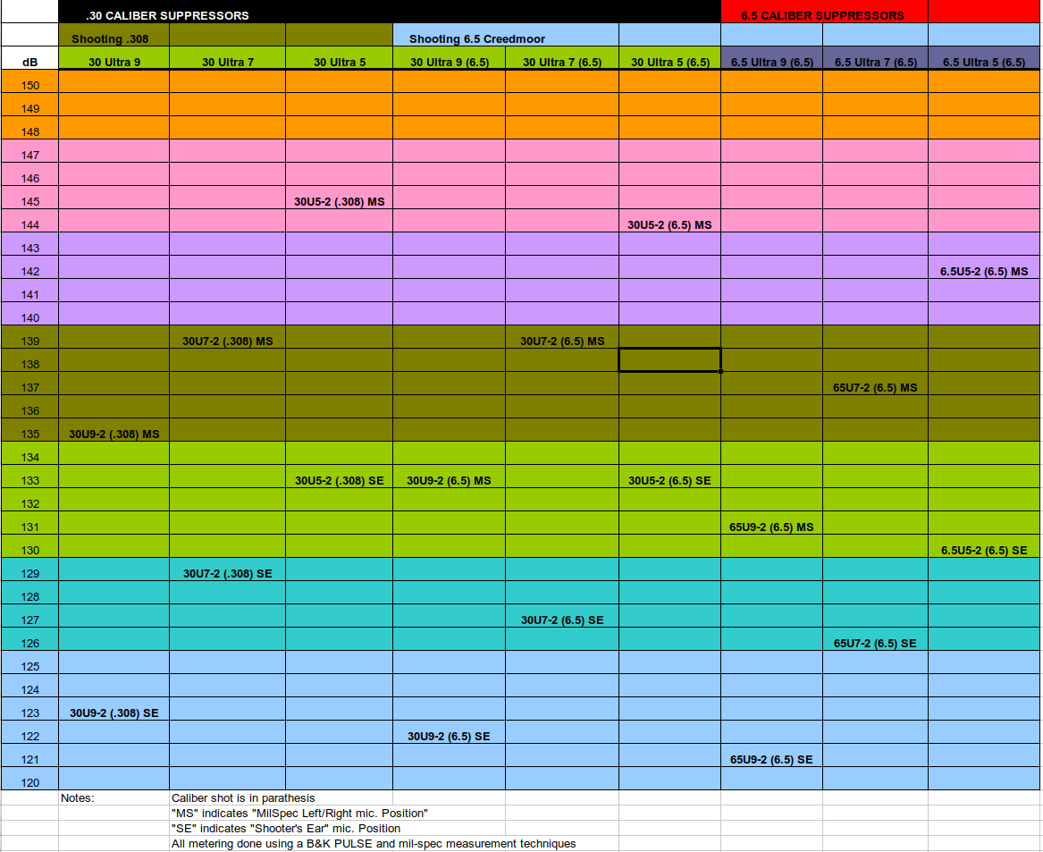

In short: Quieter and Lighter! Same size, same price.
ULTRA 9 GEN2: available in .30 and 6.5 mm calibers
The .30 cal ULTRA 9 Gen2 meters at 135 dB (milspec left/right) and 123 dB at shooter’s-ear, shooting full-power (hot) M118LR ammunition from a 20″ AI AX.
Compared to the original, the Gen2 is about 2 dB quieter at the muzzle and 5 dB quieter at the shooter’s ear.
The 6.5 mm cal ULTRA 9 Gen2 meters at 131 dB (milspec left/right) and 121 dB at shooter’s-ear, shooting Hornady 140gr ammunition from a 24″ AI AX.
Compared to the original 6.5 mm version, the Gen2 is about 2 dB quieter at the muzzle and 2 dB quieter at the shooter’s ear.
The ULTRA 9 Gen2 weighs 10.0 ounces (1.9 ounces lighter than the Gen1), in CB configuration.
Ultra 9 Gen2 Full Specs
ULTRA 7 GEN2: available in .30 and 6.5 mm calibers
The .30 cal ULTRA 7 Gen2 meters at 139 dB (milspec left/right) and 129 dB at shooter’s-ear, shooting full-power (hot) M118LR ammunition from a 20″ AI AX.
Compared to the original, the Gen2 is about 2 dB quieter at the muzzle and 2 dB quieter at the shooter’s ear.
The 6.5 mm cal ULTRA 7 Gen2 meters at 137 dB (milspec left/right) and 126 dB at shooter’s-ear, shooting Hornady 140 gr ammunition from a 24″ AI AX.
Compared to the original, the Gen2 is about 1 dB quieter at the muzzle and 1 dB quieter at the shooter’s ear.
The ULTRA 7 Gen2 weighs 8.0 ounces (1.7 ounces lighter than the Gen1), in CB configuration.
Ultra 7 Gen2 Full Specs
ULTRA 5 GEN2: available in .30 and 6.5 mm calibers
The .30 cal ULTRA 5 Gen2 meters at 145 dB (milspec left/right) and 133 dB at shooter’s-ear, shooting full-power (hot) M118LR ammunition from a 20″ AI AX.
Compared to the original, the Gen2 is about 4 dB quieter at the muzzle and 3 dB quieter at the shooter’s ear.
The 6.5 mm cal ULTRA 5 Gen2 meters at 142 dB (milspec left/right) and 130 dB at shooter’s-ear, shooting Hornady 140 gr ammunition from a 24″ AI AX.
The ULTRA 5 Gen2 weighs 6.0 ounces (1.6 ounces lighter than the Gen1), in CB configuration.
Ultra 5 Gen2 Full Specs

The dB numbers posted here are all from the PULSE. Historic data on the original Ultras was all 2209 data. This data is more accurate.

Nice. I didn't catch that, I was more focused on the Ultra 7. 123dB at the shooters ear with M118LR is pretty freakin' awesome!
