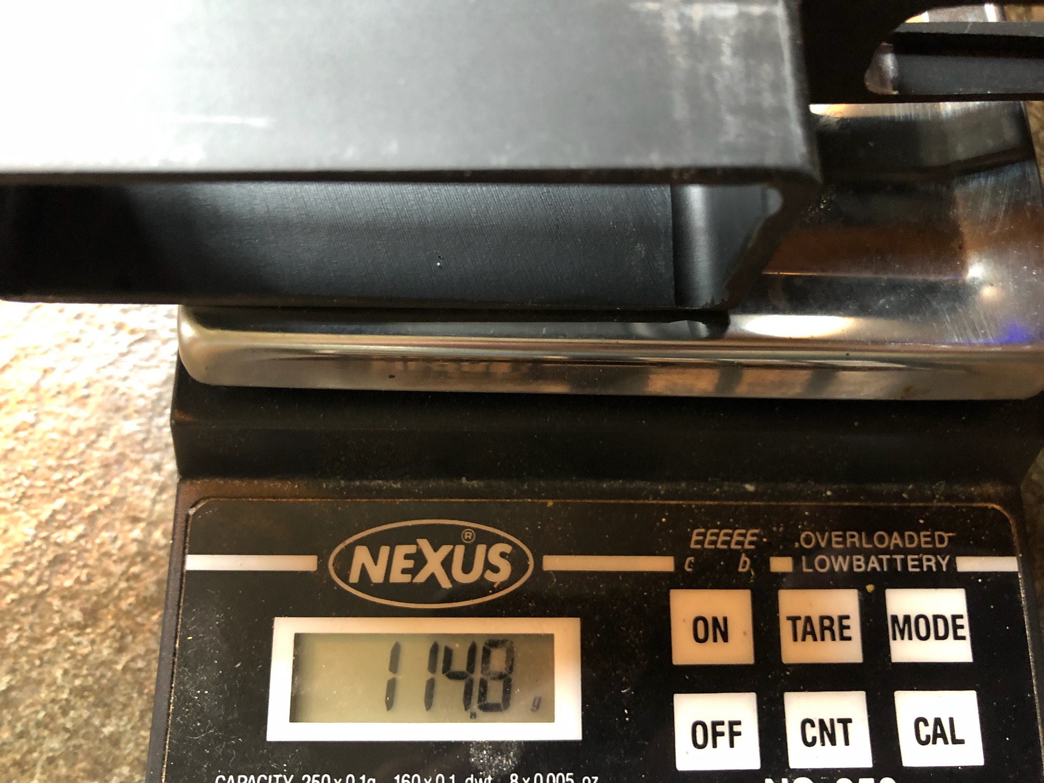

Alright. Ive scoured the interwebs with very little luck on this subject. I am beginning my version of an ultralight Purgatory/ Mammoth Sniper Comp/ Mountain rifle. I created this in hopes that the members of this forum could help me create a one-stop thread on the lightest DBMs on the market. Some DBMs you can find the weight others you cannot. SO, if you have a Remington 700 short action with a detatchable box magazine and would be willing to help out the community and weigh it (grams or ounces) I think more than just myself would appreciate it. Thank you to all who have good suggestions to follow, manufacturer confirmed weights or personally submit the weight of your bottom metal! I will list what I've compiled shortly
I'm not surprised. I had to cut 3g of aluminum off the PTG Model 7 DBM to even fit a factory barreled action. It didn't include any pillars or documentation on pillar height either. I got out the No. 2 pencil and made it work though; just more time fartin' around instead of shooting is all.
Sofar my paper and pen list is awol so this is what I have sofar. This Grayboe M5 DBM weighed in at 11.48 grams or 4.05 oz

Throwing this out to post the weight even though it is not the lightest.
The Mk-1 bottom metal from KMW is not an M5 inlet but it was built to be dropped down stairs rather than be ultra light.
It does have a stellar track record for correct geometry and extremely consistent dimensions from part to part.
Weight without stock bolts and pillars is 129.5 grams / 4.58 ounces as posted on the web page: https://www.kmwlrs.com/mk1dbm

I would think something like the PTG stealth would be the lightest, or any other flush mount DBM. Is having the bottom metal hang below the stock line for a barricade stop important for your purposes? Obviously less material = less weight.
I've got a PTG flush mount at home, I'll try and weigh it over the weekend if I remember.
The barricade stop would be a good thing I bet and has its place. Please do CHADPEZZLE ! We I'm sure would really appreciate any info we can compile here??
