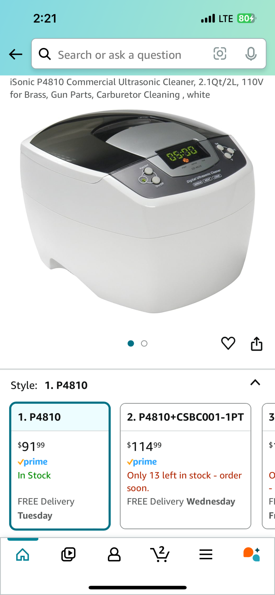

Hi, I am a newbie of Reloading
I never cleaning the brass before
But i think i need to do it after couple time used,
In my circumstances, the ultrasonic cleaner is good for me, not the water or vibration one
So i just lookaround the amazon, and
I can see that just commercial ultrasonic cleaner
Like this,
So, is this one same like hornady’s ultrasonic brass cleaner?
Is that commercial one’s, okay to use for brass cleaning?
Reactions: DevilDog504
The ultrasonics made for the gun industry basically suck. You want to get one that's powerful and has a minimum of a 30-minute timer. Commercial ultrasonic cleaners tend to be better. I've got two of them - one large, one smaller - and I've got a Hornady that had the fan go bad that's sitting in a closet somewhere.

That’s the one I got from Amazon on sales, got it for 6 months, no issue. Keep in mind small, I can do 100 brass, 6.5CM and 308 at the time.
