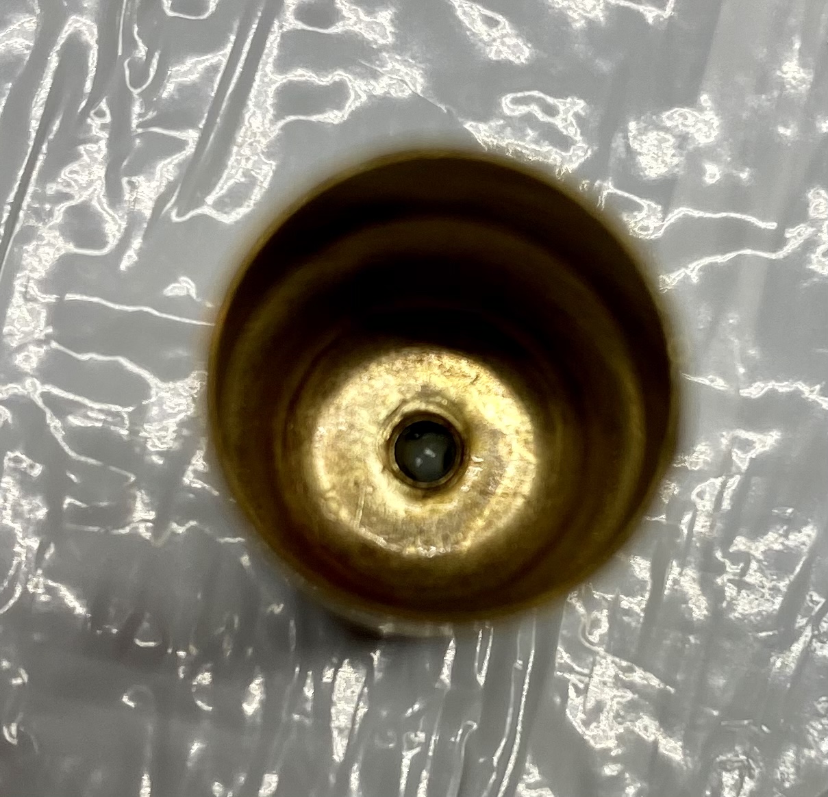

Anyone come up with any decent homemade ultrasonic solutions for brass? I’ve been using lemishine and dawn and it works ok but for some reason theres always some residue on the outside of the necks on the 6.5 creedmoor cases

Yeah mine works great on handgun brass and even smaller cases like 6.5 Grendel. But for some reason the creedmoor cases don't get as clean. I do stand them all up in a cup when I clean them though. Maybe I’ll try laying them down
