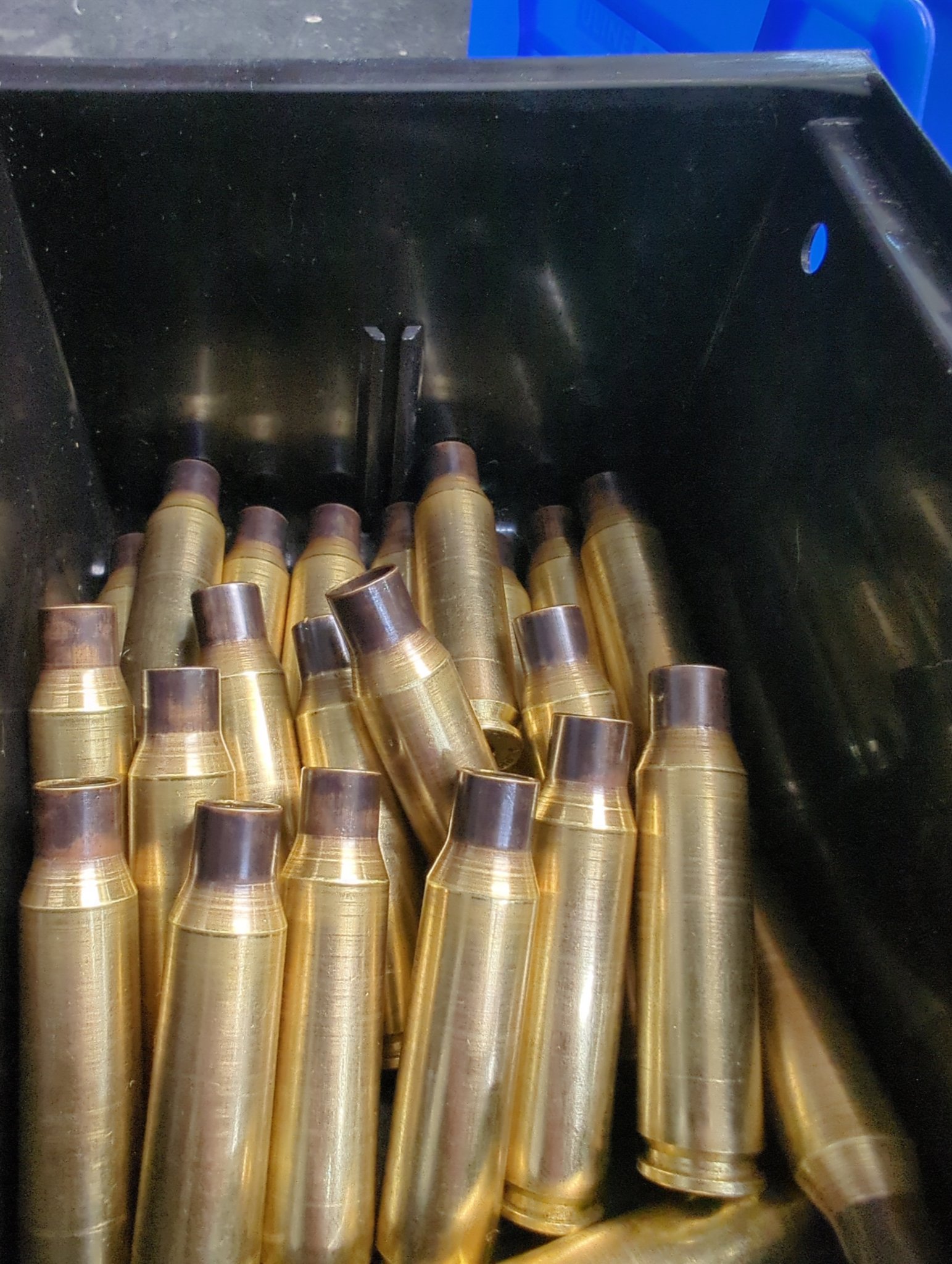

Never tried the UC for removing lube but I assume it would work. But it might take away the shine (God forbid). After sizing I just put the cases in a vibrator tumbler with corn cob media for 20-30 mins. Takes off all the lube...inside and out, and it comes out with a nice shine. Remember, the more shine the cooler you are.
Reactions: jwynne5227
This is the 'natural state' of my fired cases these days... "cleaned" with #0000 steel wool. Black gold 😉
