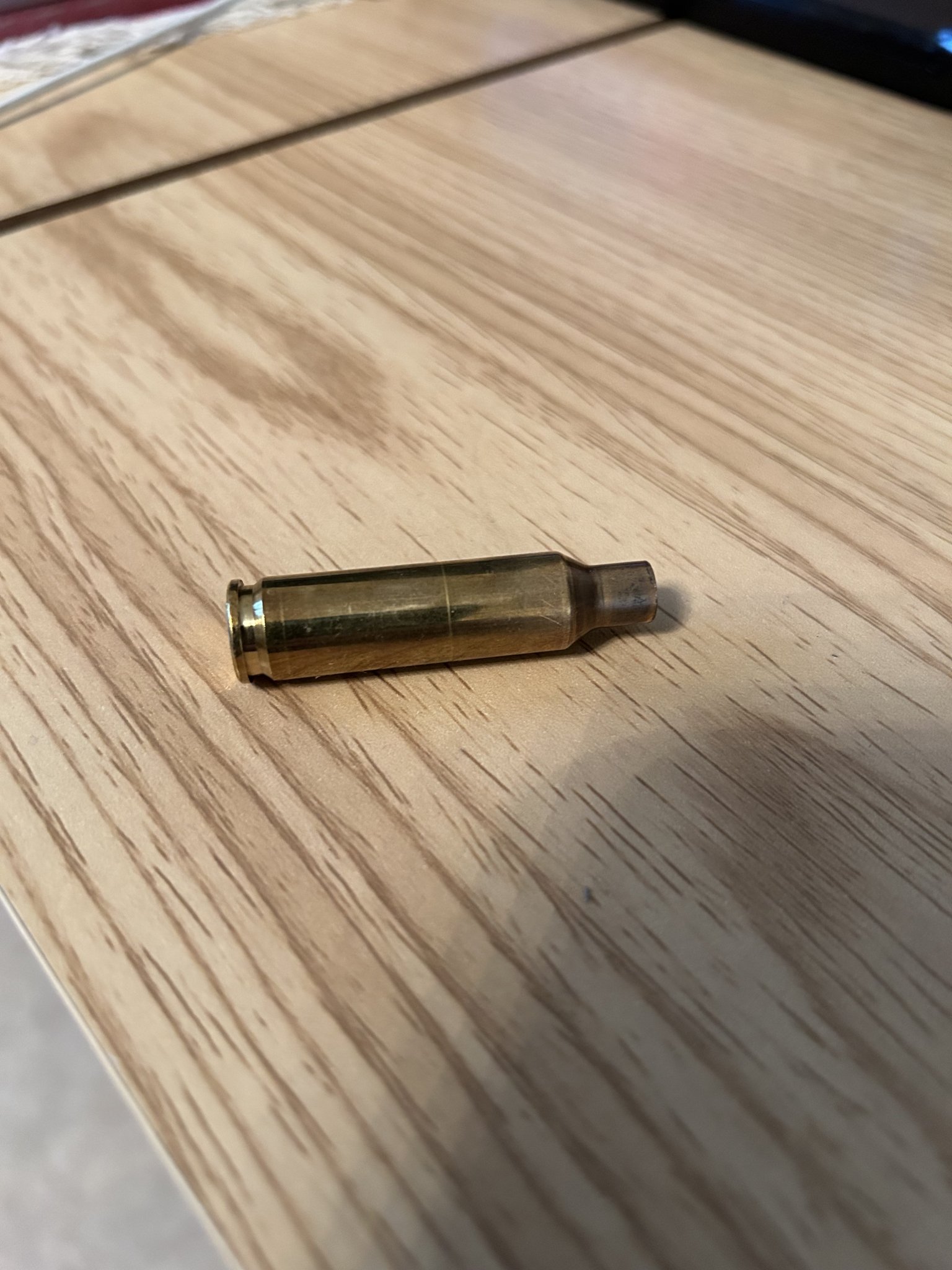

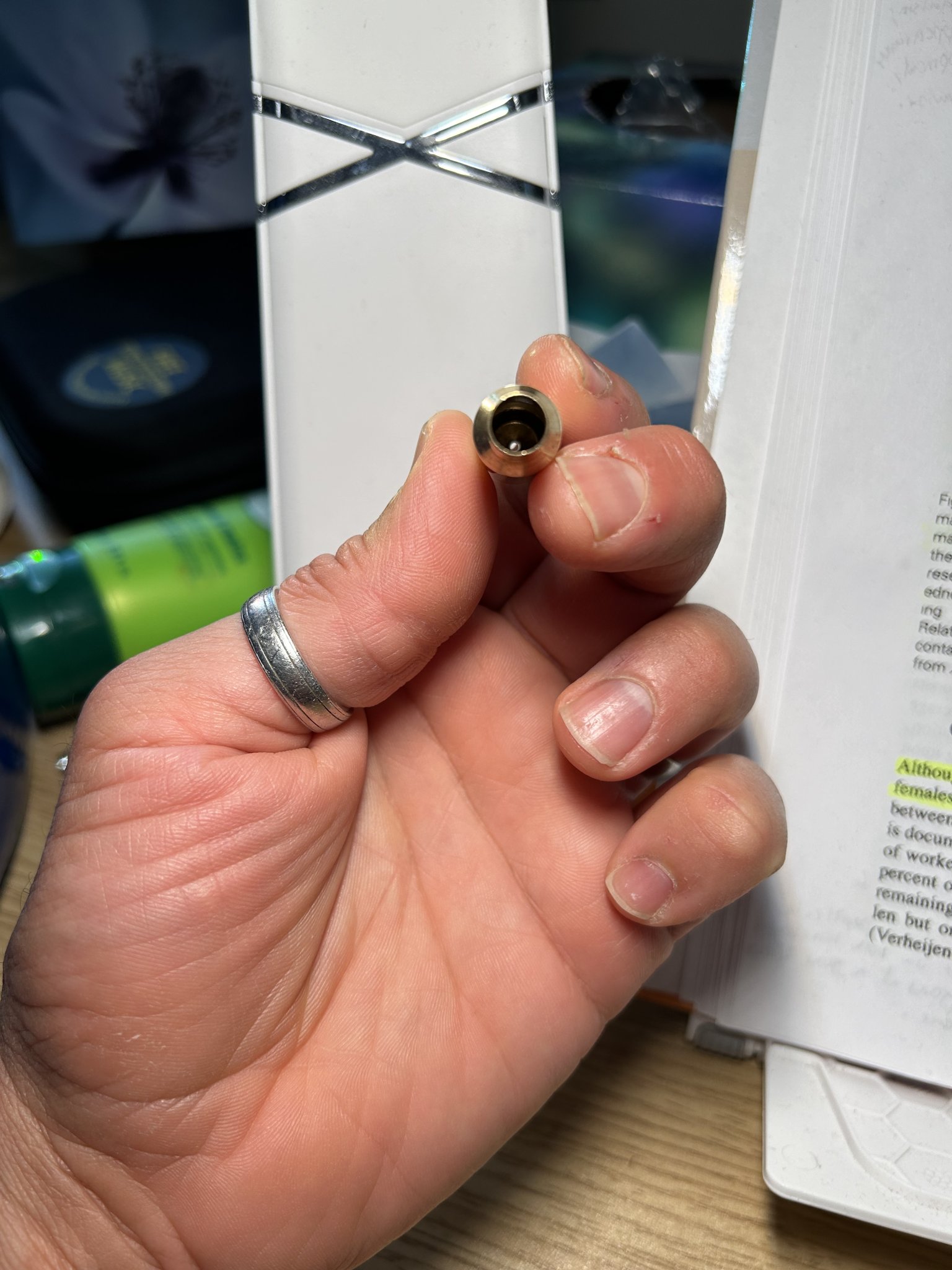

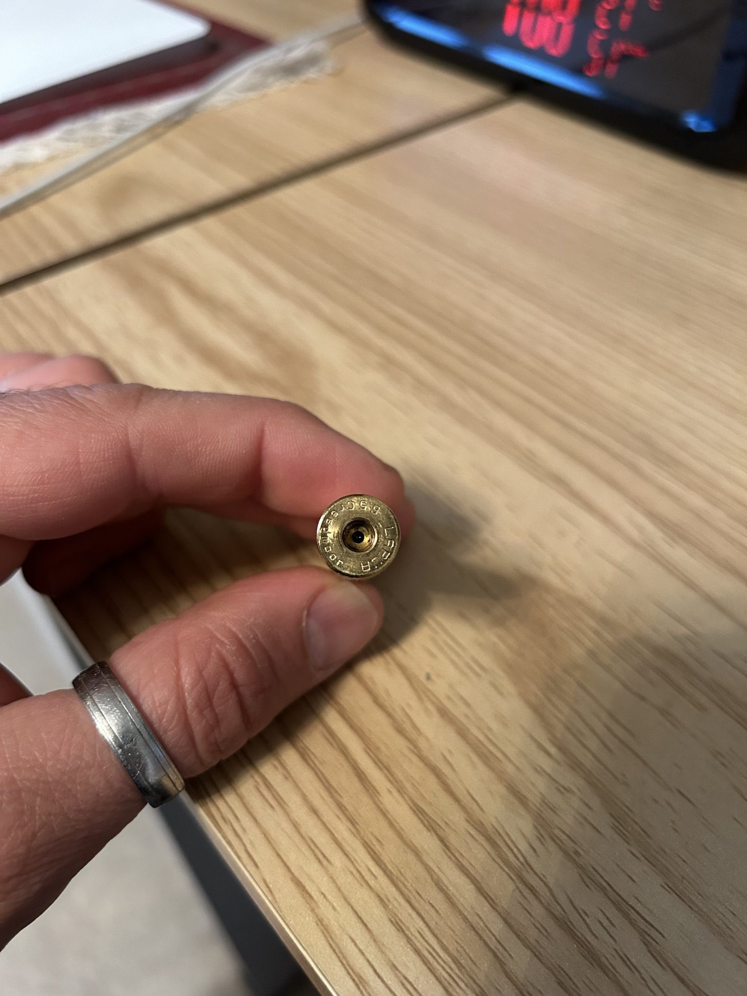

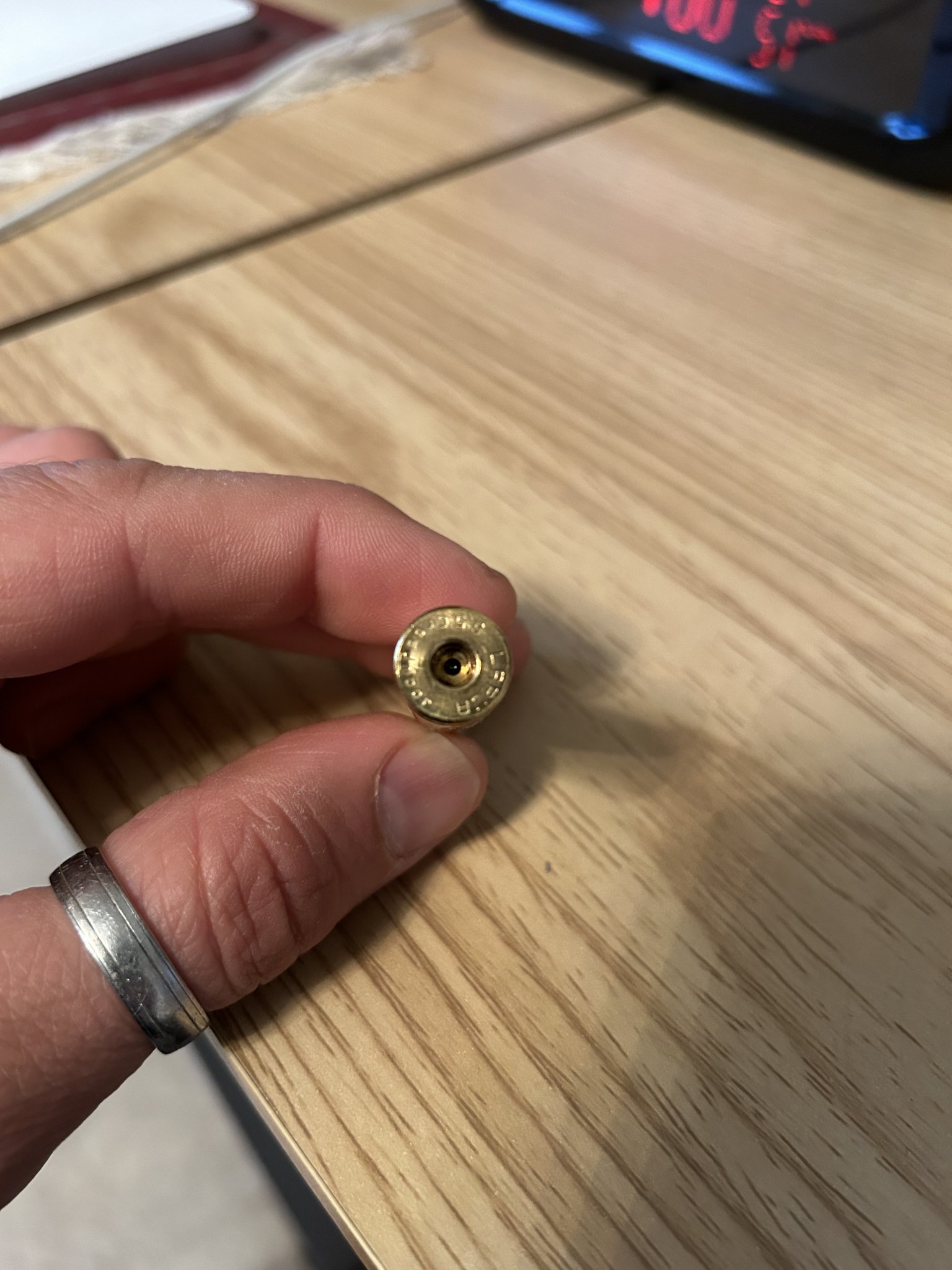

Hi there, today is my first time using an ultrasonic cleaner for my brass. The specs on mine are 10L 600W heater and 240W OSC power. I did 100 cases of brass using heat distilled water and a squirt of dawn. I degassed for 5 mins then run two cycles of 20mins. Cases feel squeaky clean but I still see black carbon on the inside and primer pocket (see pics). Is this the expectation or does that mean they are still not clean?
Is there an alternative solution that you recommend?

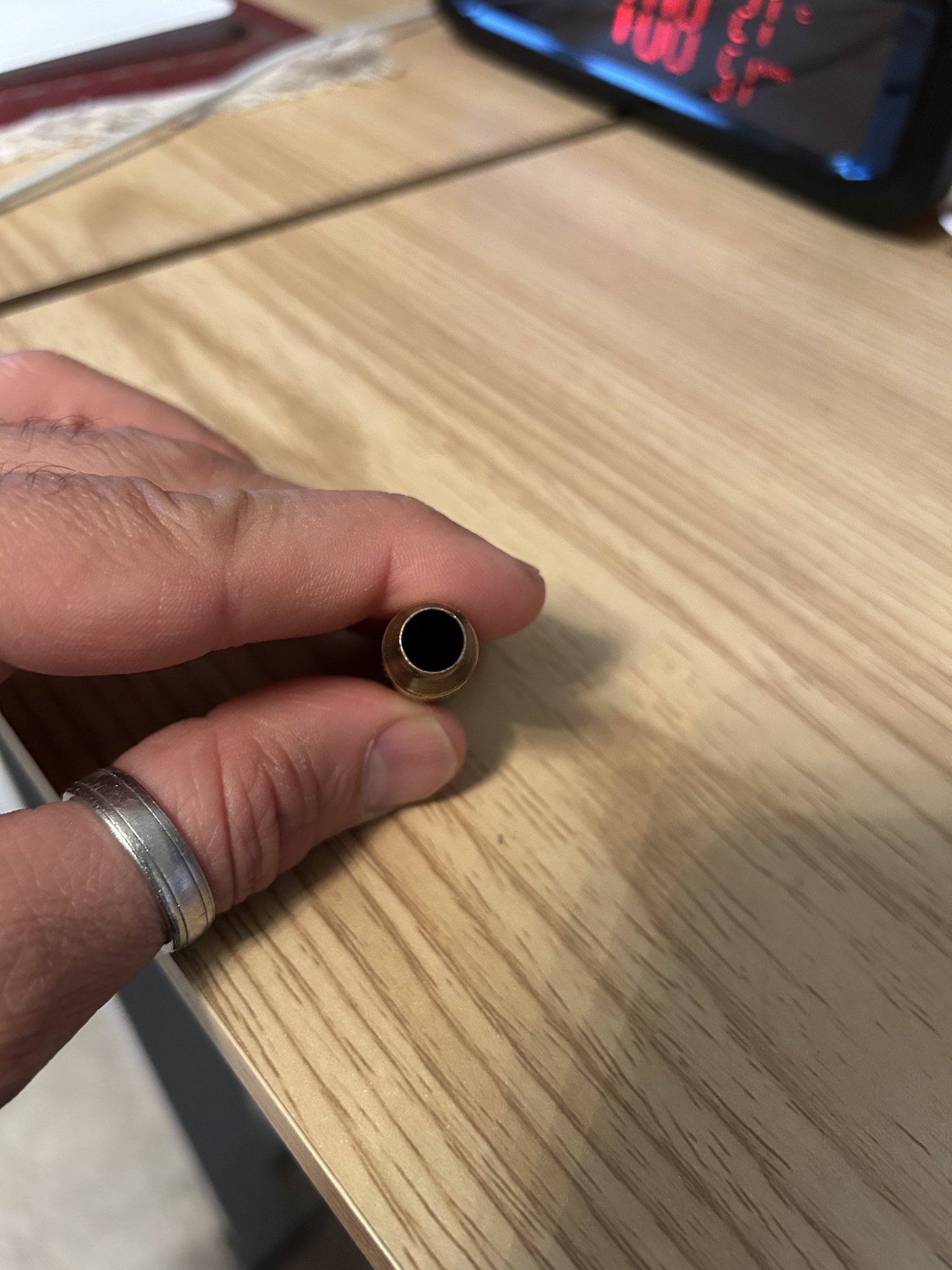

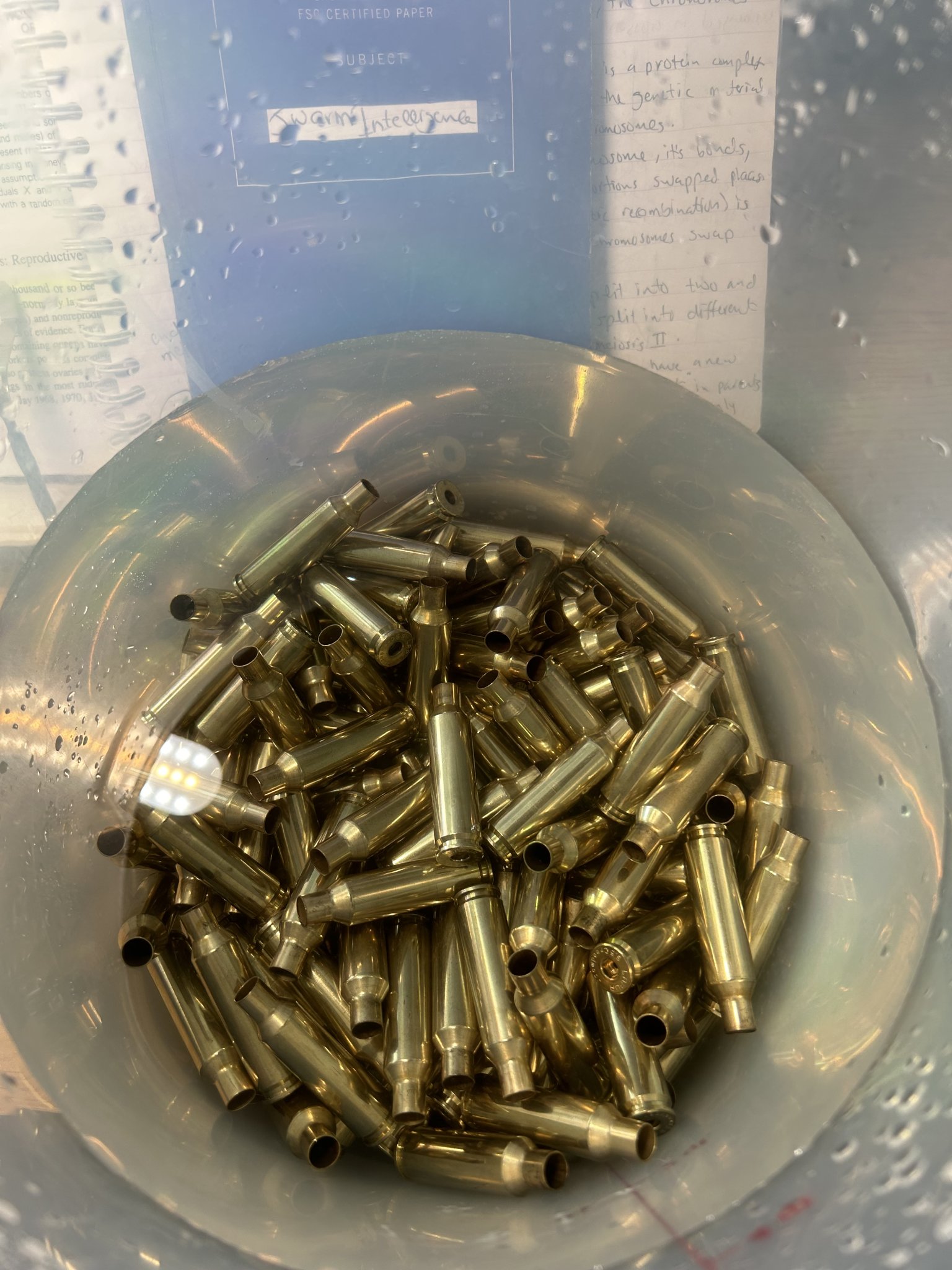

Damn this stuff really works lol cases are shiny inside, outside and even primer pockets. No signs for copper. I used Dawn and 1/2 teaspoon of Lemishine per 1L of water. I ran it for 45mins then placed the cases in another bucket with some baking soda to counter any acidic reaction. Awesome and super easy! Thanks for the help guys
