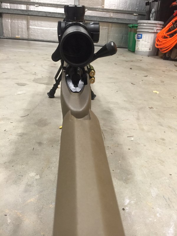

After taking a look at current throw lever options, like the MK Machining 3D printed, MGM SwitchView machined/anodized aluminum, and Aadland (printed or molded plastic I believe), I went looking for more of the Universal Coasters that I bought years ago as a temporary solution. When I bought them years ago they were pretty inexpensive but the idea of using the fishing product as a firearm accessory caught on and now they are being sold at pretty decent markup. Still, they're cheaper (at less than $10 ea) than any of the aforementioned solutions, and I can orient (clock) them anywhere I want on the mag ring, which is not possible with the purpose built units. I don't like whacking the throw lever while cycling the bolt, and with some scope/action combinations that means I have to either clock the throw lever where I like (which I can with the coasters) or limit how far I rotate the mag ring CW (with one of the purpose built products).
So you can laugh at my cobbed-together rig with the cheap quasi-throw lever until you realize that it's an AIAX with a Minox ZP5 or Bighorn TL2/Bartlein barreled action with an S&B. I like 'em and I'm gonna keep using 'em.
I can't laugh at it if I don't know what it looks like, any photos?
I generally make it a rule not to laugh at the tools people choose to get the job done, except possibly when someone goes uber tacticool and knows not how to use their weapon. That's sometimes funny.
I just wanted to say that I have a few MK Machining printed levers (on sale for $15 ea.), a couple Switchview levers and another brand lever I got with my Steiner. Not one of them impedes my bolt throw in any position/power setting. I find that in each case, I can set them for mid-power range at twelve o'clock and be clear at any other position. This is a handy thing for match or hunting IMO.
Anyway, each to his/her own as far as I'm concerned.
I have 4 different bolt guns where the opposite is true with an MK Machining lever and with the Switchviews I've tried.
And I only have 4 bolt guns at the moment

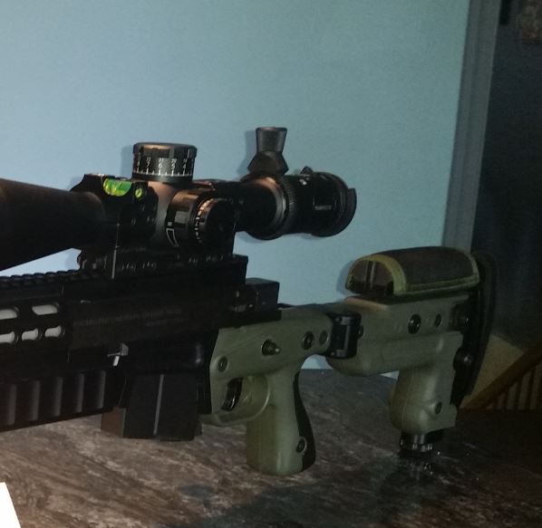

The offset of the handle of the MK lever to the "rib" on the mag ring (which typically sweeps from 9 o'clock to 3 clock) is only 15 or 20 degrees. This means that installed in the RH position (lever sweeps from 8 o'clock to 2 o'clock), the lever is smack in the middle of the bolt handle travel when the mag ring is swung all the way CW (2 o'clock).
This even happens on an AIAX, with 70 degree bolt throw and 1.4" high scope.
Scud, post a link or a pic please. I'm not sure what a Universal Coaster lever is in fishing, or how one adapts it to an optic throw lever. Thanks.

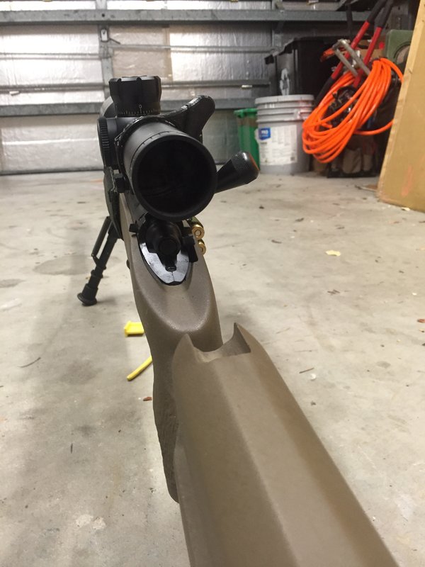

Throw on my match rifle is about 7:30 to 1:30 and clears just fine. My others are similar.
Edited due to poor ability to manage the pictures on my phone.

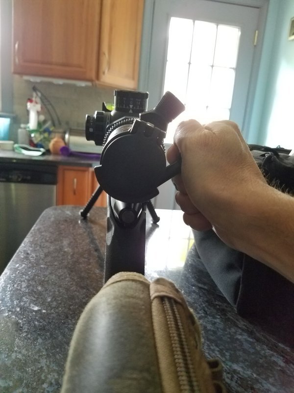

I still don't quite understand why you have so much trouble with yours and I have these products on all of my scopes with no interference. Plus, I'm shooting all standard throw actions to boot. You see my pictures above? Those are of a MKM printed lever on a HDMR on top of a Stiller Tac 30 AW.
I also use Switchview or MKM on Sightron, S&B 5-25 PMII, Steiner and Vortex. All with similar results and no interference. I'm pretty sure that is why the others are also asking why.
As I said above, use what works for you and carry on, but realize why some of use don't get why you are having so much trouble with the product specific cat tails out there.

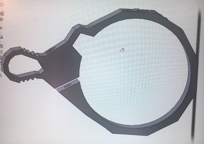

Hey guys,
Tyler from MKM here. It sounds like bolt interference is a bigger issue than I ever knew. We do try to design the lever with it being on a low mounted scope in mind, but if there's EVER any fitment/clearance issues I wanna hear about it, or else I can't fix it! I'd much rather have someone tell me something needs fixing than be reading through a forum and find it out!
Those universal zip tie things were $22 on Amazon until I started listing our throw levers...I certainly want to offer a better product than a zip tie.

Because it's been my experience, regardless of what you've experienced with the scope/action combinations you're running.
By an AIAX, mount a Minox ZP5 in a Spuhr SP-4006, and try it for yourself.
Likewise with the same scope in Seekins Low rings on a TL2 action.
Just because you don't have any issues with the combination of equipment you are running doesn't mean it can't happen with different equipment.
Here's the model Tyler sent me of the lever that should fit my Minox. Looks like less than 30 degrees of offset. The DMR lever you pictured has at lease another 20 degrees of offset.
The bolt handle on my TL2 Seems to afford less clearance to the scope than your Stiller. There's just not room for a lever that's clocked another 20 degrees CW.
