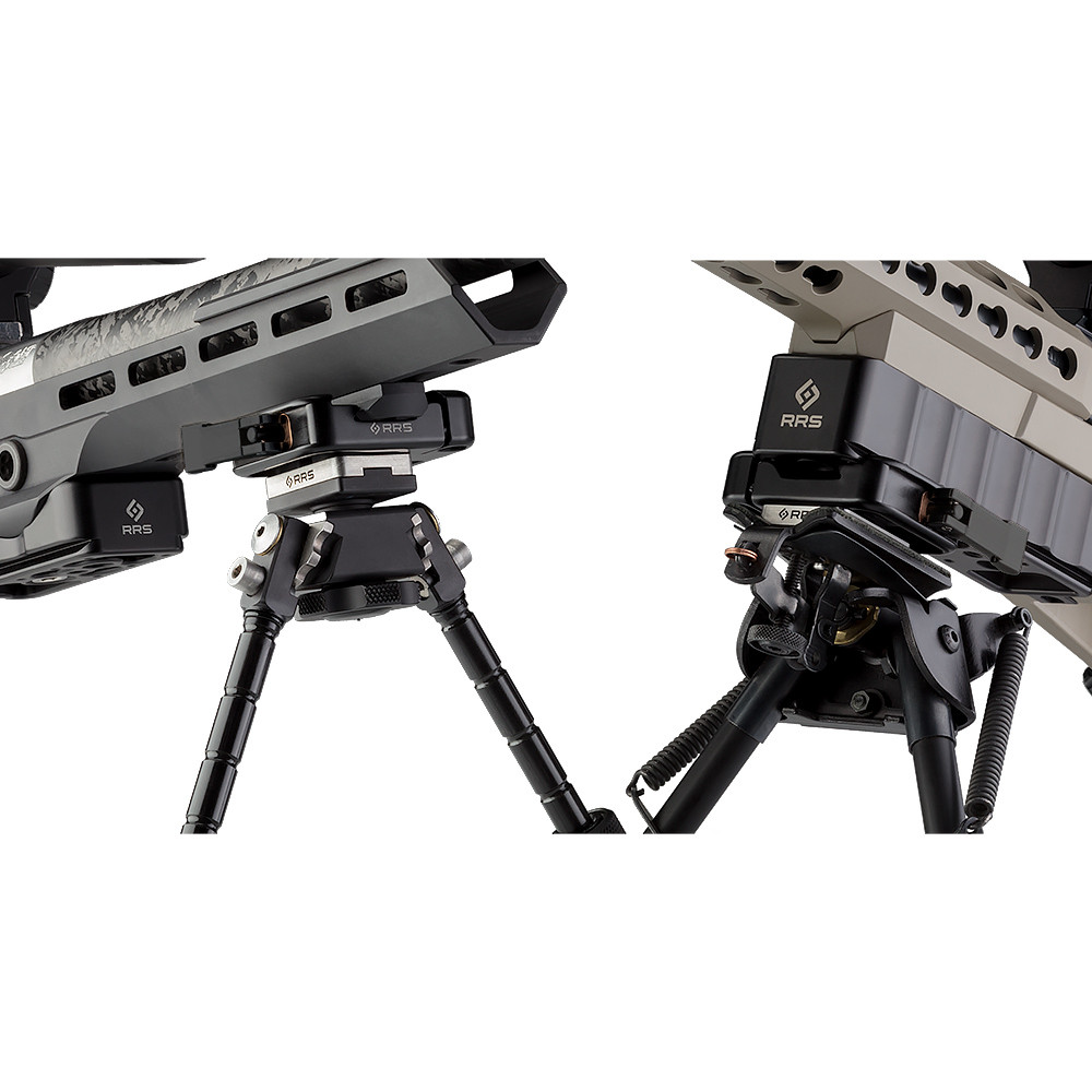

RRS - no you do not need a ball head with the leveling base if you configure it with the QR. Another very slick option as mentioned by MPHReallyRightStuff is the Anvil30 with integrated Apex. It combines leveling head performance with near ball head articulation. It has two other very nice bi-products, super compact and dual mounting on either the 1.5” dovetail or a pic rail.
If your rifle can take a full length rail like the 419, HRD-Gear rails paired with the new RRS bipod adapters you end up with a crazy solid and flexible system. Again mentioned and shown thumbnails in Mike's post.

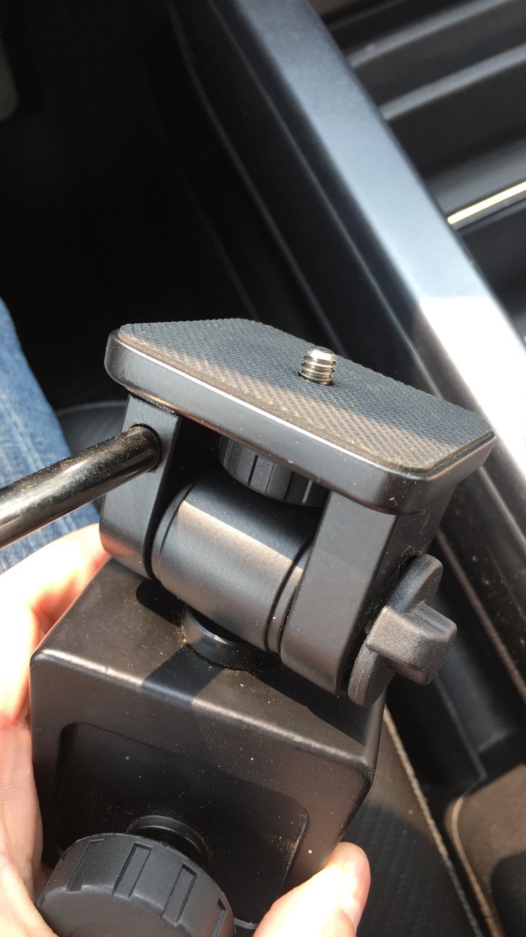

This is the window mount. The Skyline tripod I'm not too impressed with the head on it so I want a new head anyways (Likely new tripod too). So is there a clamp that would screw onto this window mount, then I could just use a Std. 1.5" Dovetail bracket on both my camera and spotter?

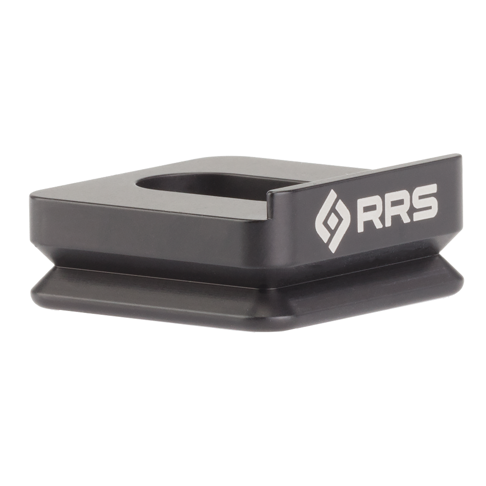

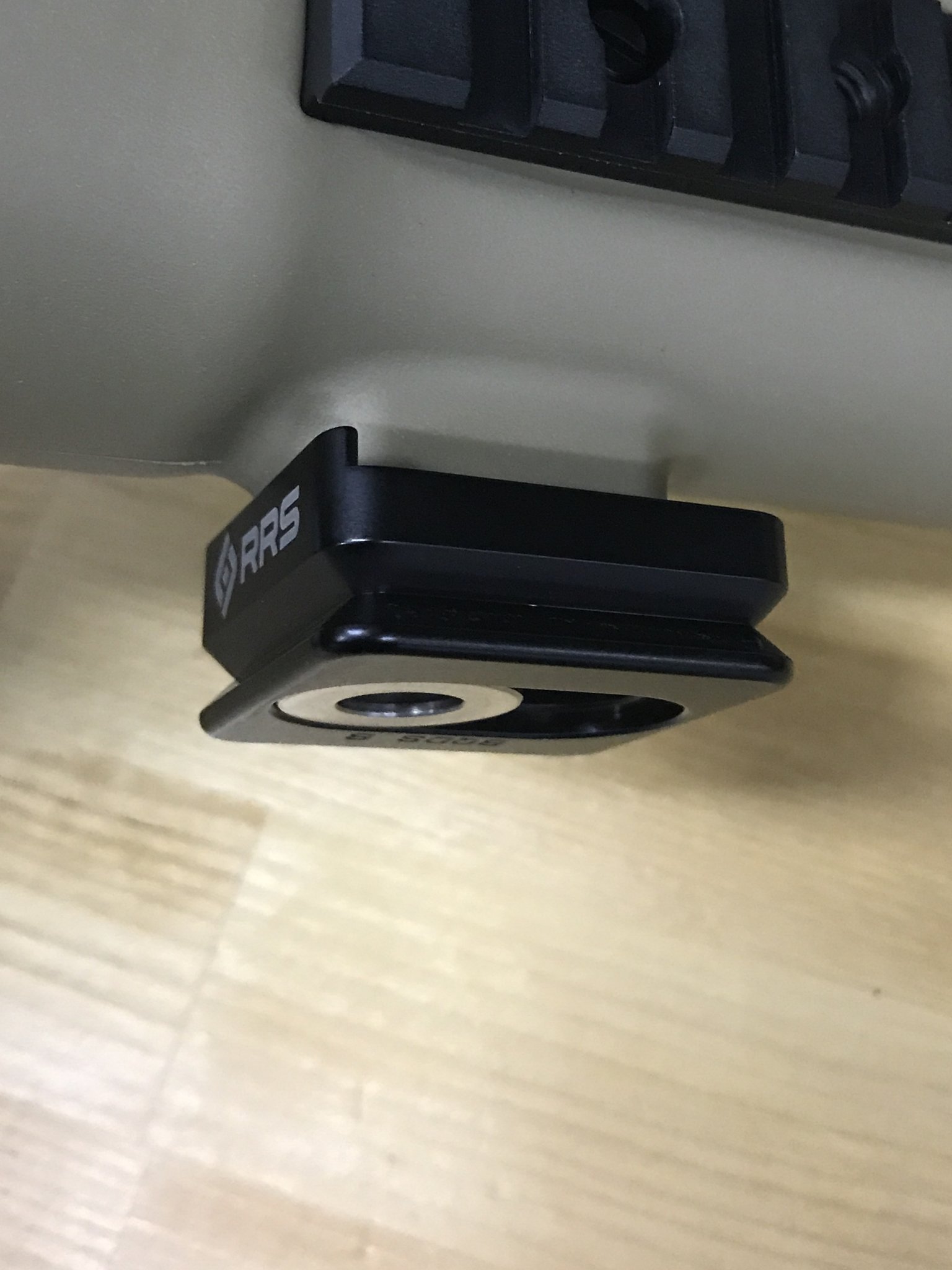

Oh thats easy, just add the QR plate (this is the coolest new offering from RRS but overkill) to connect your mount to a plate like mrtoyz showed. Note that the shelf on the BQDS helps keep the spotter from twisting loose, but you need a raised area or edge close to the 1/4-20 mounting hole on your spotter.
If you need to skimp anywhere skim on this window mount... But your life will change with an RRS shooting setup -- will work for your spotter and PLRF too.
Here is a cheepo solution for the window mount a small, light screw knob QR plate for $16
Reactions: Stpilot12

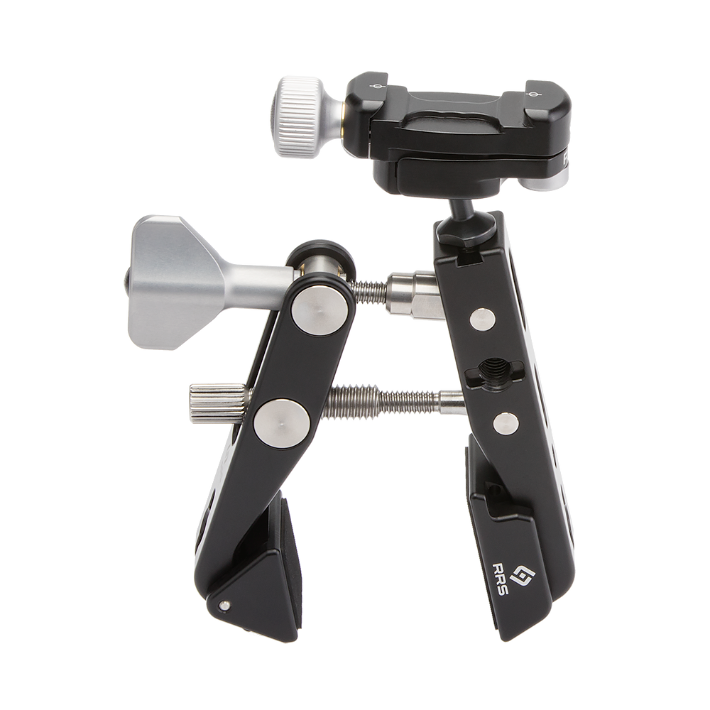

I use this for a window mount/multi-purpose mount. Thanks for the plug diver!
