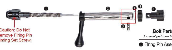

    HOWEVER, as is typically the fashion, I solved this particular problem I was having with the bolt hanging up after finally giving up and posting here about it.
    The bolt head pin hole on the bolt's fluted/SS section was very sharp and had no radius to it, and I was correct that this was what was hanging up on the round below the round being fed. Like a dumbass I never looked at the other Bergara Premier action (LA 300WM) that I owned, and the bolt head pin hole on that bolt was very clearly radiused/chamfered from the factory.
    I disassembled the 308 bolt, and took a very fine round file and knocked down the sharp edge of the bolt head pin hole in the area it was contacting the round, reassembled, and it runs perfect and smooth now with no hangups.
    My guess is, either this bolt somehow missed the radiusing step for that hole at the factory, or they started doing this process later on (since I believe this is 2018 or earlier build rifle and my 300WM is 2018 or 2019). I might call Bergara anyway, but since they wouldn't do anything other than knock down that edge the way I did, I consider this particular issue resolved.
    EDIT: Attached a picture of the hole in question in case anyone needs to reference. I only knocked down the edge of the hole on the bottom that contacts the round, even though the 300WM bolt had a full radius around the holes on both sides of the bolt.

    I did order the MDT mags without the binder plate so I could load longer to get closer to the lands (since I measured the lands at about 2.98, but I won't be able to load longer than 2.96 even with the no binder plate mags). I already took the feed ramp down a good 0.10"+ so I hopefully won't have any issues with the binder plate-less mags, and if I do I can just hit it with the sanding drum a little more as needed to open the clearance so more.

    Ironically I would have expected to have more issues with the PMAGS on my 6.5 than my 308. Also, if you read my more recent posts above, I narrowed the issue to the bolt itself, and was able to completely correct the problem with some light filing/radiusing of the bolt head pin hole. My 300WM Bergara Premier action already came from the factory with those holes relieved, so I'm not sure why this one shipped with sharp edges in those spots, but it's fixed now at least.
