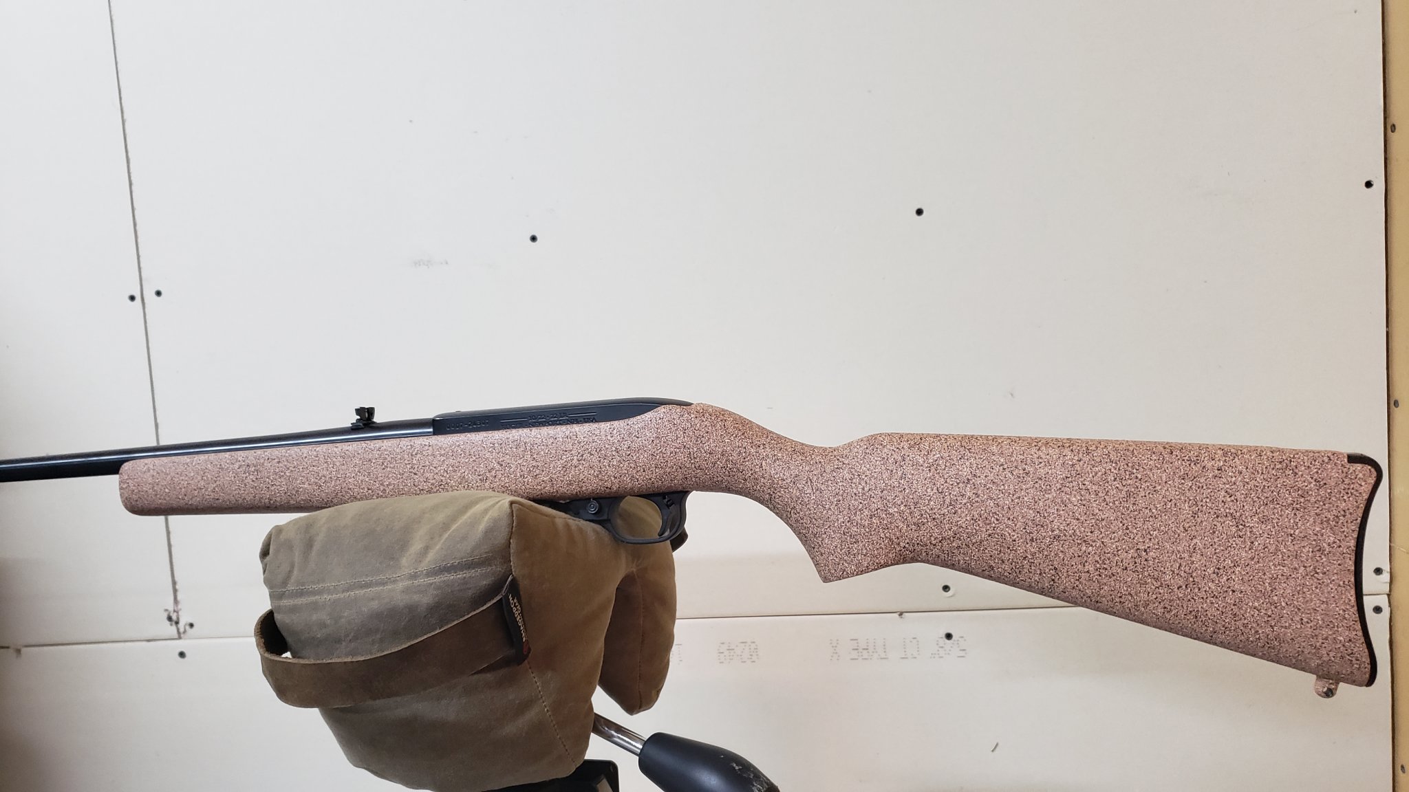

Had a shitball 10/22 that i didn't mind ruining so I experimented with some paint jobs. Ended up keeping the "stone texture" as it like looked cool/ felt good .. haven't seen anyone else use the Rust-Oleum "stone accent " paint so I thought I'd post .. only suggestion I have is to use a few primer and a clear coat, plenty of grit on the paint, the clear coat makes sure the "grit" or grip doesn't rub off.. here's the paint
Here's the rifle

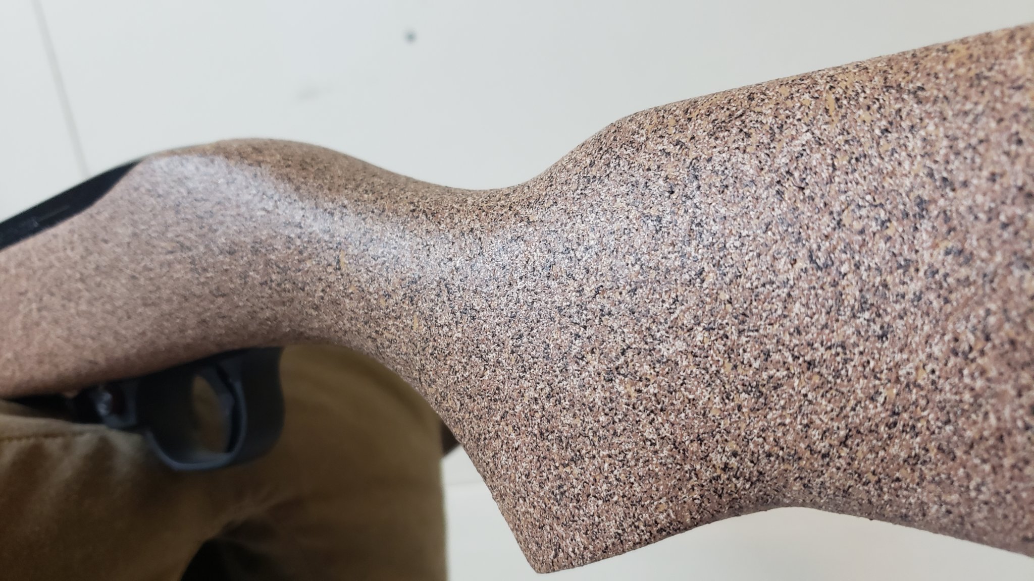

Here's a close up of the paint job

Very cool, I have been eyeballing that kind of paint and wondering how it would work out on a rifle. Looks good.
Feels good , lots of texture left . Feels like a really fine grit sand paper after you sanded some soft wood. Not "rough" on your cheek but just rough enough to get some grip.
Clear coats are key, the "grit" tended to fall off until a couple clear coats and a long ass drying time (around 3 days)
