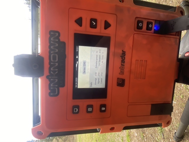

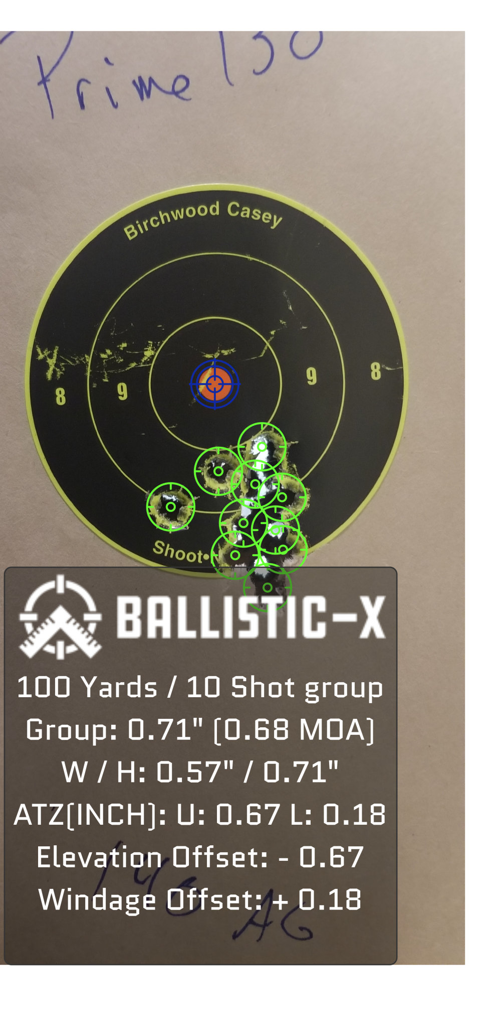

    Shot 260 rds of Prime since the lock down and it is the worst ammo i have ever shot out of my rifle. It is all over the place very inconsistent? I thought it might be something wrong with my rifle but I switched to the bulk pack of hornady AG that i always keep with me and had no problem hitting steel out to 950yds. Switch back to prime and cant hit a target if my life depended on it? Anyone else having issues? So far Ive shot multiple distance from 600-1125 and no luck being consistent at any distance. 130 FGM Bergers/140 ELD all excellent results and even 140 Agunners is surprisingly consistent out to 950, Barrel is standard 1-8 twist 24" hawkhill/PVA
    UPDATE: see post #39 Prime does not like to be shot with other bullet fouling in my barrel. Even though other bullets held steady after shooting another brand. When I switched back to prime, groups would horrendously open up. If I clean the barrel and exclusively shoot prime all is well

    Whats velocity and ES? What does it look like on paper at 100?

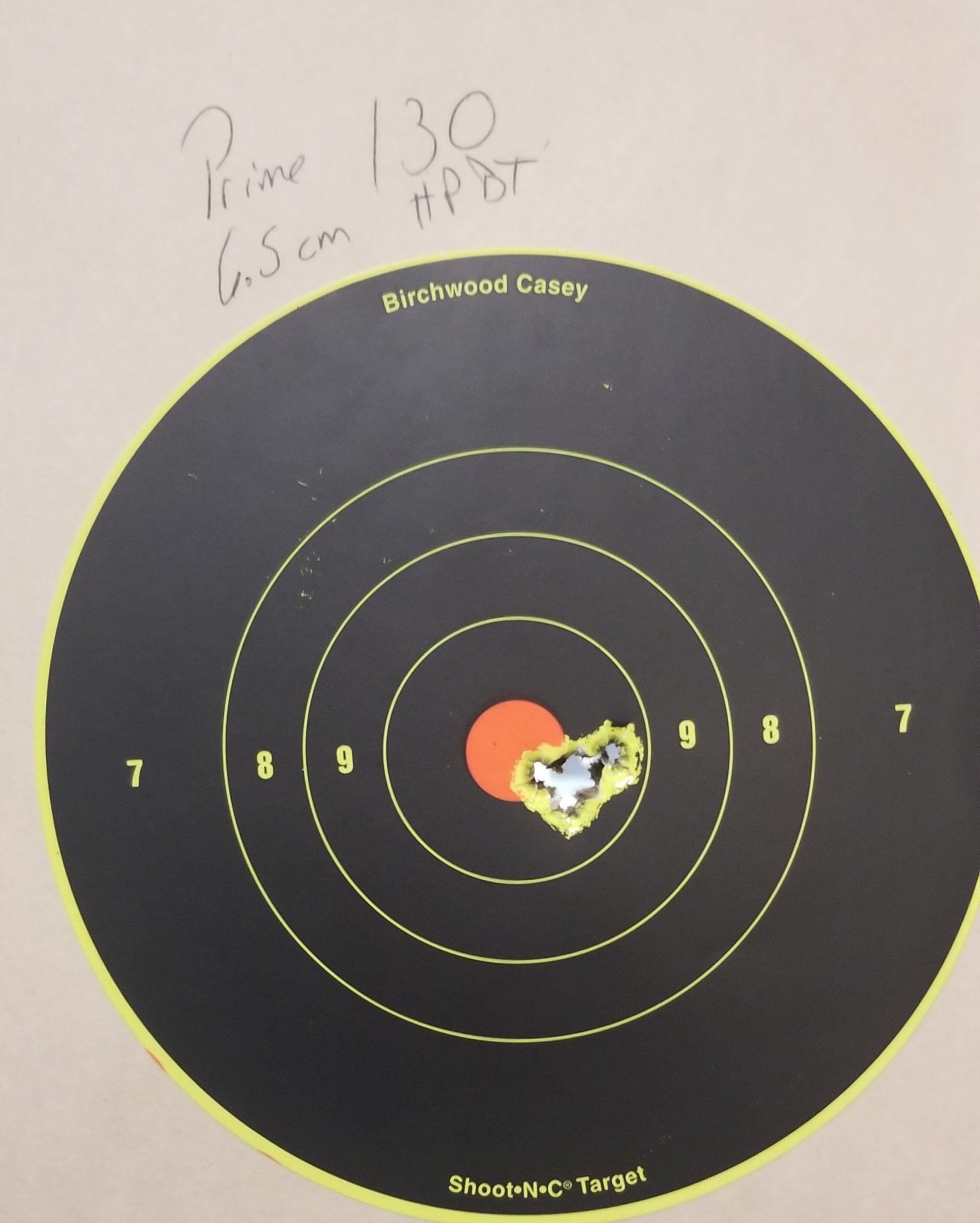

    I had a Tikka that absolutely loved it. Then followed by a Rock Creek chambered for Prime on a TL3 that hated it. My AT/AX also hated it as well, not as bad as the TL3 but in the same ballpark.

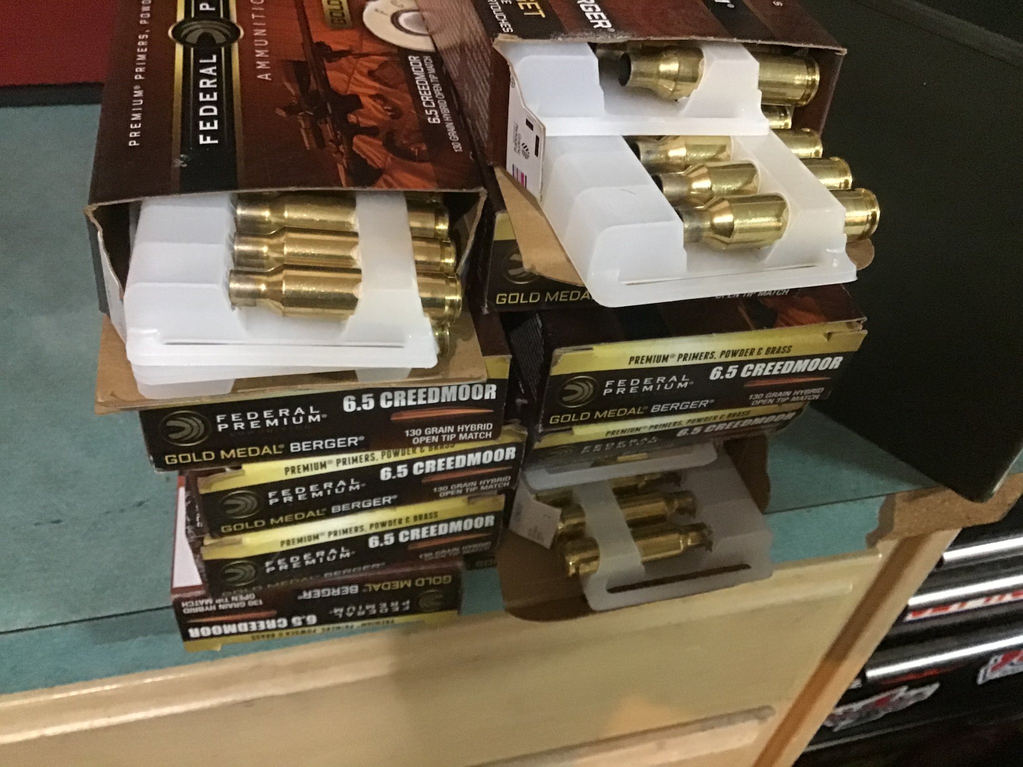

    The best mass produced factory ammo I have found is Berger’s offerings.

    Prime has been treating me well in 2 different PVA barrels. For what it is worth, these same barrels do not enjoy the 120gr bergers as much.
    Both zero'ing @ 100 yds:
    5 x shots with Prime 130s out of a PVA 16.5in 6.5 bbl
    10 x shots with Prime 130s out of a PVA 22in 6.5 bbl:
    Forgot to add:
    22in bbl = FPS/SD/ES = 2782/18.2/48
    16.5in bbl = FPS/SD/ES = 2601/14.6/15

    Didn’t shoot for groups. Zeroed and got some quick chrono numbers it’s shot slow. Real slow but I’m shooting a Tikka TAC A1 which is just...well, SLOW!
    2650fps. SD10 ES20
    I walked it out confirming drop 100-1000 wknd was 5-7mph. Drop was within 1/10 of what ballistics spit out
