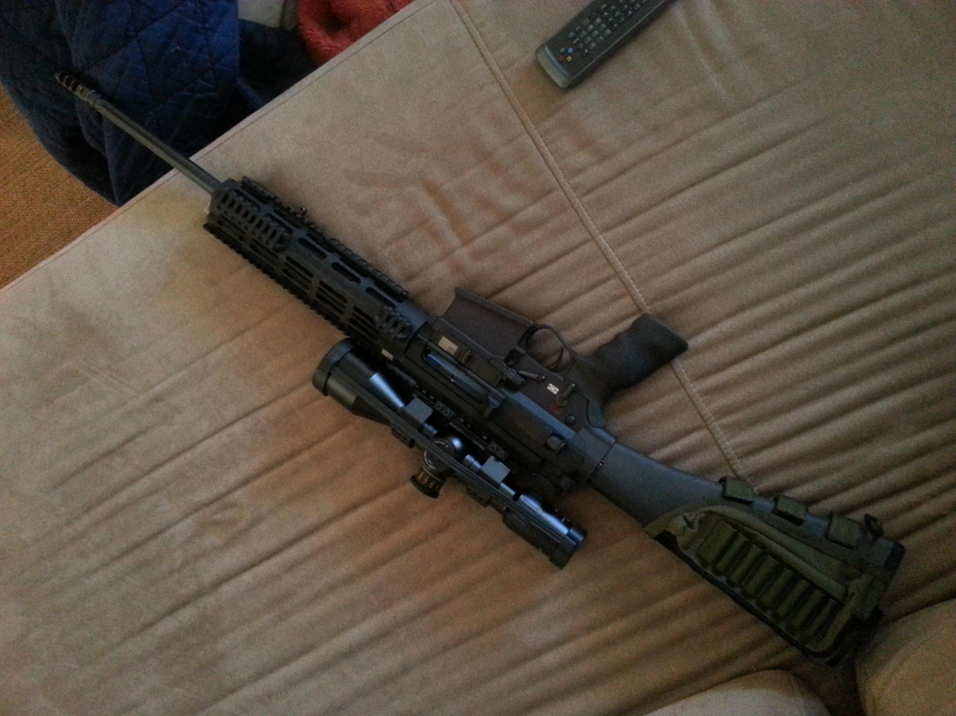

You have pics?
Heres my POF P308, Badger riser, Seekins 0.92" low with a Hensoldt 3-12.
A2 stock just like yours with a Tac Ops pack get it lined up for great cheek weld.
Not the best pic but enough to get the idea.
As far as cosmetics, doesn't look bad at all to me. I've got each ring mounted 1 slot from each end. You could always take it to the very end and it actually would look like a 1-piece mount.

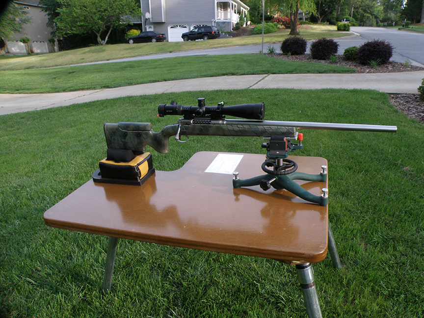

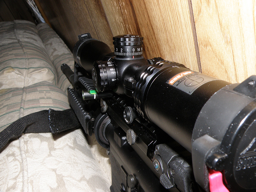

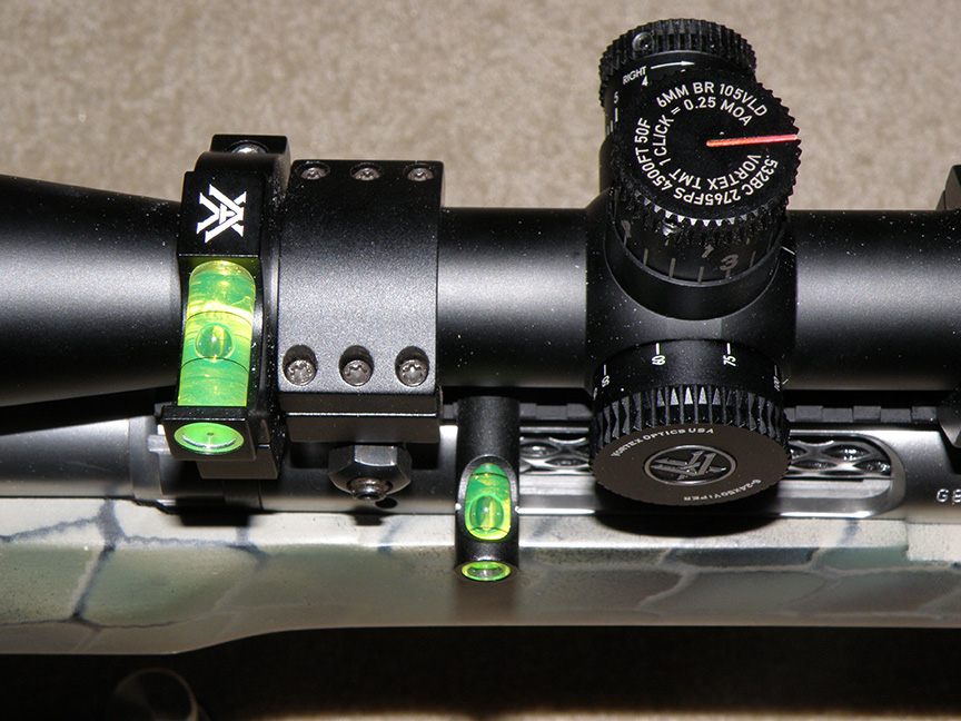

I must be missing something. I guess you need the 20 MOA rail for shooting out to 1,000 yds. Why do you have to have the scope so low that you don't have a correct cheek weld. If you are worried about canting the rifle because the scope would be high above the bore why not put an offset bubble level on your scope. This way you can control the can't and have a correct cheek weld looking through the center of the scope lens. I shoot in competition at 1,000 yds and always use the bubble even with my bolt gun which has a 20 MOA rail and the scope very close to the barrel. The scope is a Vortex PST 6-24x50mm MOA FFP. I shoot a 6mm Norma BR. with 105 VLDs and it needs 108 MOA clicks to get me to the center of the target. Even though I am very close to the bore I still need the offset bubble to keep the reticule vertical.
Here are pictures of my long range hunting rifle and my M4 with a Bushnell AR/223 scope 4.5-18x40mm scope on top. Both have bubbles. The M4 has a B-Square bubble on the rail under the scope just behind the front scope ring. I can watch the bubbles while aiming the scope.
PS: I removed the lower bubble after the picture was taken in picture # 4.

Here is with the Badger mount in 34mm, they make 30mm inserts and I use them on the NFs. This is their 20 moa.
What is your eye relief on that? MY scope has to sit about 1 to 2" forward of the CH to get a good picture. Making the farthest I can set my rings about 1" pas the receiver. Or else I would have just ran Med/Low rings till I could get a 20MOA base.
I just got off of the phone with ADM about seeing if they would take special orders and maybe have one made and the CS guy actually told me they don't do special orders but liked the idea and their design team was actually looking at and working on a few new mounts. He took the info I was looking for and said he would pass that to his design team and they may look into offering the ADM Recon in the specs I needed or close to it for guys running the high rail and standard stocks.
So since I've been posting his on here and 2 other forums other guys running standard AR configured stocks ie carbine/CTR or A2 style and don't prefer the adjustable cheek risers or PRS type stocks they might be the first to offer a QD Recon 30mm mount running a 2" extension, 20 MOA base at or around 1.25 to 1.30 in the bear future so guys won't HAVE to run the Badger 22MOA rail and seekings low ring set up to get the same scope centerline with a 20moa option and not be on the rail.
So if anyone is interested in that keep an eye out for ADM. I'll be emailing them in about 2 weeks to give them the specs and measurements I was interested in to send to their design team for the possible new mount.
That's interesting. ADM is certainly one of the better companies in terms of the depth of their product line and adding additional options like what you are talking about sounds like a win for them on many levels as you are clearly not the only shooter asking for lower mounting options or they wouldn't have given you the time of day. Good luck and be sure to post an update once you have any addt'l info.
Eye relief is perfect with the USO. I can run it about 3/4 of an inch forward from where it currently is. Several people have shot this gun and none have complained of eye relief but the eye box is very forgiving with the USO's.
Final part for my LR308 build.... Scope mount...
I have a little bit of a dilemma, big one actually. So I have to either choose, a good cheek weld, or bad eye relief
or run my optic mount on my non monolithic rail..... :facepalm:
I've decided on a ADM mount. Only because they are the only company with a scope mount option of a 30mm
tube diamiter, 20MOA mount and a scope center line option below 1.50".
So the AD-Recon-SL which is 1.110" scope center line.
Pros: Perfect cheek weld, Low scope profile
Cons: No scope off set so eye relief will be tight, or I will have to mount .600 of mount on my free float
Scope clearance, mount will be 2 teeth onto rail to keep eye relief.
Or the
So the AD-Recon-SW which is 1.470" scope center line.
Pros: .600 offset to allow more eye relief and be on the receiver not the rail
Cons: Huge scope height and horrid cheek weld.
Reason I need a 1 piece mount is for the 20MOA base. Or else I would go standard rings.
